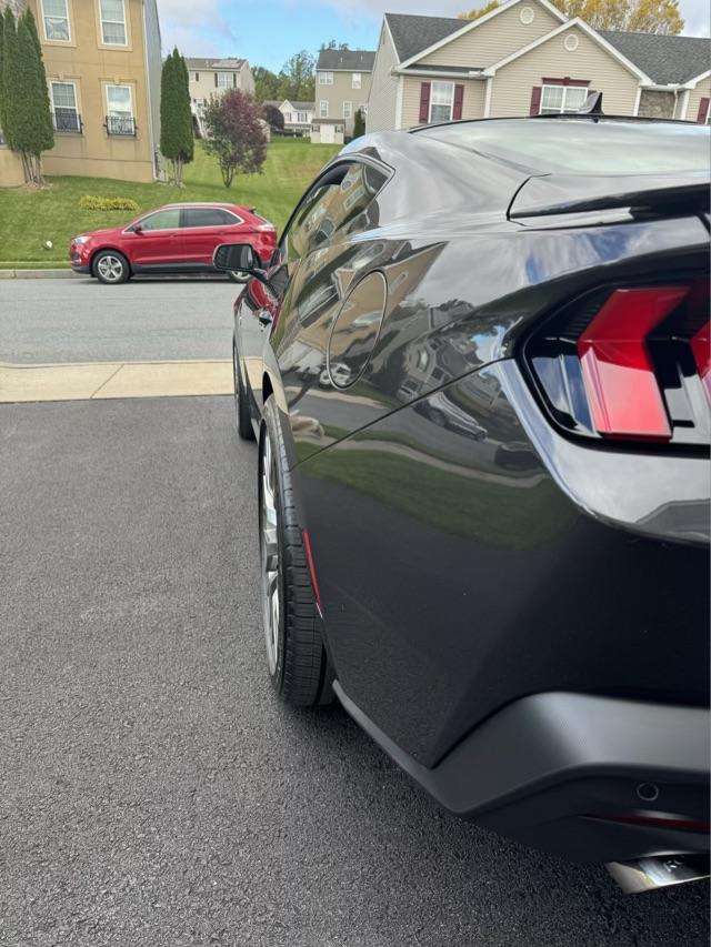

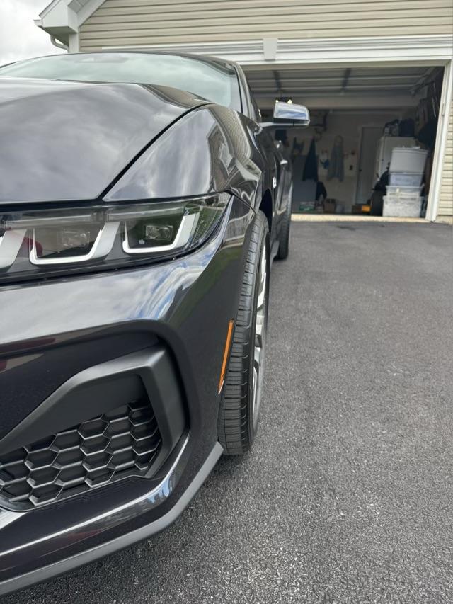

I put on 20mm Steeda spacers and it looks perfect to me. Bought from CJ Pony Parts as I only live 45 miles from them. I'll take some pictures tomorrow.

I did not cut anything. Bolted right up and smooth as before they were installed.

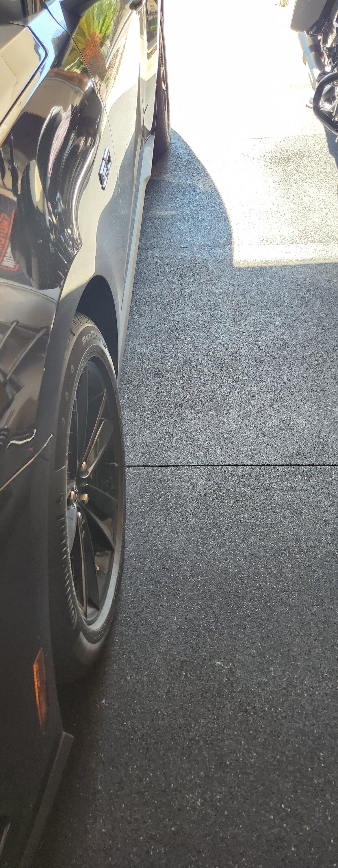

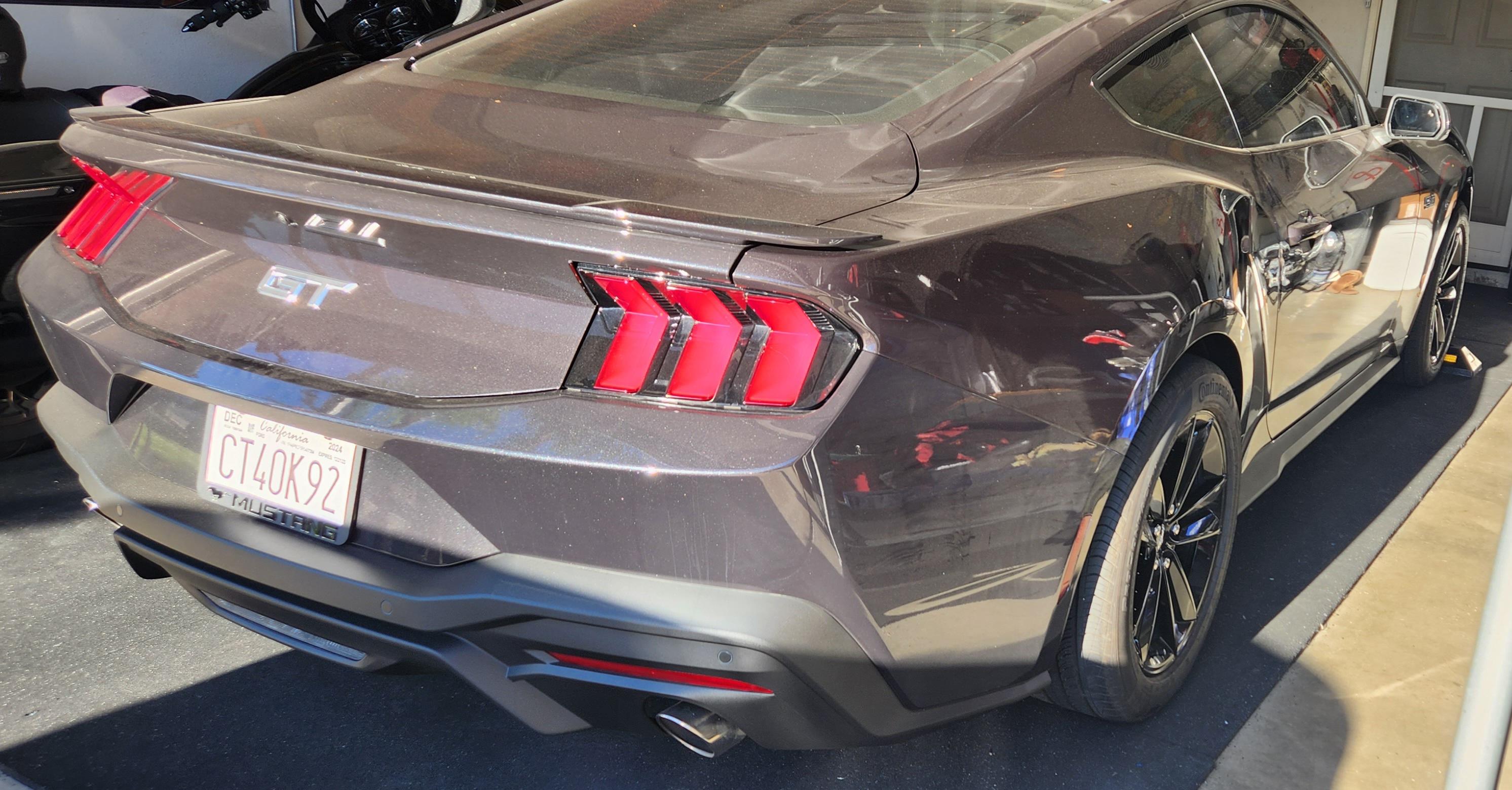

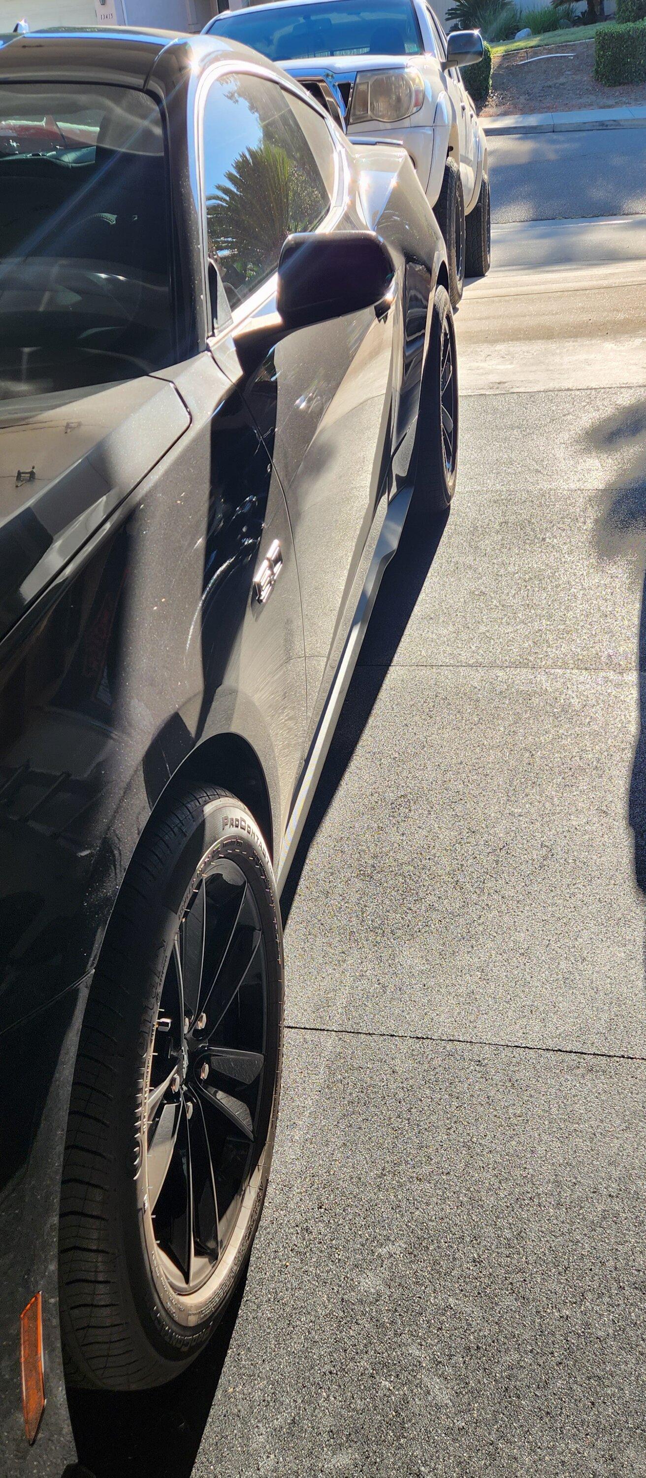

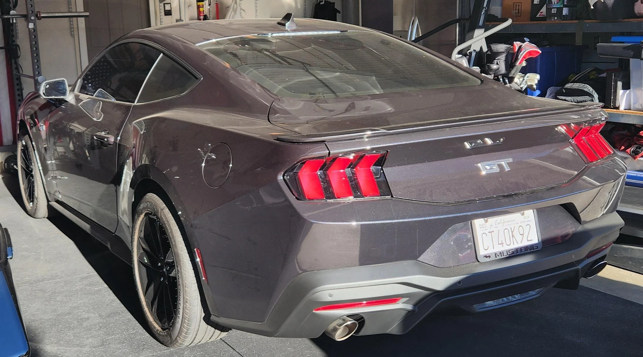

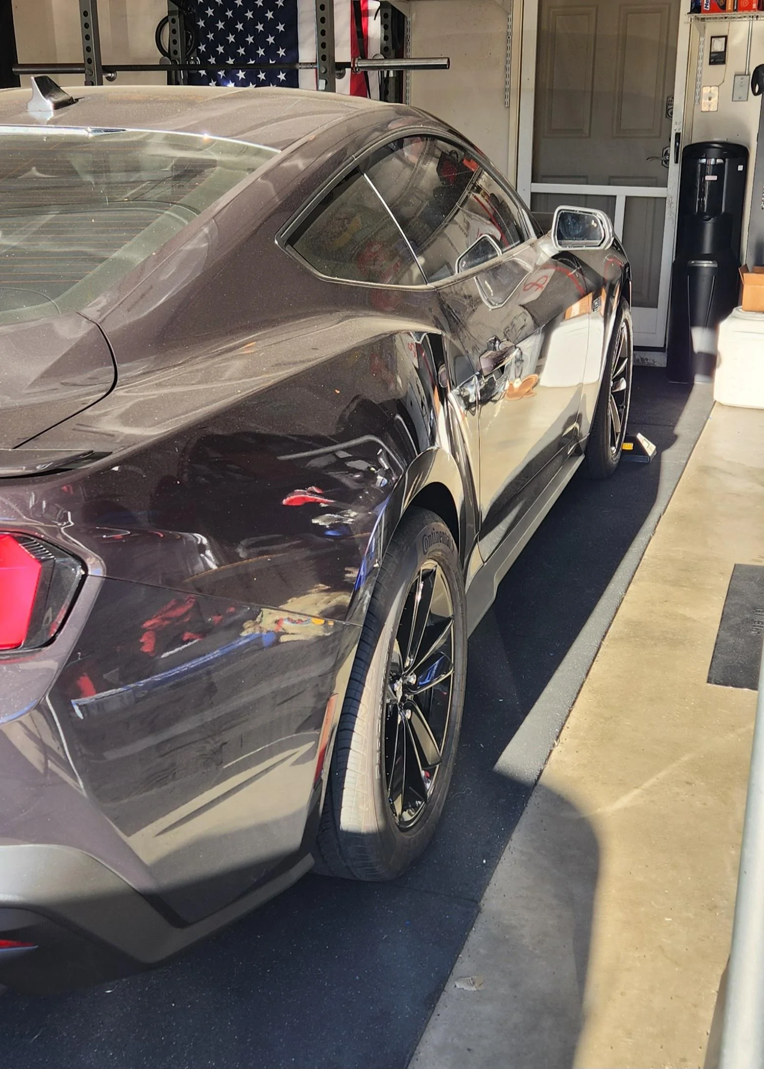

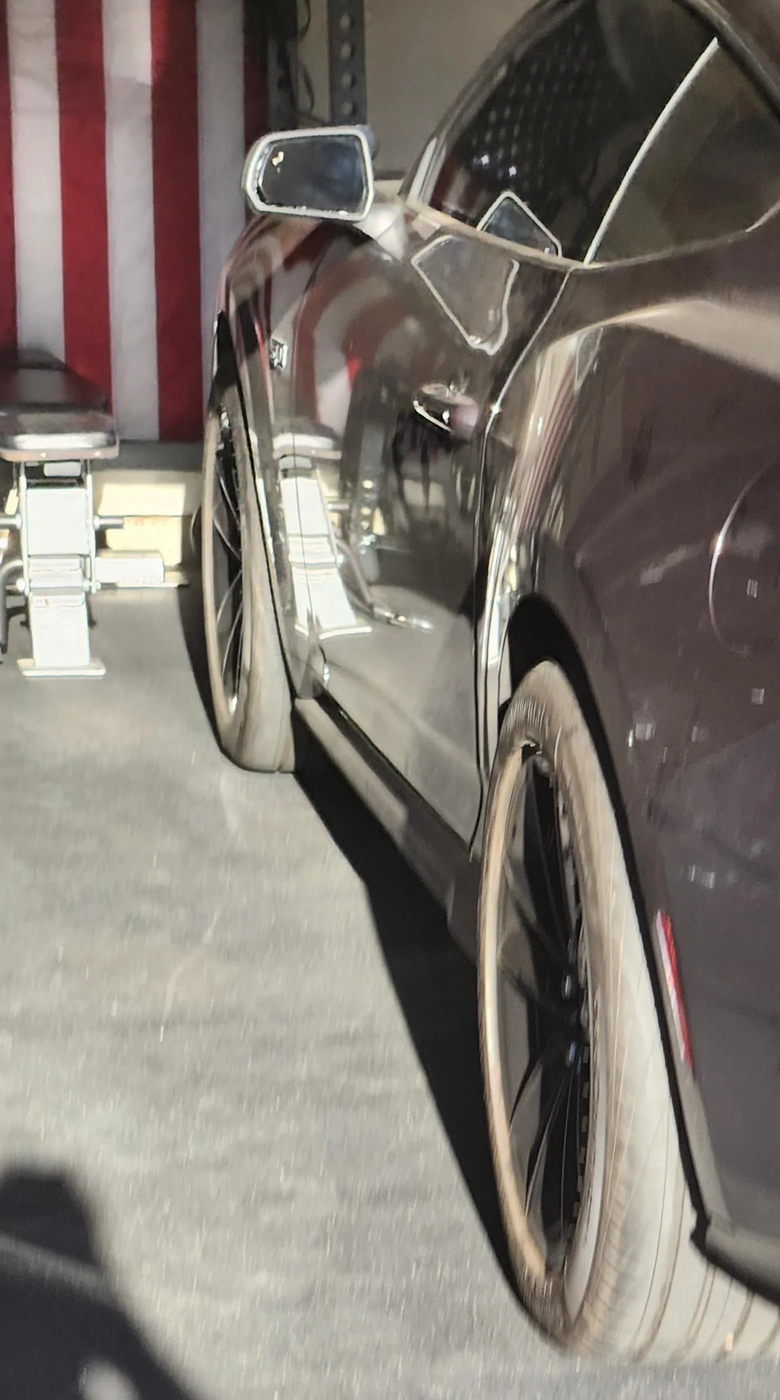

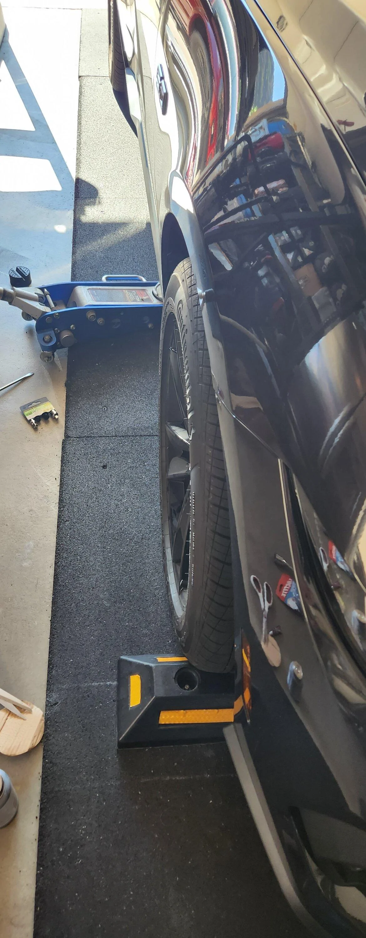

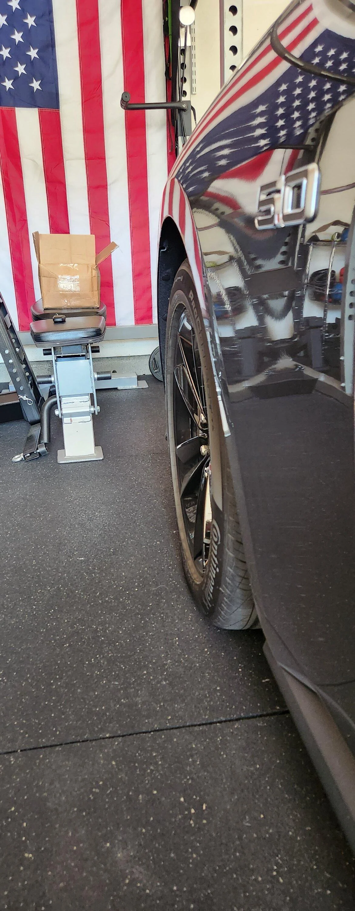

Steeda 1" spacers on all 4 wheels / stock springs.
Last 2 pics are "before"
No rubbing, but I'll follow up after driving a little more.

Tighter shots with the Steeda 20mm spacers…
