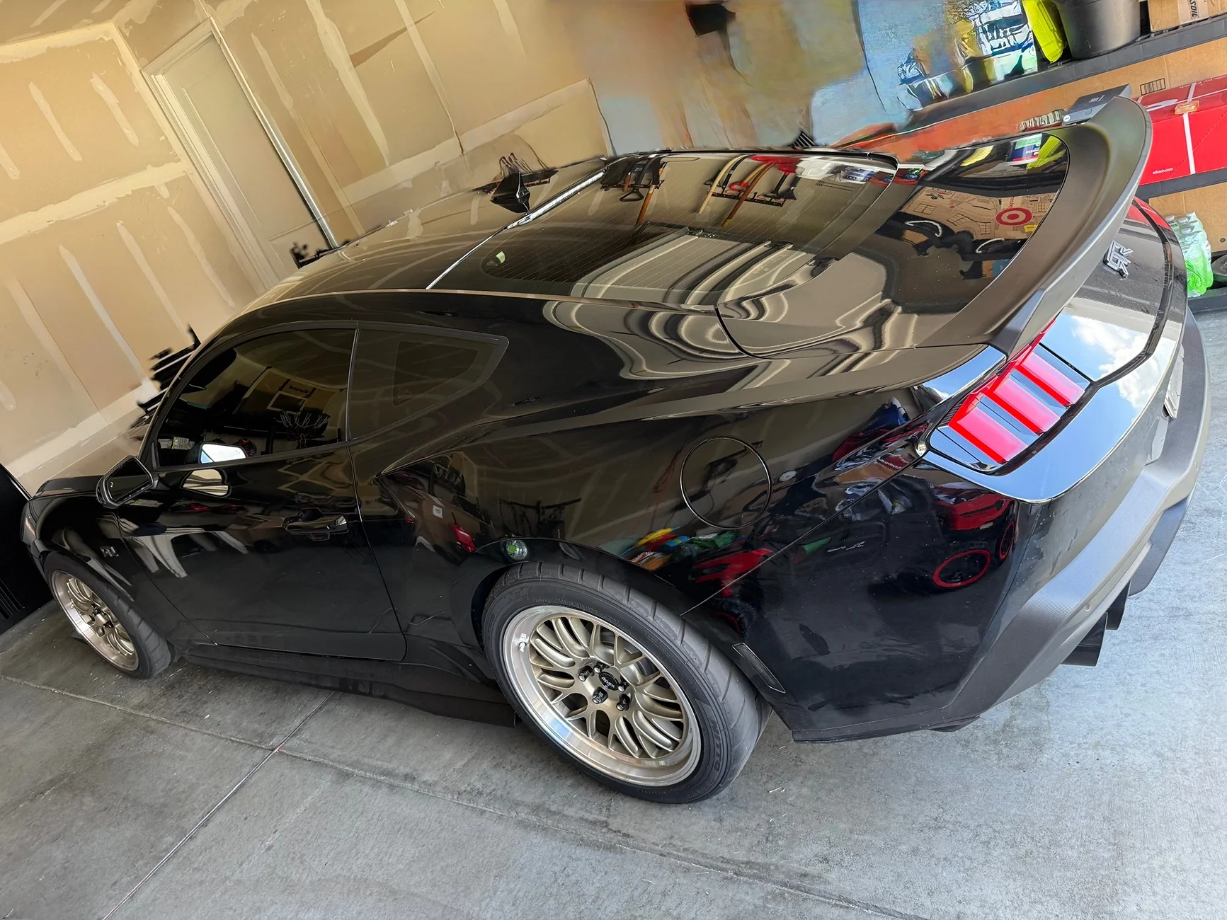

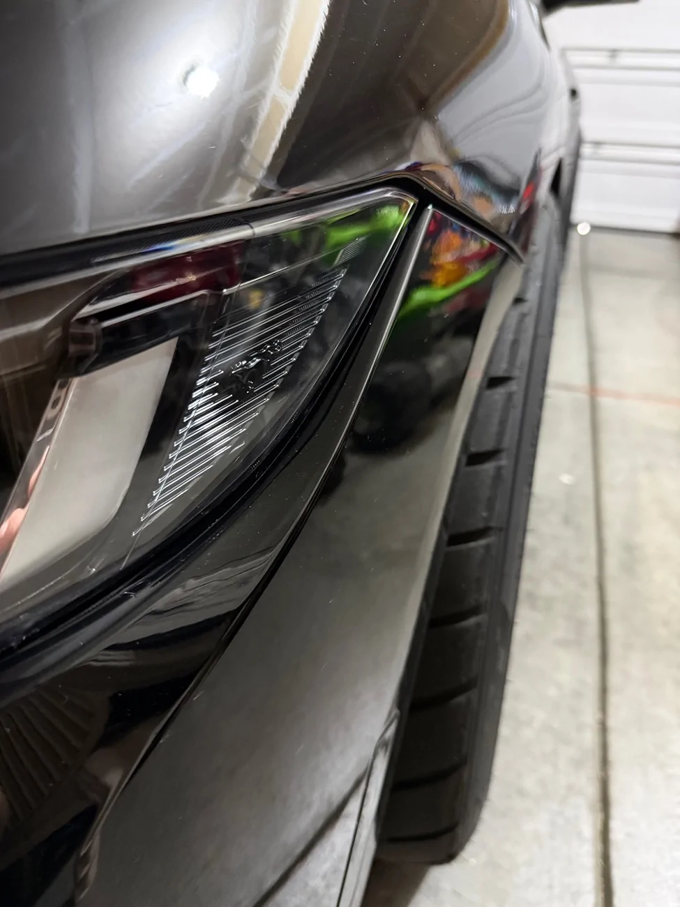

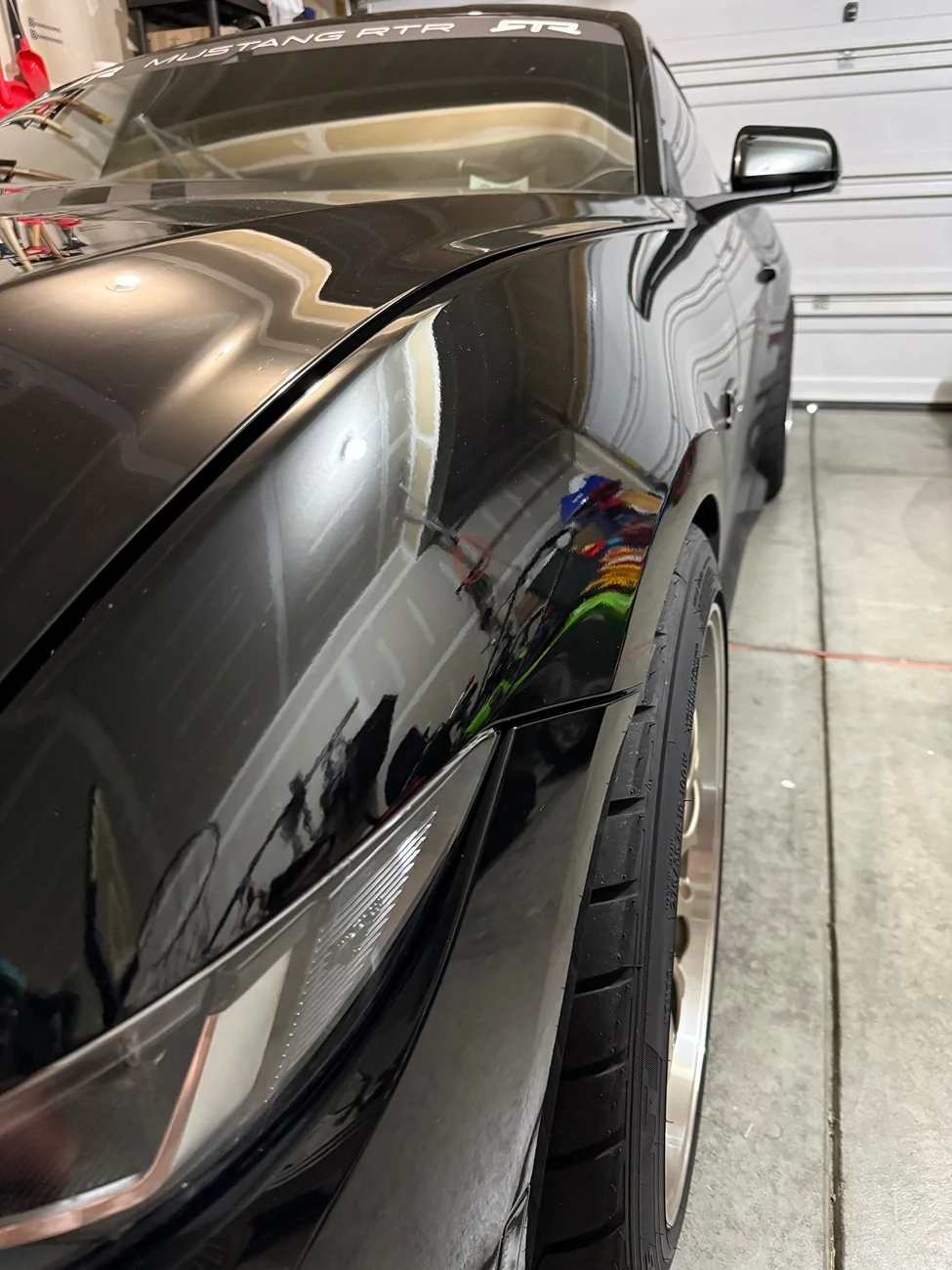

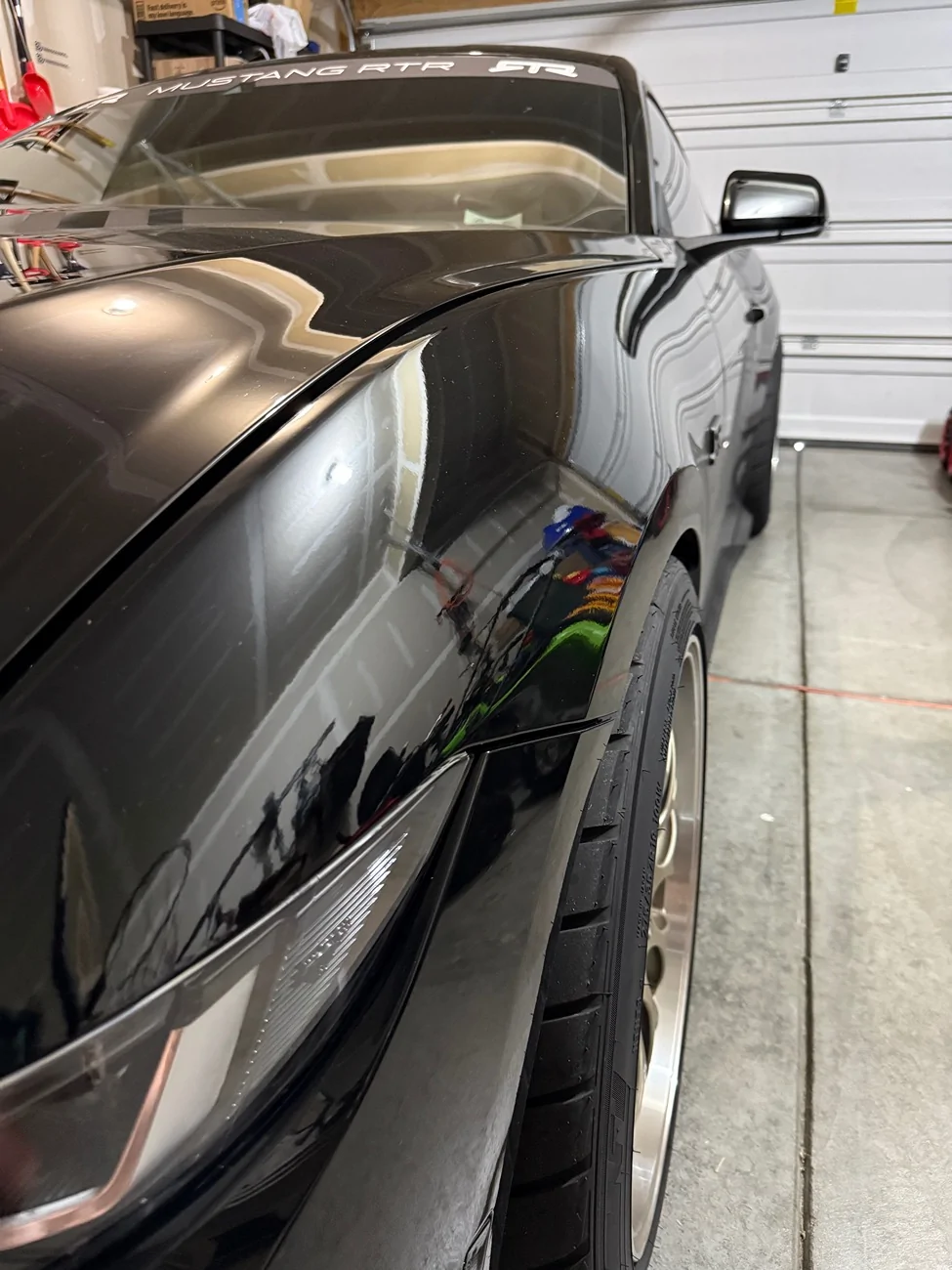

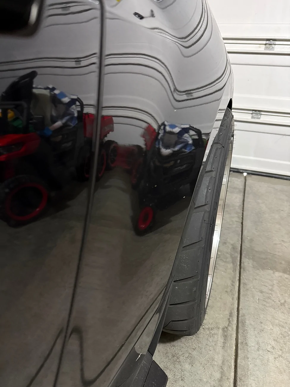

Here’s my setup
F: 19x10 et 40 275/35
R: 19x11 et 52 305/35
I’m running the RTR tactical suspension that came on my spec 2 RTR.
I did not like this look so I added a 30 mm spacer to the front and a 20 mm spacer in the rear. I now have a little poke at all 4 corners with no rubbing or scrubbing.
