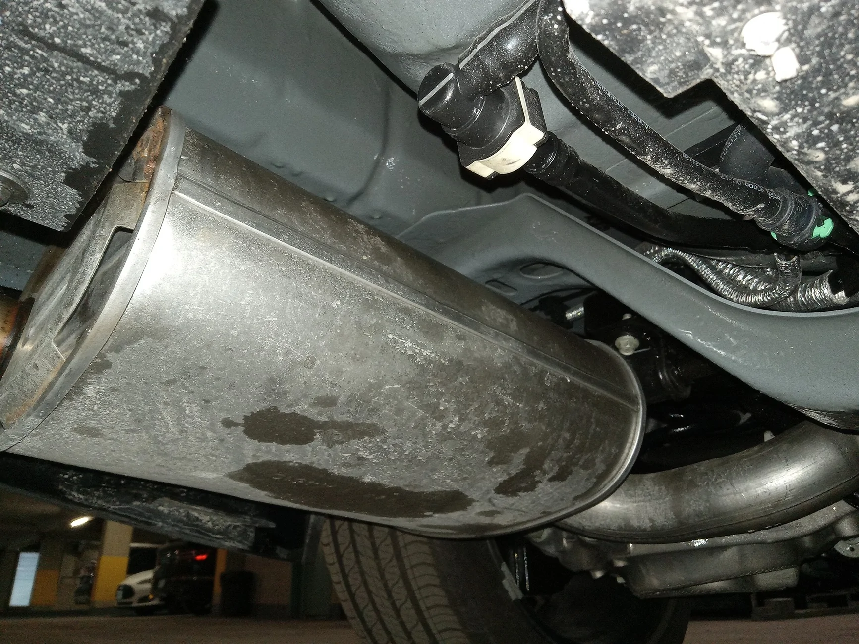

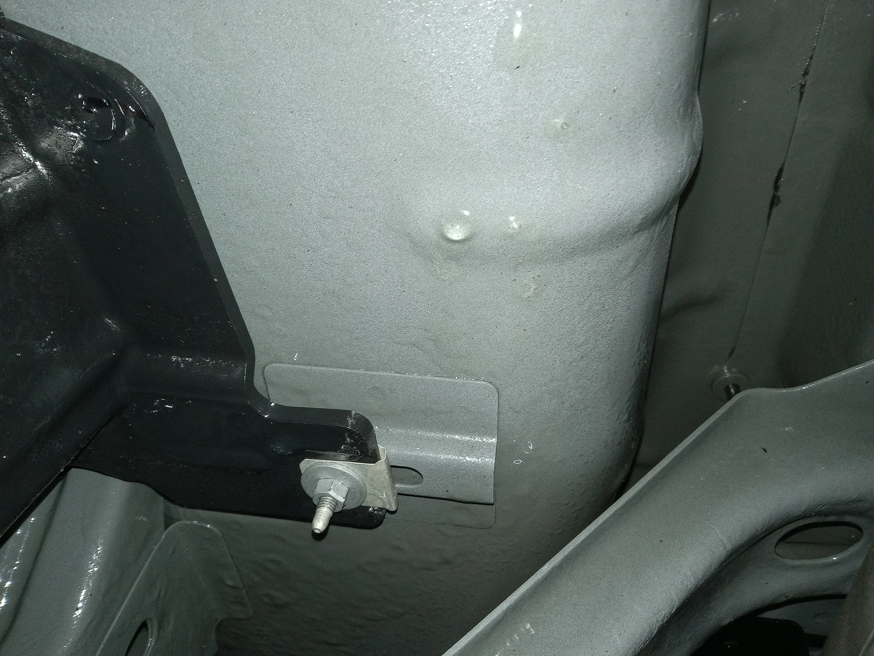

I have had my vehicles, going on 30 years now, sprayed with a clear oil. The product is now called Corrosion Free. I still know the owners of most of the cars I sold as they are family and friends who want a car from a truly ocd guy (that's me). No rust on them anywhere. I'll try to attach some pics of the underside on my 2024 GT Convertible. I plan to do the same for the 2026 GT Convertible I have ordered. These pictures were taken after my drive home. The treatment costs about $100.00 It will last two or three years if fair weather driven but I touch it up every year anyway with aerosol cans you can buy and get it redone every third year. For winter driven vehicles I get it done every year. Stops dripping after a few hours will not in any way attack plastics, sound proofing caulking, bushings etc. It is basically just a light oil spray.
