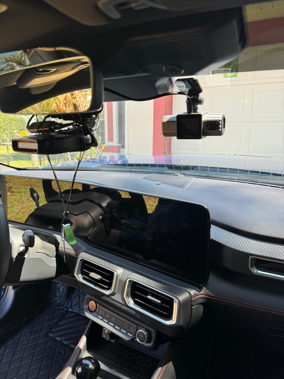

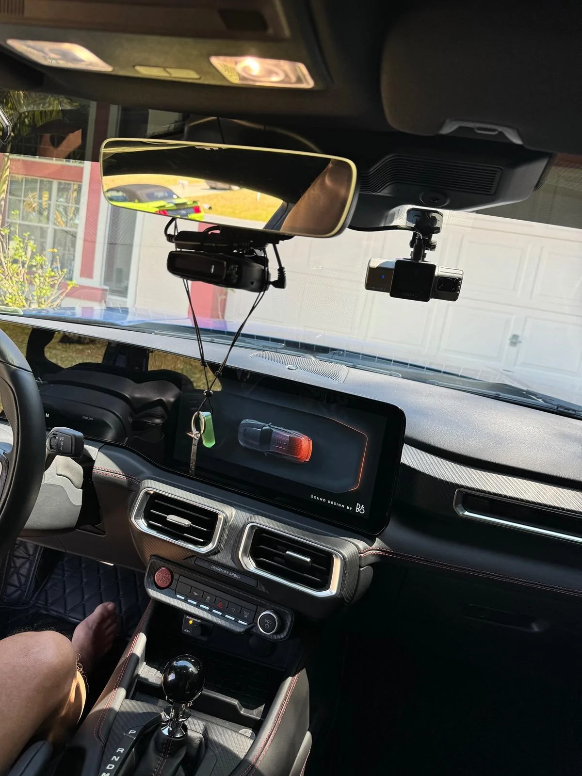

The USB in the mirror is a huge plus! Bought a splitter to plug in radar detector and dash cam. Very clean and a lot less work than the S550 where I had to wire tap the mirror for the radar and run my cable for the dash cam all the way down to the ODB plug.

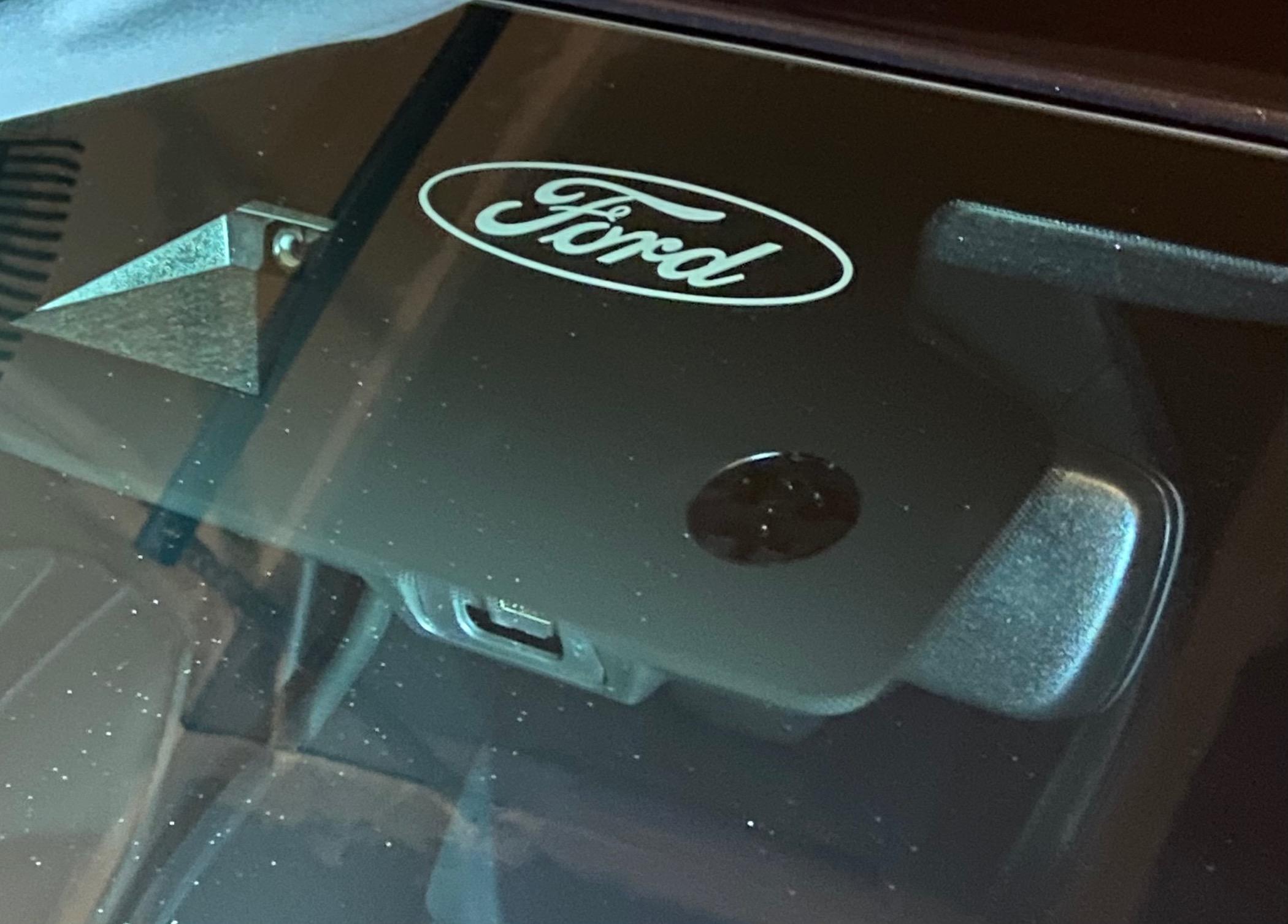

How does this work?? I had no idea they had them. Also, my EB base model has two screens and not one big one… is that a GT or Darkhorse only thing?

Not all models have a USB in the mirror, just like not all models have the single, large screen. The car has to be optioned to have those features.

Oh okay. Where is the USB port on yours so I can look to see if mine has one?

I just took the photo standing outside of the car, looking through the windshield

I have a base model. I routed my dashcam cable under the trim on the side of my windshield.
Basically cigarette lighter cable straight to the windshield, then around the windshield (you can just tuck it under the plastic going around the windshield) and up the passenger side trim. It doesn’t obstruct the vision. And you can just tuck the cable under the plastic trim. It’s solid, doesn’t move anywhere. But not as nice as the mirror USB plug.
