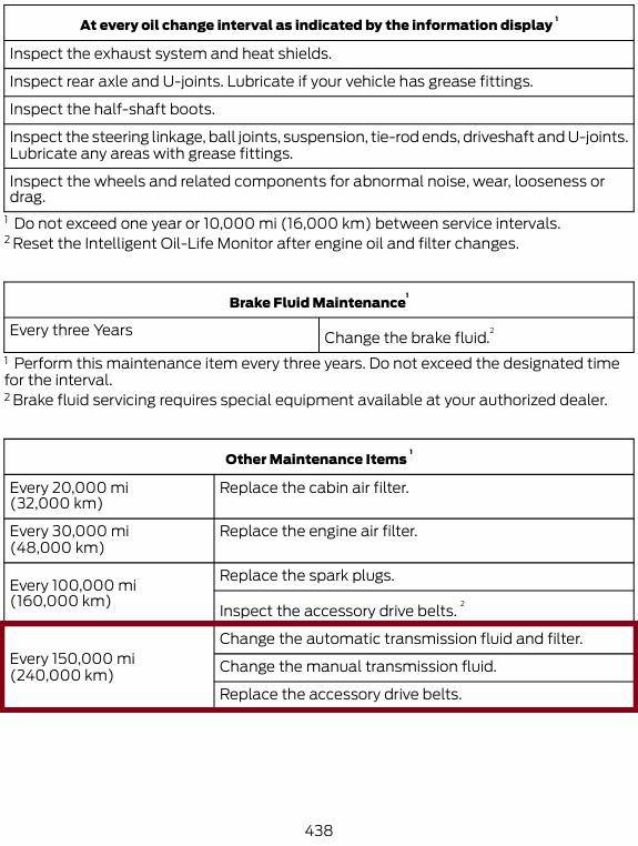

I am obviously not buying into any "lifetime fluid nonsense" and I own a 2025 GT, 10 speed automatic which I like. Had I wanted a six speed, I would have ordered one. Everyone has their preference for their own reasons. Also, on Page 438 in the 2025 GT owner's manual there is nothing about an automatic transmission but thanks anyway.
That said, back to the original question: " What are other's doing to keep good fluid in their 10 speed automatic transmissions? Additionally, how are other's changing out their transmission fluid? Thanks, FD

@Frogdog1 ...... you could google it to see location. I believe it was a plastic cap on the passenger side of the transmission housing UNDER the car on my 2014. I see where RLE55 has posted the interval of 150K miles. As I said, when I changed the tranny oil on my 2014 after 8 years it still looked awesome so I don't dispute the 150K Ford claim. BUT - I will change my 2024s at four or five years (I'm ocd about maintenance) even though the mileage won't be anywhere near 150K miles. I don't mind spending the money.

Thanks RLE55, we aren't looking at the same manual apparently.
And, MAT1955, no way my transmission fluid is going 150,000 miles. This is, strangely, the only manual I've seen to change brake fluid every 3 years though, except for motorcycles and that does make a big difference when DOT 4 is required.
