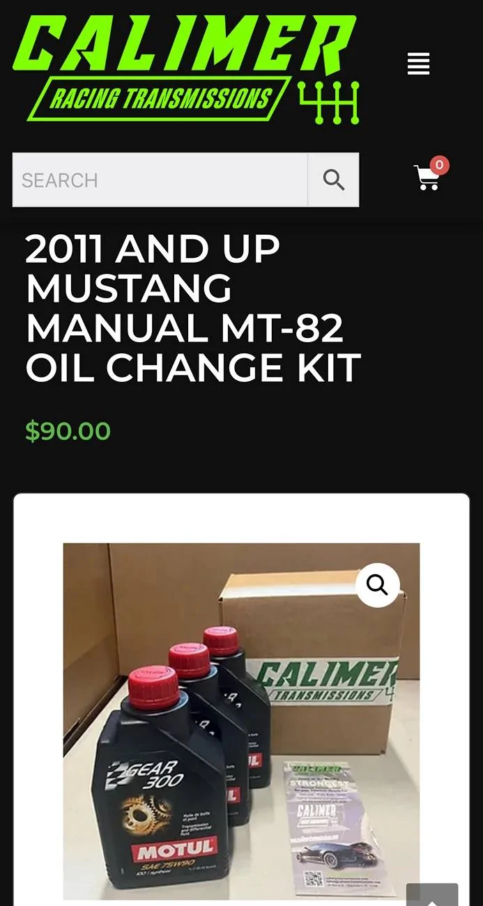

plenty of people run all 75-90 without any issues, no thinner fluids mixed with it at all
S650 Mustang MT82 fluid change IMG_4173
I think you would be surprised, very few people run straight 75w90 in the MT-82 unless it is track duty or a built transmission. And for the ones that do, how many miles in cold weather? Have they put 100k on it?
A few notes:
A) Calimer primarily recommends this fluid for their Stage 3 reinforced MT-82 transmission. This is not a stock Mustang MT-82 transmission.
B) Calimer makes a living rebuilding transmissions. Take that how you will, but they make money by repairing broken MT-82s.
C) 75w90 is far from the Ford Spec. This really is gambling in cold weather.
The biggest problem with thick fluids is you may not know it has caused excess wear until it is too late and serious damage has been done (i.e. it starts grinding gears). It may wear a little at a time until it is too late, then there is no way to fix it but to rebuild (Calimer will gladly rebuild it for $$$).
I'm not saying you can't use thick fluid for a while. It's just a matter of which will create the least amount of wear. It might shift fine now, but will it still at 100k? Thick fluid like 75w90 can and will cause more wear in cold climates in the MT-82. Ford moved to thin XT-11-QDC for this specific reason due to all the MT-82 failures early on.
It's best to stick close to stock viscosity for cold weather. That's all I'm saying.

It's fine. I'm speaking from experience. People have been running that fluid for a long time. It was what ford originally specced (and then went back on because the mt-82 is a turd). Mine has almost 100k on it (it's not an S650 if you have not figured that out by now) and is connected to a boosted engine.
Also I don't drive my car in the cold (40 or below) so I don't care about that.
