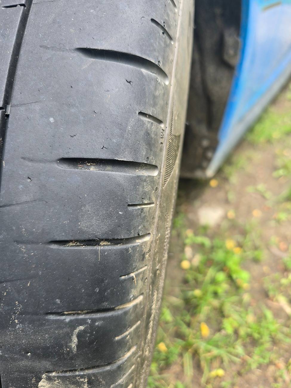

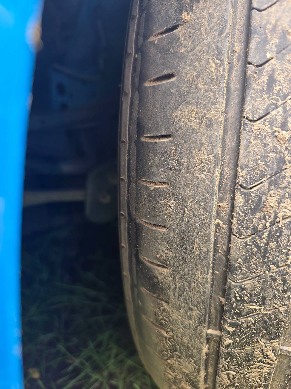

Wearing down like this at 8k miles. Dealer will only replace 1 tire and they checked alignment and told me everything is perfect.

Don't really know what to say about the OP's wear issue. Can't tell much from the pics.
3,877
5,464
Are those P Zeros?
The wear pattern doesn't look uneven. But it's hard to tell without seeing the tread all the way across.

Yeah, if you look at the difference from outside tread lines then the inside they're half gone. Rest of the tire looks new still
Hbutton0219
Jun 20, 2025
Pennsylvania
2024 ford mustang gt premium
I don't see a problem. As far as I can see wear pattern is fine, and it's a fair way from the wear bars
Only wearing the inside is fine? I can't be spending $1000+ every 8k miles for new tires
OK, I couldn't see all the tread. That's what I meant by "as far as I can see".
I'd get an alignment, possibly camber and/or toe is out of spec.
Camber won't wear like that unless its very agressive (like -2 or more) or your ripping around the track on a regular basis.
That looks like toe to me, but I can't be sure until I see the whole tire.
