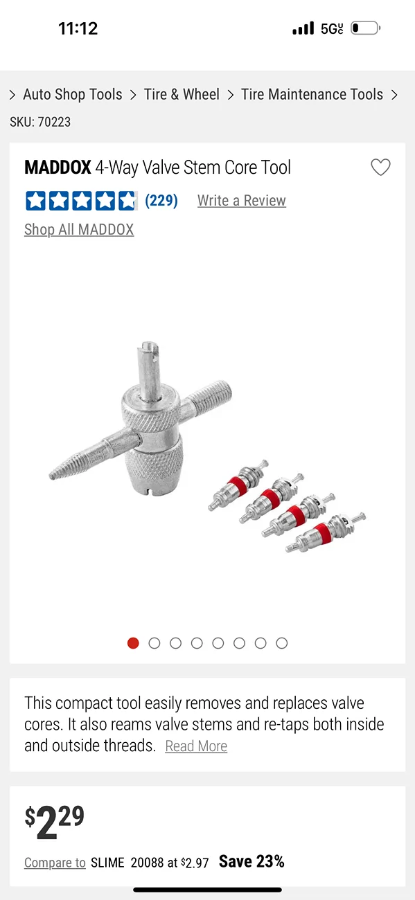

Try moving the valve stem around. Mine had the same issue but I could only hear the air come out after pushing it side to side.
You may also want to check that the internal valve is tight. You will need a special tool for that. Looks like this.
That's what the spit test is for. A drop of spit where the valve screws in will reveal leakage.
