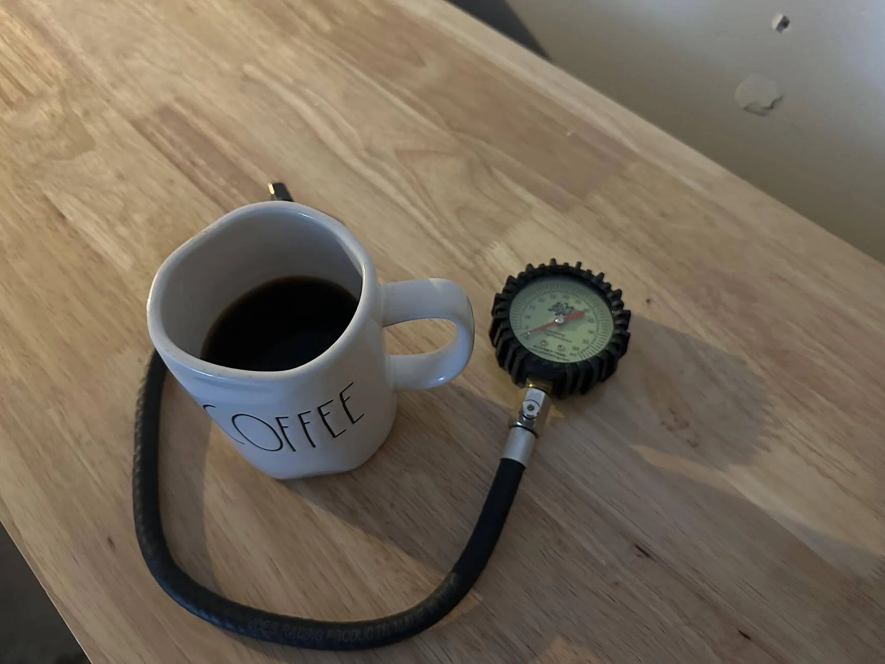

This is how my morning coffee was spent.
S650 Mustang Tire psi 1726832601366-io
Joes Racing 32307 (0-60) PSI Tire Pressure Gauge. Seemed to have decent reviews.
I opened the garage door and let some cool air in for a few minutes. The front tires seem to be at 33.0 to 33.5 so those are fine. The rears are around 33.5-34.0 so I'll check those in a little bit and drop some air out if required to get them down to same as the front.
