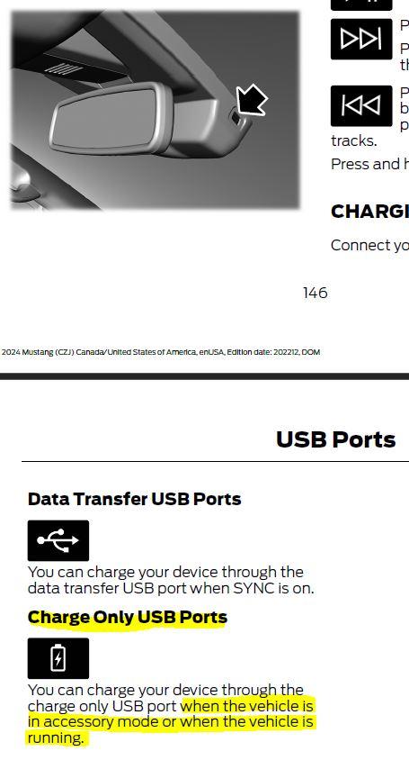

Is the USB by the mirror powered when the car is off? I want my camera to work while it's parked. Avoiding running a cable to the fuse box.
Sadly it’s not but how would that work with the battery? Wouldn’t your drain the battery if you left your car for a longer period of time?

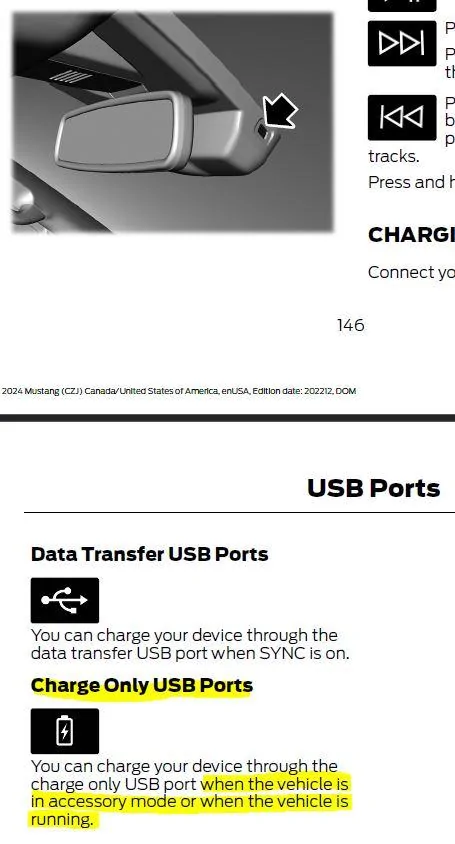

It's right there in the manual.
It's a shame there isn't a small slide switch near the mirror USB port to select whether that port is always on or on during running/accessory only. Even better if you could change that behaviour in the centre stack GUI.
It's obviously intended for radar detectors only.
(Which unfortunately are illegal to have in my country :curse: )

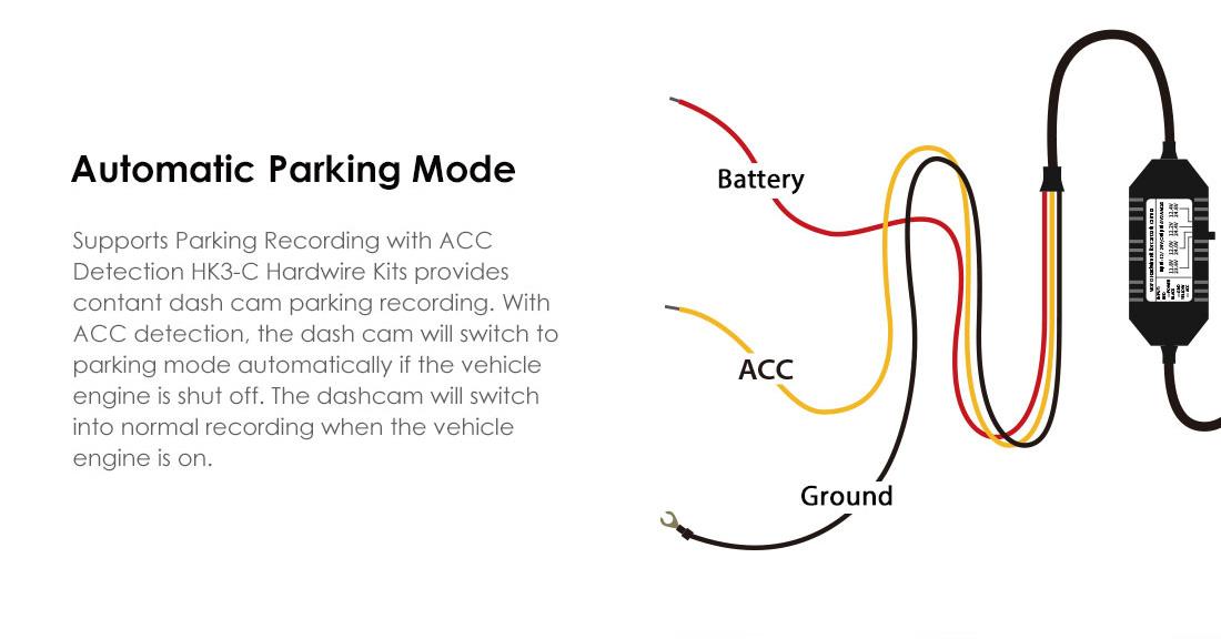

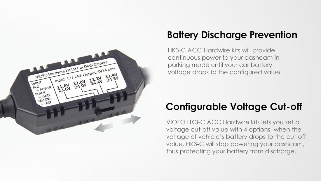

Exactly the reason the Viofo HK3-C exists.
https://viofo.com/accessories/211-v...t-for-a139a139-pro-1ch2ch3ch-dash-camera.html
S650 Mustang The Dash cam thread 1_05
The selectable low battery volts cut-off prevents you from draining the primary car battery.
Call me old fashioned, but if you're going to do something, do it properly!
I'd be using one of these for a proper install.
Edit:
And it will place the A139 Pro into parking mode automatically.
