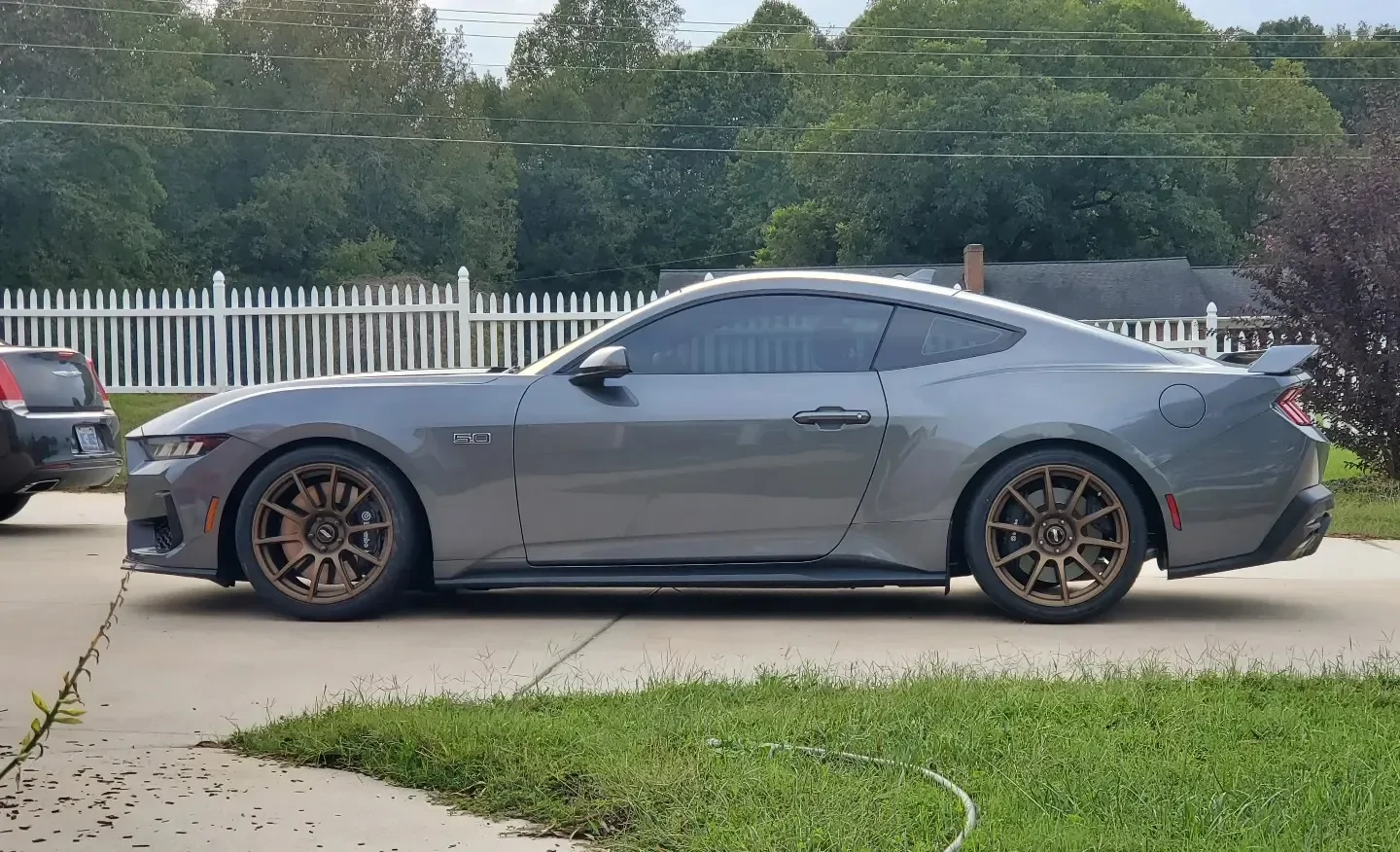

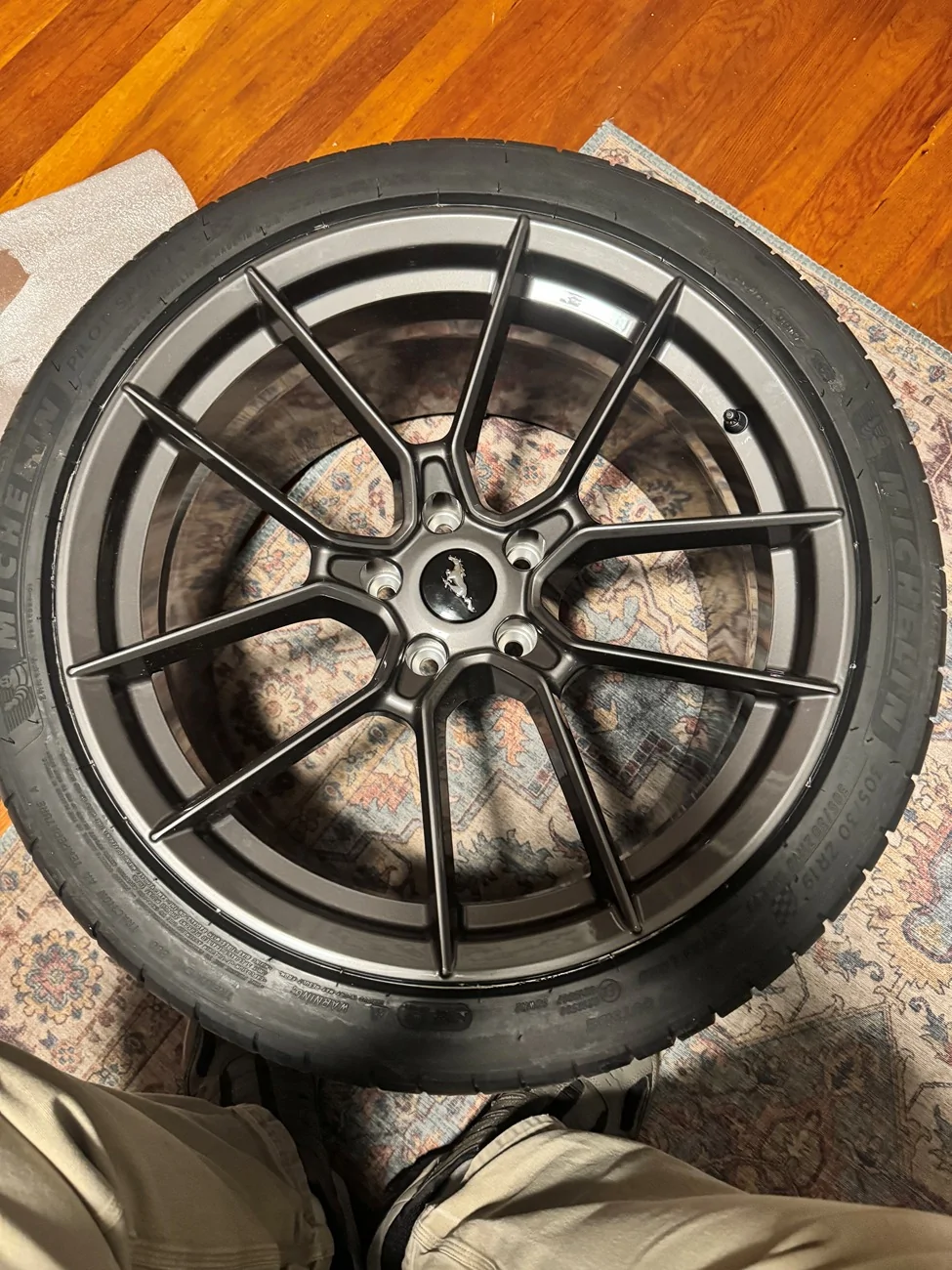

And this one is 20", 11 in front and 11.5 in back, 305 and 315 tires
Looks like the taller wheels gained this Dark Horse a little more ground clearance for that front spoiler.

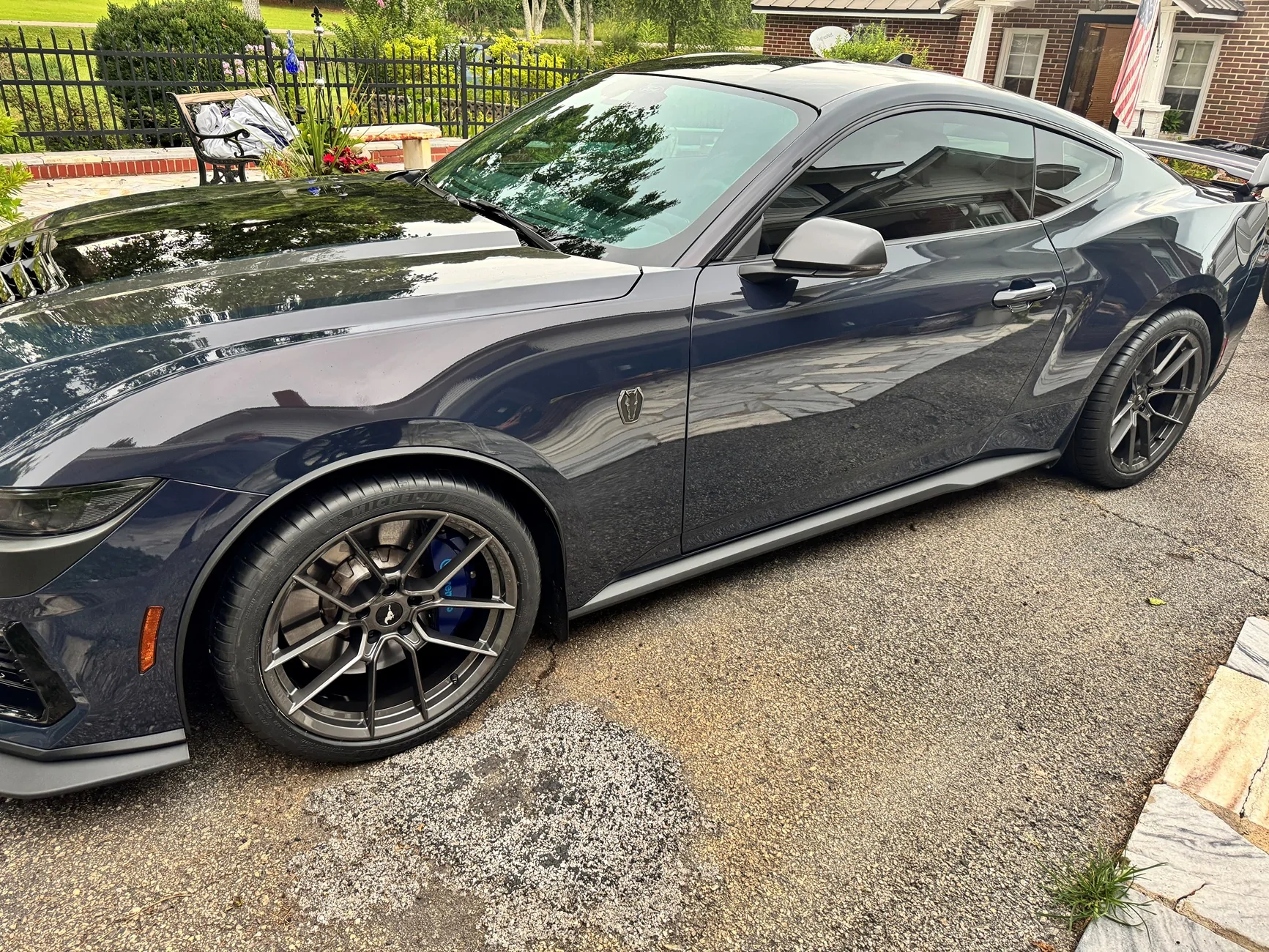

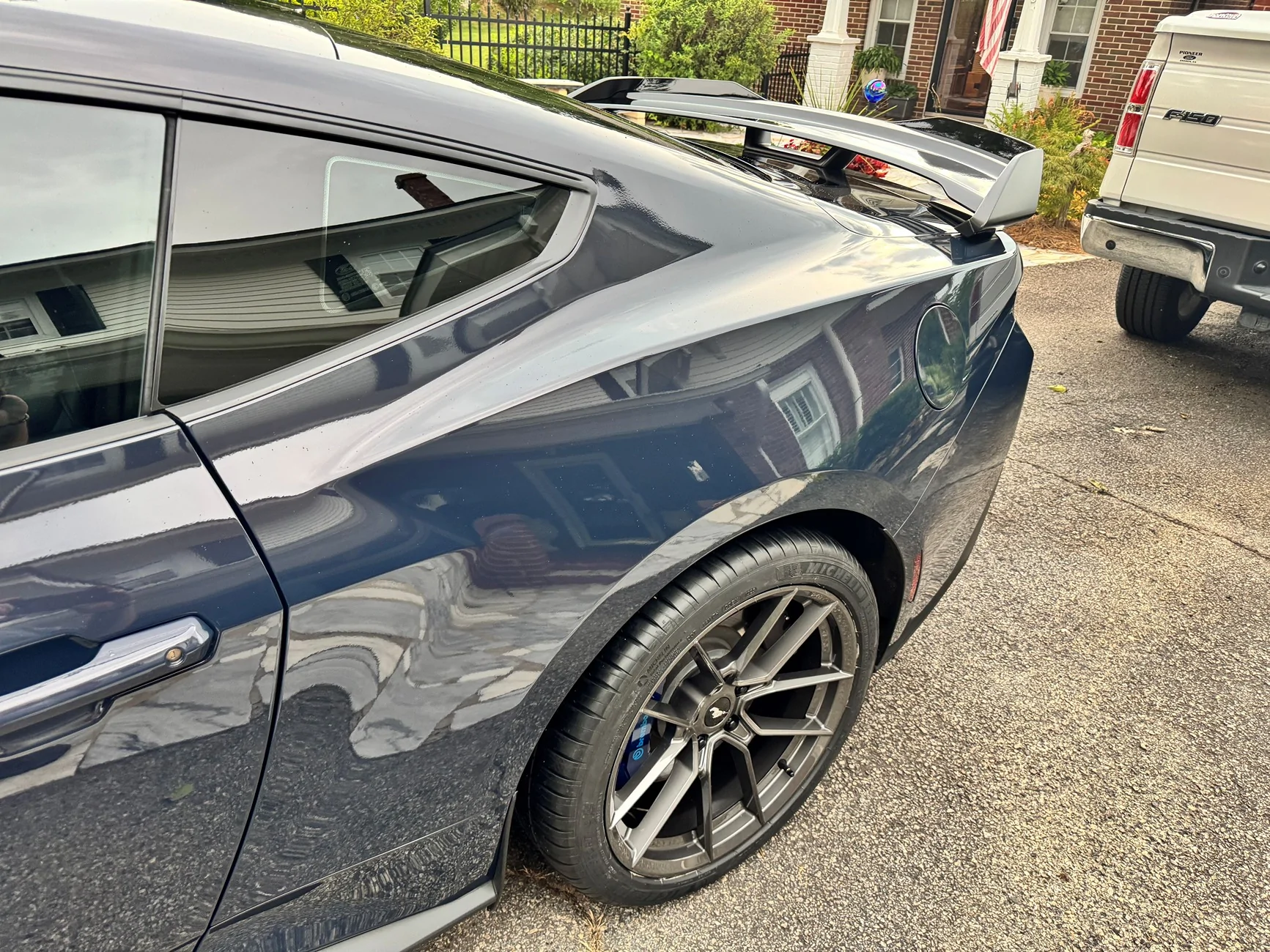

I went with the forged SVE DHP1 I have been pleased with the quality of the Wheels. I went with the 10.5 X 19 front and 11 x 19 rear in graphite.
Good to see another Georgian - and almost exactly the same car.
