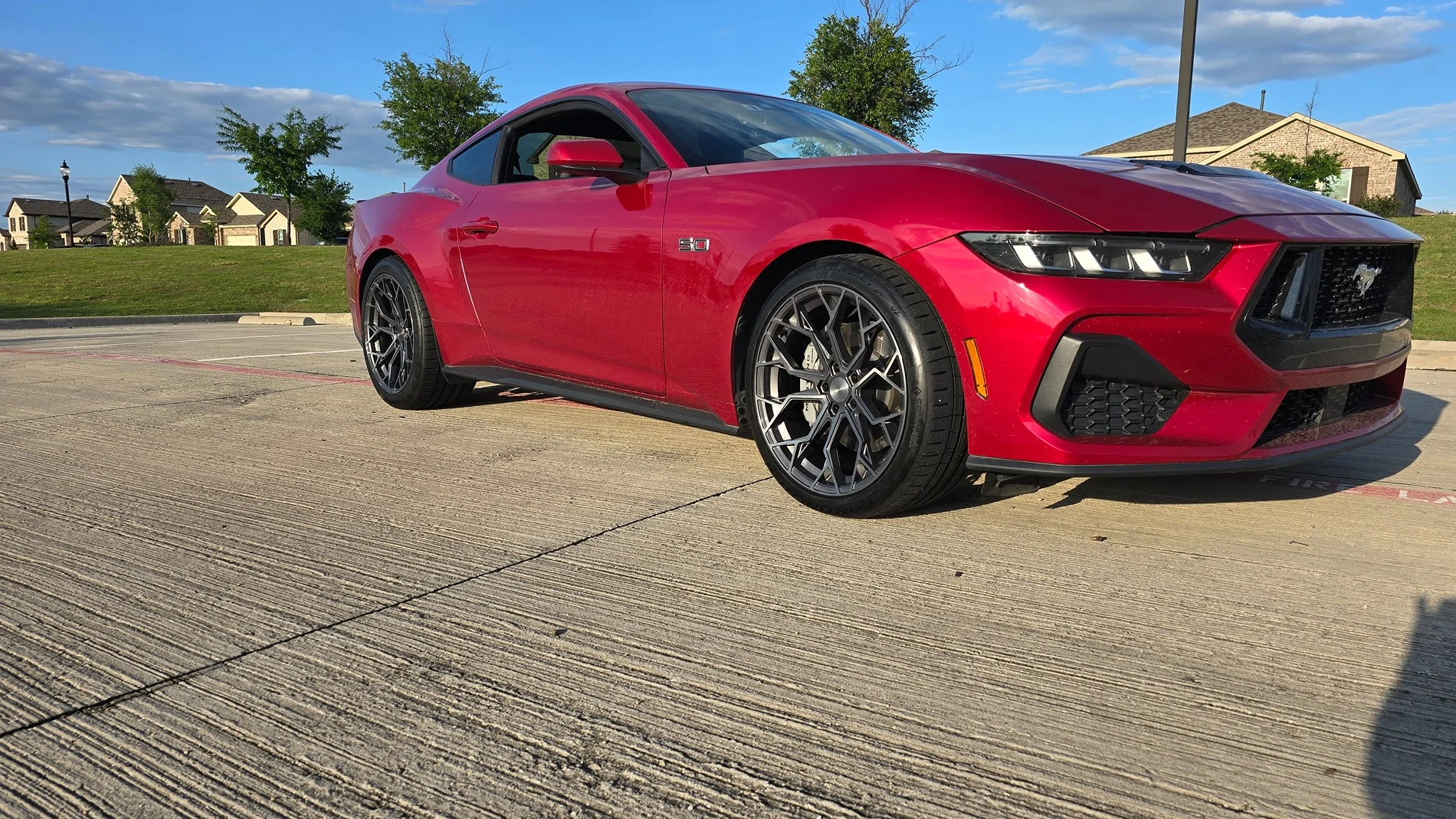

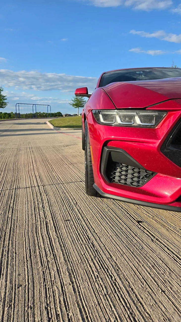

Here are a few photos of the SVE DHP1 and misc. views. I forgot to take a close up. Sorry pics coming in a few minutes.....
S650 Mustang Shoe shopping - is Forged worth it? Back & Side view 2
S650 Mustang Shoe shopping - is Forged worth it? Front & side view
S650 Mustang Shoe shopping - is Forged worth it? Rear View 3
S650 Mustang Shoe shopping - is Forged worth it? Side view SVE DHP1
S650 Mustang Shoe shopping - is Forged worth it? Side view SVE DHP1 -2
