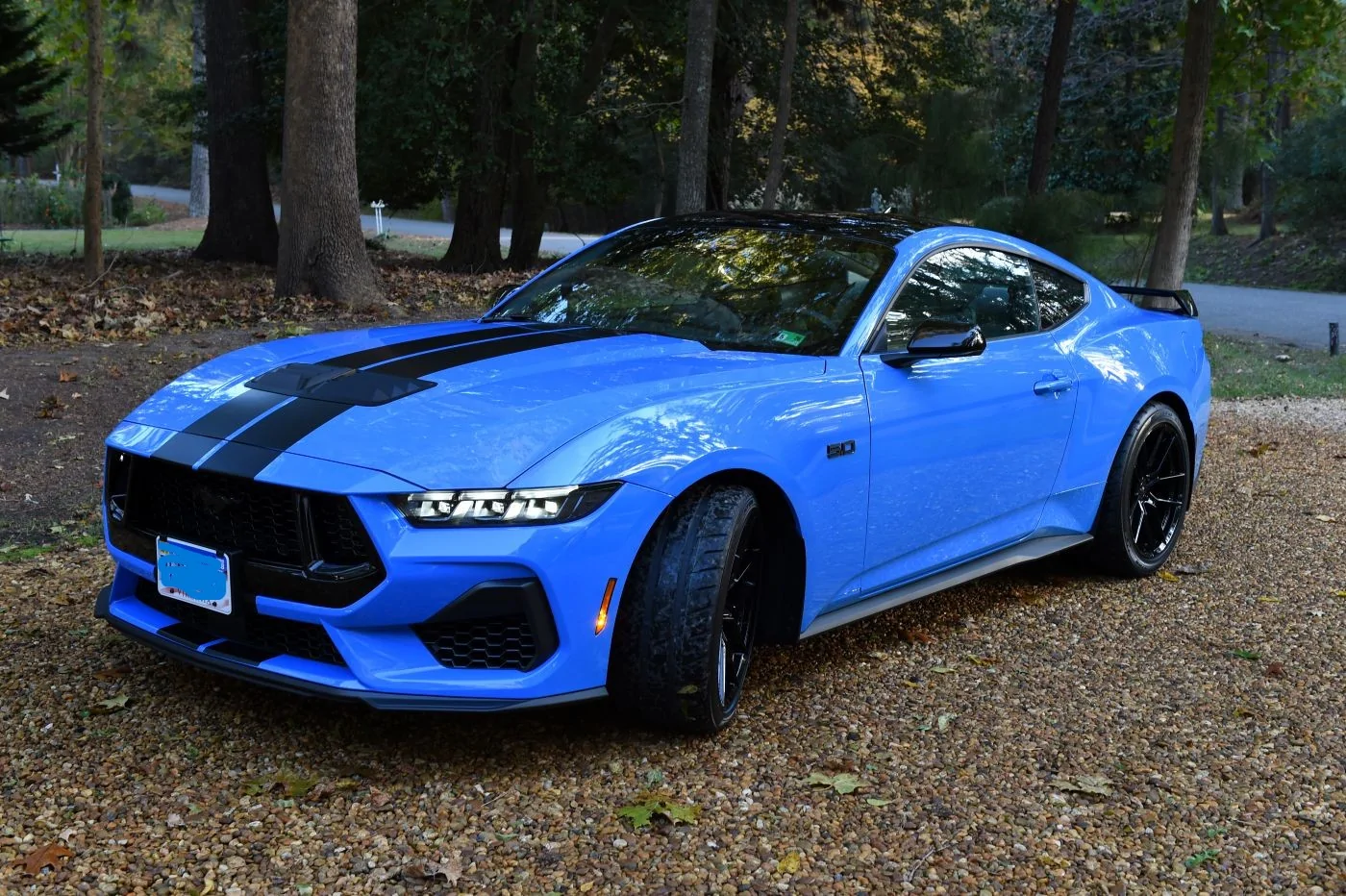

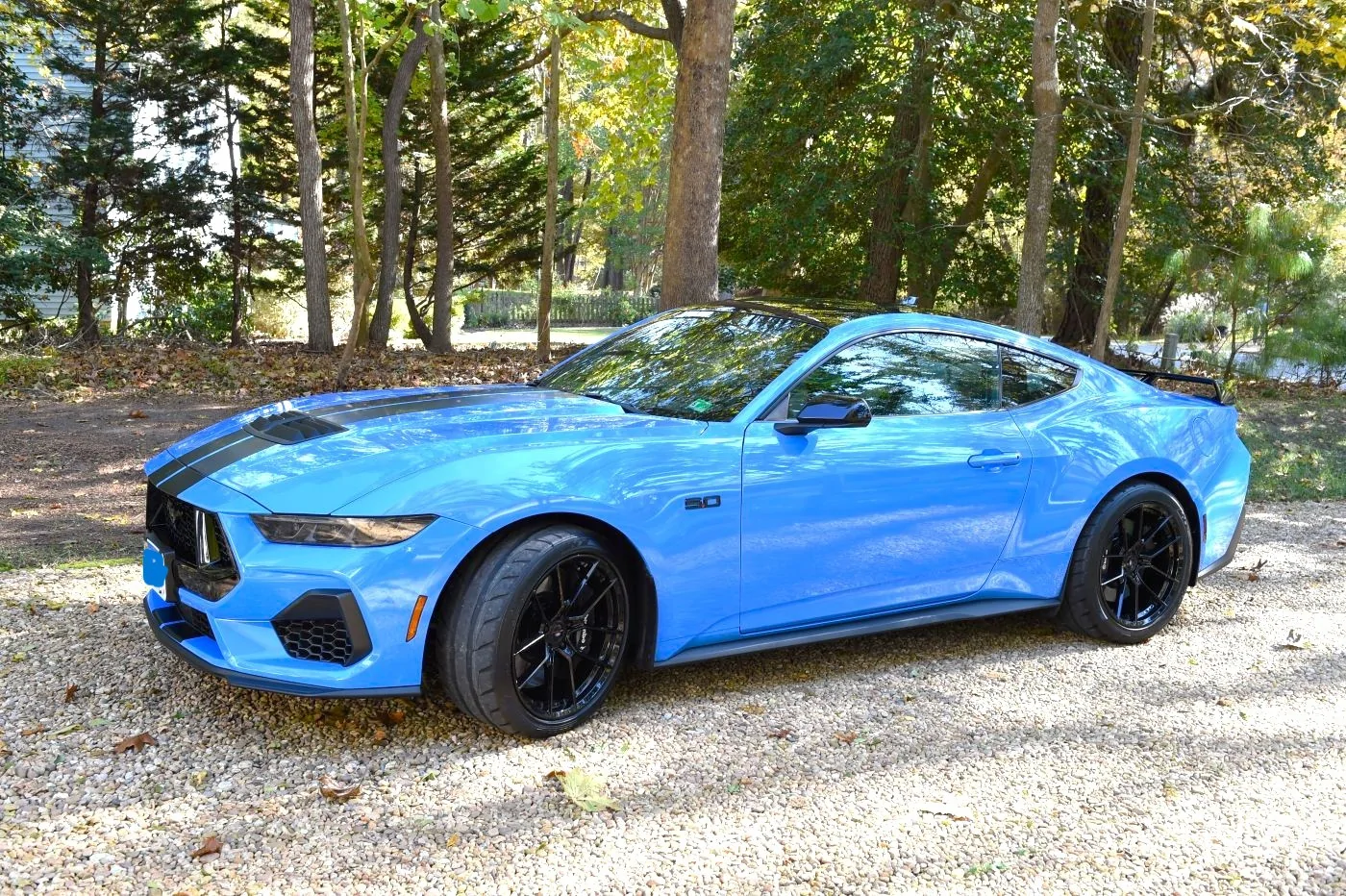

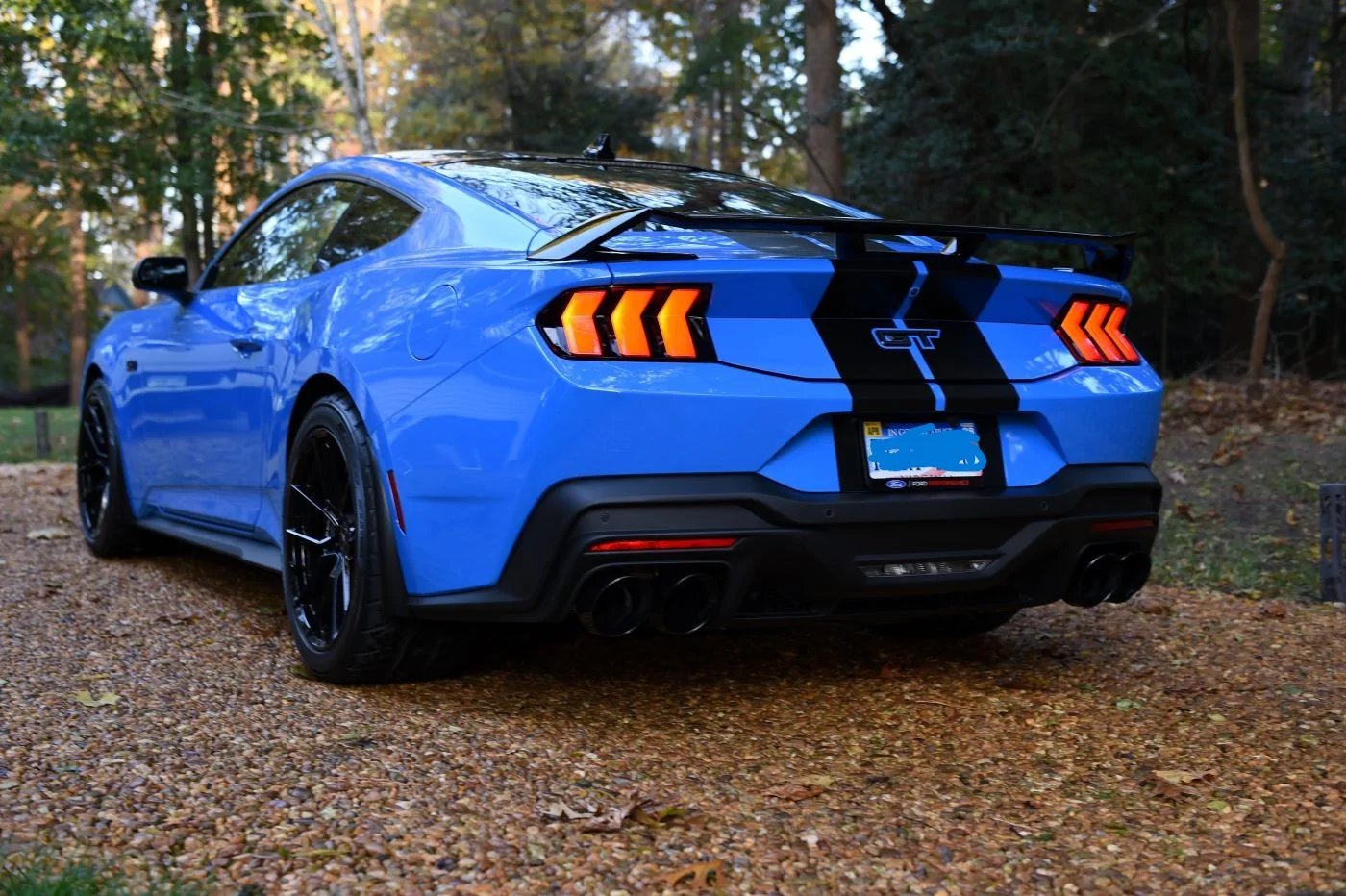

I'm okay with the tire Nitto NT05 tire sizes that came with the package. I posted the sizes in this thread - Here they are again.
Front 275/35/19 Nitto NT05, Rear 305/35/19 Nitto NT05
One thing to keep in mind is the Nitto NT05's are wider than most in the same size.

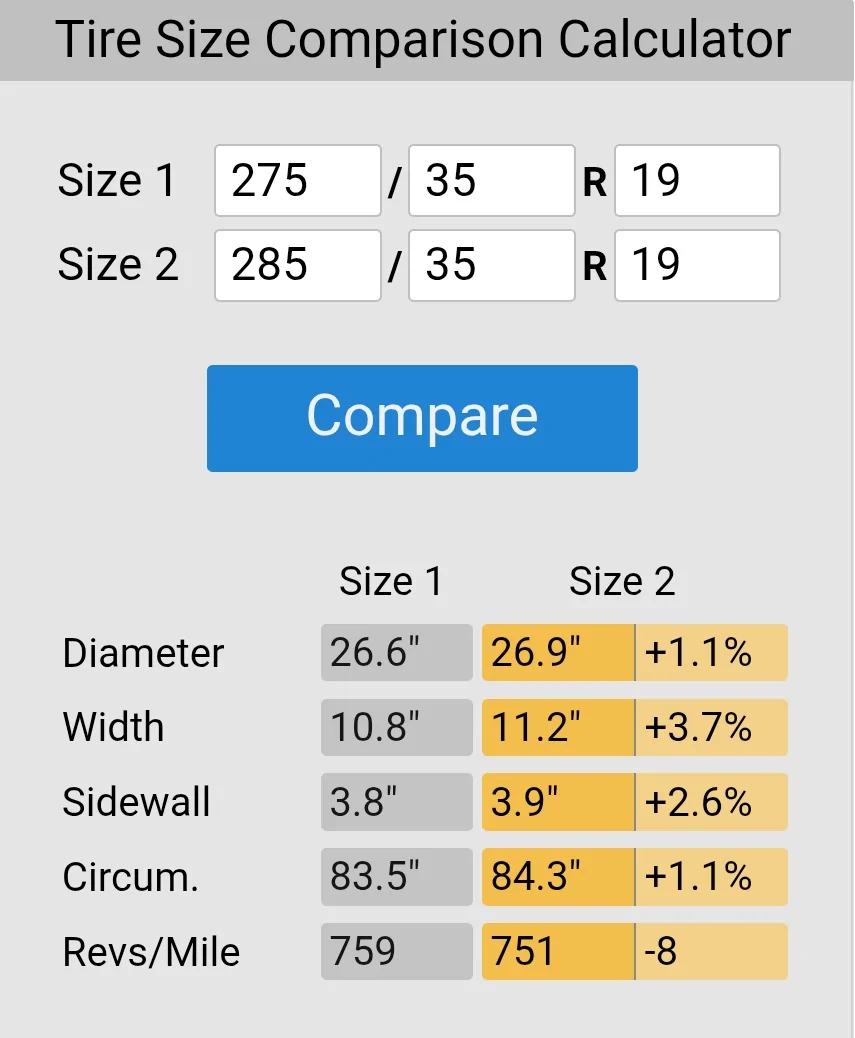

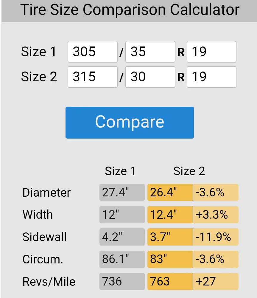

Here are some comparisons. The 275/35 and 315/30 are smaller in diameter than typical stock sizes. I think 285/35 and 305/35 would be the best combination for looks and speedometer calibration.

MidwayJ - that is a great calculator. i found some toyota site that shows a visual as well thats fun to play around with.
2d pictures only go so far though - i really appreciate everyones pictures and input on tire sizes. Id like to make the best decision the first time - tires for these new mustangs are quite a bit more expensive than the ones i put on my 66 lol

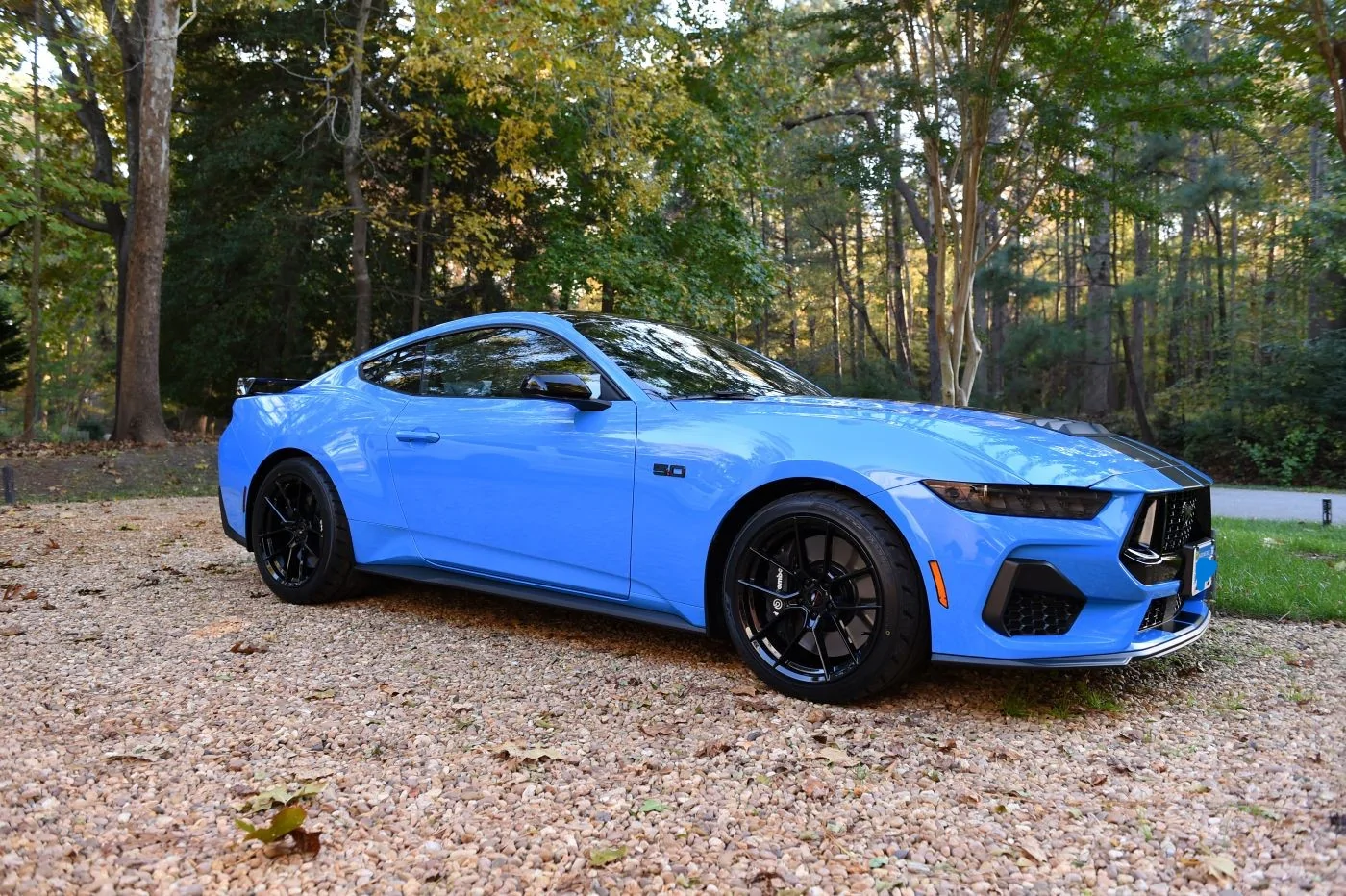

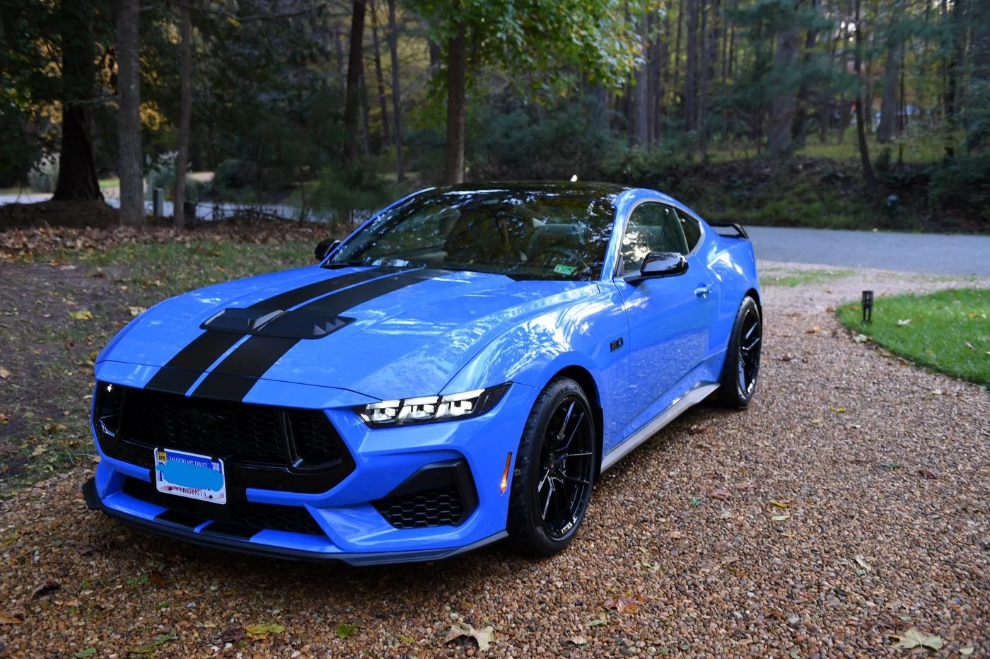

Based on the non HP I would stay with 10" front, 11" rear. It may be worth searching and asking around if 10.5" will work on the front of a non HP DH.
Edit - Added a brighter side view that show the SVE DHP1 wheels a little better. Grabber Blue is very hard to capture and show the true color in a photo.

Are these particular tires or generalized?
I ask because even within the same manufacturer a different tire of the same size, say, 315/30zr19, can be greatly different tread width and diameter.

It's generalized. They would need a huge database to accommodate every tire. Yes sizes vary by manufacturer, but it's still a useful tool to compare how the specs change between different sizes of the same tire. In any case I've noticed width differences between brands but haven't found the sidewall or diameter to be "greatly different" between the various 285/35r19 tires I've used.
