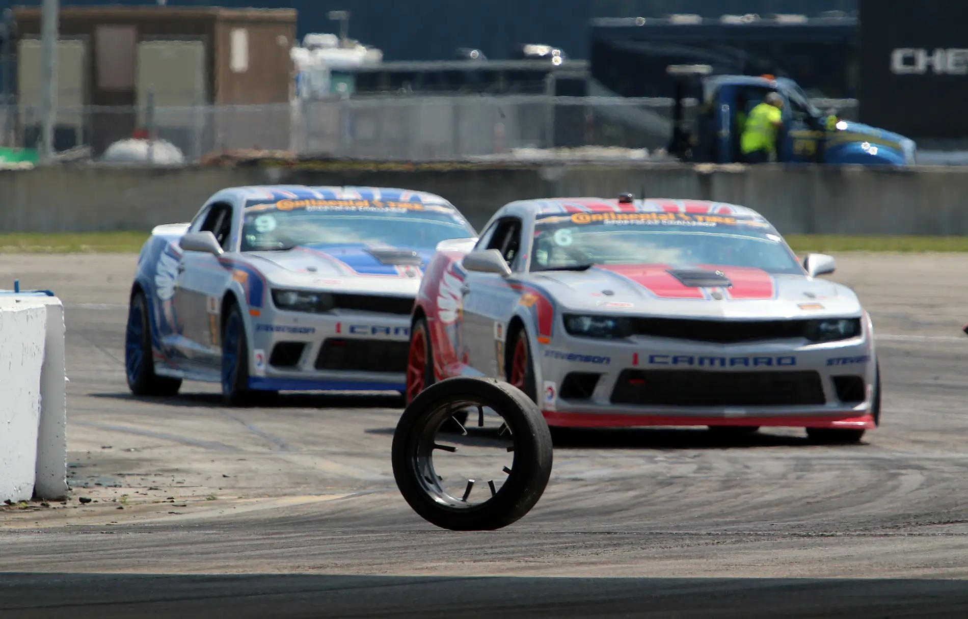

and it's not like you're going to break a flow formed wheel on the track. Unless you hit something at 100mph (which would damage a forged wheel too...)
I just saw a picture of a chunk of the cast center of a flow formed wheel flying of on the track, lol, but it could have been one in a million, who knows?

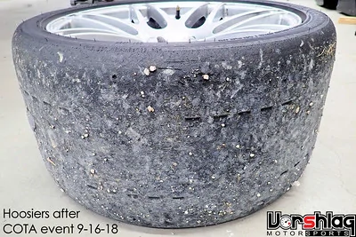

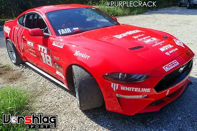

Great article, but, um, I am not going to take a Sawzall to the front fenders of my beautiful Blue Ember Metallic Dark Horse to fit 12" wheels up front . . .
Wow, they got some excellent results, though, I and I liked the look of the S197 with the fenders flared after they were painted.
For those who might want to take a look, later they buy an S550 and start experimenting with square 11" set ups and 305 tires (and a 315 Hoosier). "We actually had a short period where we ran the 315/30/19 on a 19x11" wheel set, too. The move to Hoosiers was worth 1-2 seconds per lap over the RE-71R - which we tested extensively, back to back, on many race weekends."
S650 Mustang Shoe shopping - is Forged worth it? 1761783756190-p8
S650 Mustang Shoe shopping - is Forged worth it? 1761783771719-po

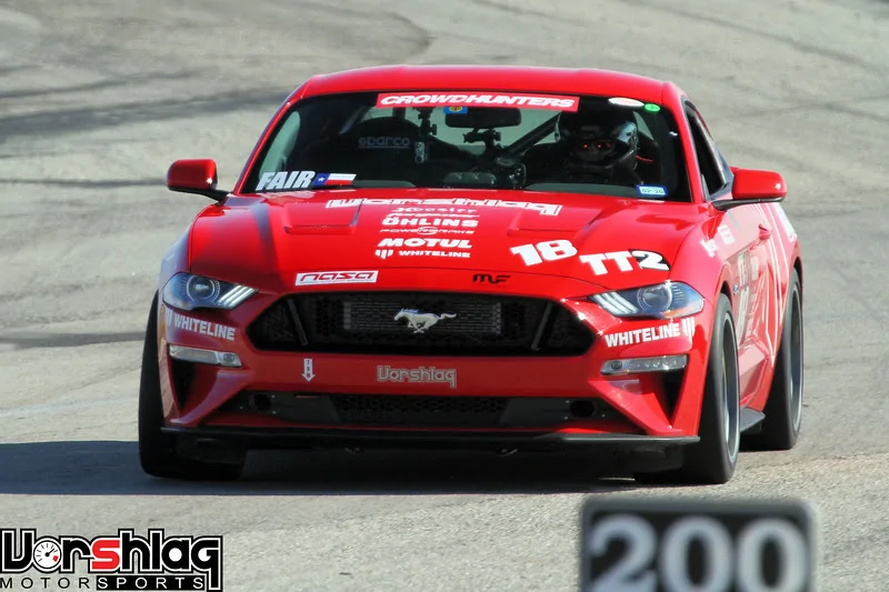

S650 Mustang Shoe shopping - is Forged worth it? 1761783811939-z
We tried to fit an 18x12" wheel on the front or back of this S550 chassis, but came up short. Not possible without massive tire poke, cutting, or flares... 11" is the maximum and the 315mm Hoosier is pushing the limits of what "fits" - as you can see above..
End of Quote - and they had some tire rubbing on the inside - click on robvas's link to take a look.
