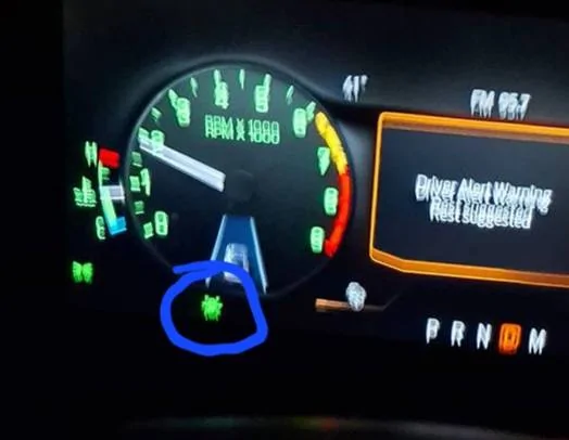

Lane assist active = light is green
Lane Keeping (more similar to autopilot) = light is blue

Lane centering and lane keeping are two different features in (Ford) vehicles.
Lane centering keeps the vehicle in the center of the lane using automatic steering input, and works with the intelligent adaptive cruise control.
Lane keeping provides a notification and/or aid (slight turn of the wheel) to put you back into your lane once you reach the bitter outside edges of the lane (markers). Lane keeping can be on with or without intelligent adaptive cruise, but is only to keep from drifting out of the lane.
As the owner of both a '21 F150 with BlueCruise 1.4 (I upgraded it myself from 1.0) and a 2024 Dark Horse, I'll let you in on my observation: The only difference between a non-BlueCruise vehicle that has adaptive cruise control and lane centering vs. a BlueCruise vehicle is the nag for steering input every ~20 seconds or so. The lane centering will keep you in the middle of your lane. In fact, if you let your BlueCruise subscription expire, what you are left with is adaptive cruise control and lane centering ... essentially BlueCruise plus the nag.
If you are ping-ponging and drifting out of your lane, then (a) you do not have lane centering enabled, (b) your vehicle does not have lane centering, and/or (c) there is something wrong with your cameras, the IPMA module, and/or it needs calibration.
When I first got my '21 F150, there was no such thing as "lane centering" listed in Sync. It was just "Lane Keeping". After applying a number of updates to the APIM, IPMA, and a several other modules to first enable BC 1.0 on my truck, the new "Lane Centering" verbiage showed up, and the Lane Keeping transitioned to the "ping pong" functionality while Lane Centering became the "keeps you in the middle of your lane" functionality.
As far as getting rid of the nag: You can not do it programmatically (e.g., FORScan). Being the safety conscious person that I am, it would not be right for me to tell you that, if you happened to hang a small amount of weight on one side of the steering wheel, lane centering would be constantly countering that weight by steering in the other direction, and that weight would be interpreted as input -- exactly what the nag is looking for. I would never advise such a thing be done.
