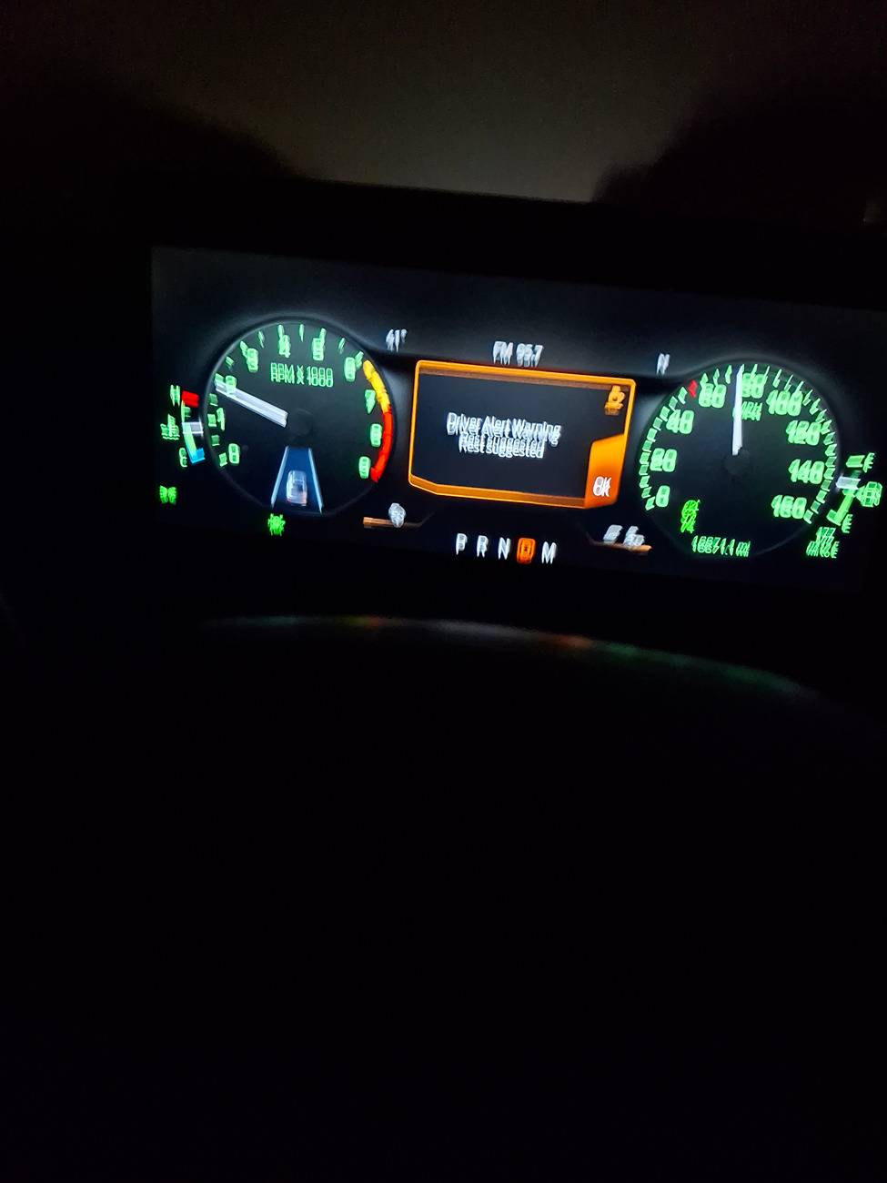

Interesting, Personally I find the Lane Assist function is incapable of self driving, I've tried letting it do it';s thing and it just starts oscillating between the lines and just runs off the road in short a time.
Another Update, There was no traffic on my home from werk last night so I decided to see how long it took to trigger the DUI Alert.
With the cruise set on 75 it took 2miles constant weaving to set it.
S650 Mustang S650 Mustang -Keep hands on steering wheel message DUI_Warning
89Trooper
Aug 19, 2014
1,242
267
Central Florida
Do you have "Lane Keeping" on? What that on, the car holds dead center of the lane... on straights, through curves...
With "Lane Assist" on, it'll bounce back and forth between the lines.
"Lane Keeping" is awesome... except for the stupid warning. Tried it again going to work this morning... every 15-20 seconds, even with my hands on the steering wheel.
