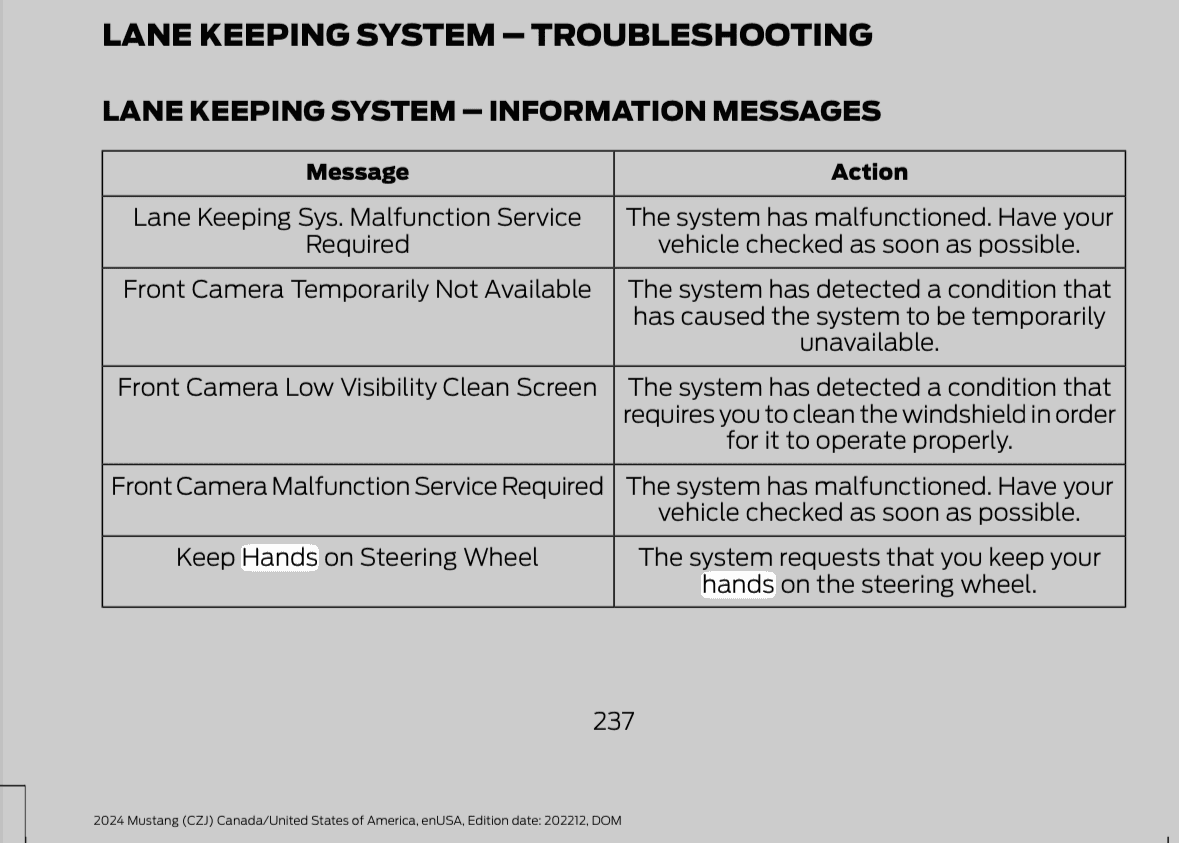

I thought this warning is when Lane Centering is active and you haven't touched the wheel for a set amount of time? Wife's Acura does this. I didn't think it gives the warning for Lane Keep Assist though? Also I don't think manuals come with Lane centering?
4,852
2,675
S650 Mustang S650 Mustang -Keep hands on steering wheel message Open 2024_Ford_Mustang_Owners_Manual_version_1_om_EN-US
