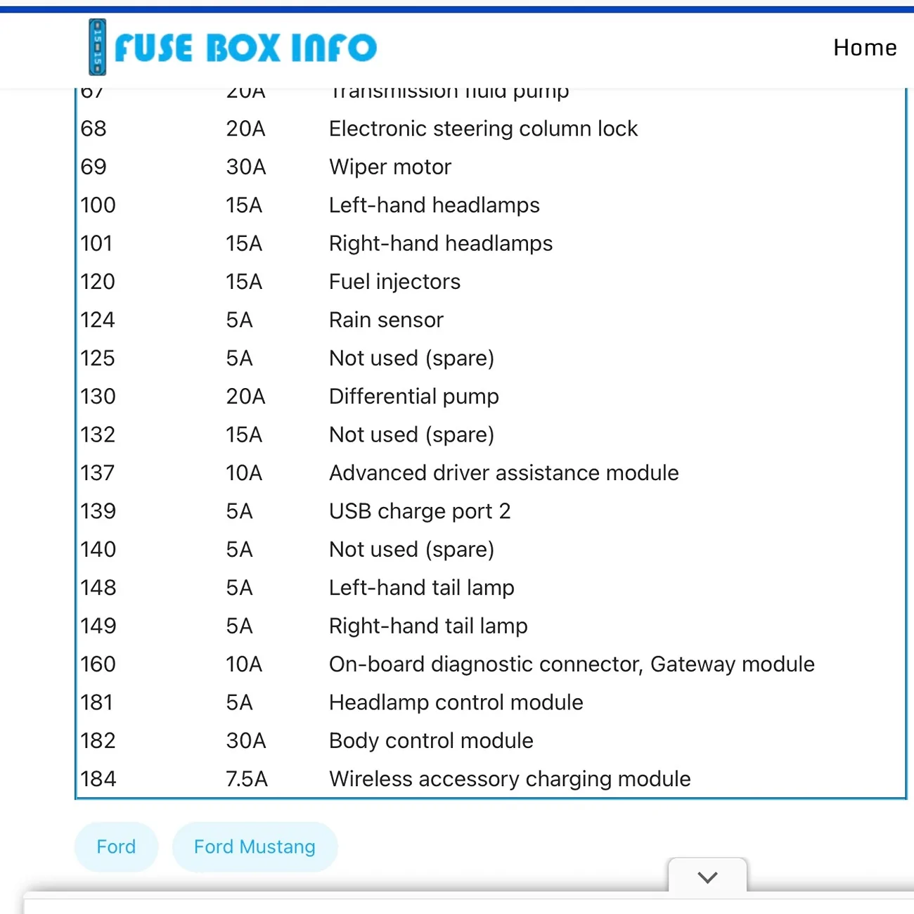

I don’t recommend it, but can’t help but wonder what happens if you pull fuse #137?
Easier /safer to just push the button on the steering wheel but now i gotta find a pic that shows the button (unless anyone else has one handy)
