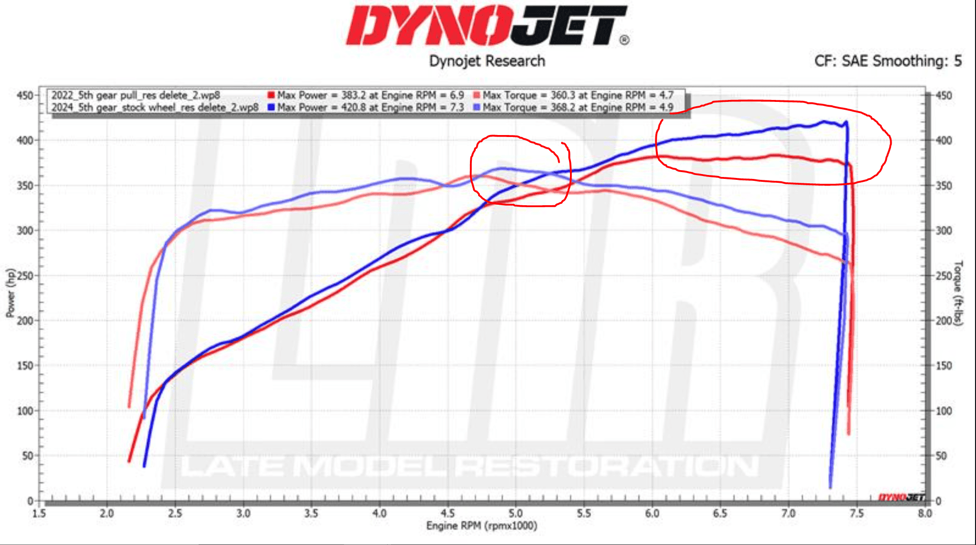

most graphs look like this one
peak torque before 5000
meat of power around 6000-7500

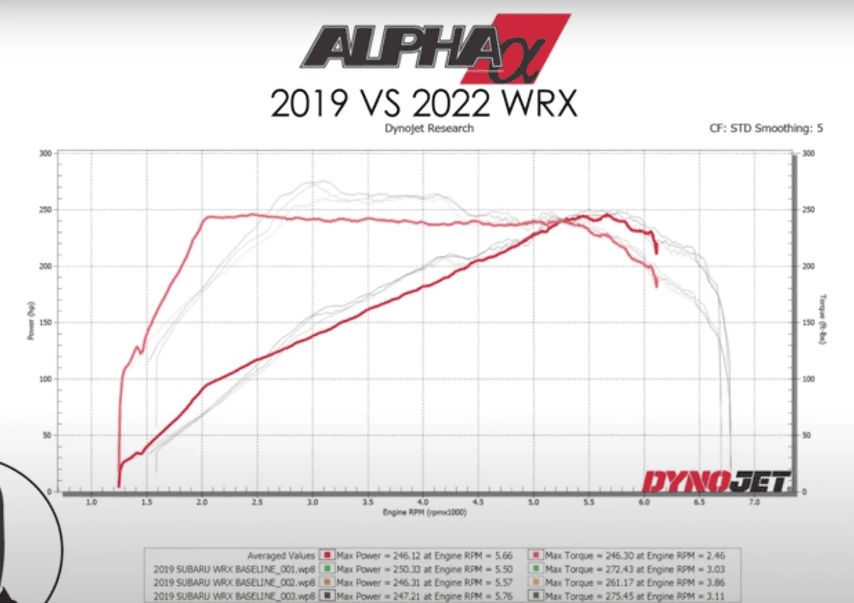

I'm old school. I LIKE manually shifting thru the gears. The WRX produces 270 HP which is pretty good for a car weighing in at 3,200 lbs. while the Mustang produces 486 HP (AVE) and weighs 3,800 lbs.
Here is a Dyno of the WRX stock engine:

This is splitting hairs, but remember the WRX has the additional drag from the center and front differentials, whereas the Mustang is only driving the rear diff. WRX has AWD advantage from a dig, but if you’re talking seat of the pants feel from a roll, the additional drag of AWD is probably more noticeable.
