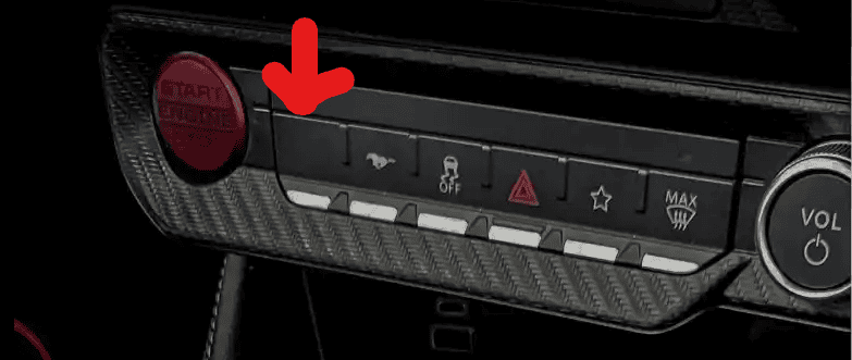

Since I don't have my DH yet; can someone show an image of what button we are talking about here? Is this the BIG button that wraps around all the little ones?
Personally I'm hoping someone makes a plug and play kit for some toggle switches like my S550 has.
S650 Mustang Poverty Button Replacement Screenshot 2024-07-22 084925

Thanks @GhastlyTT
I'll have one of these too as my build is a 6 speed.

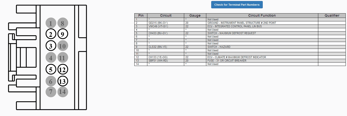

some info:
here is how the pins for the connector are used, whether or not the vehicle has auto start stop
S650 Mustang Poverty Button Replacement 1721655583450-lu

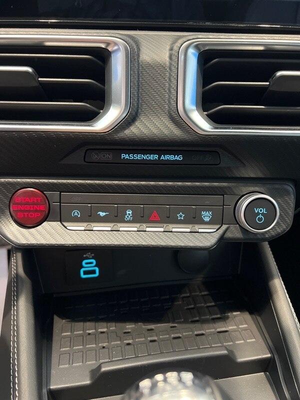

You should have just waited for the Job 2 models like mine with the auto start/stop button
One thought, maybe replace with the current buttons, just to fill the space. The auto start/stop will not do anything but at least it won't be blank.
My manual GT convertible:
S650 Mustang Poverty Button Replacement 1000012424

some info:
Am I wrong to interpret this as meaning the blank button can send a signal even though it's unmarked? Are you able to see if there are multiple versions of the button box or if the only difference is the button label printing?
