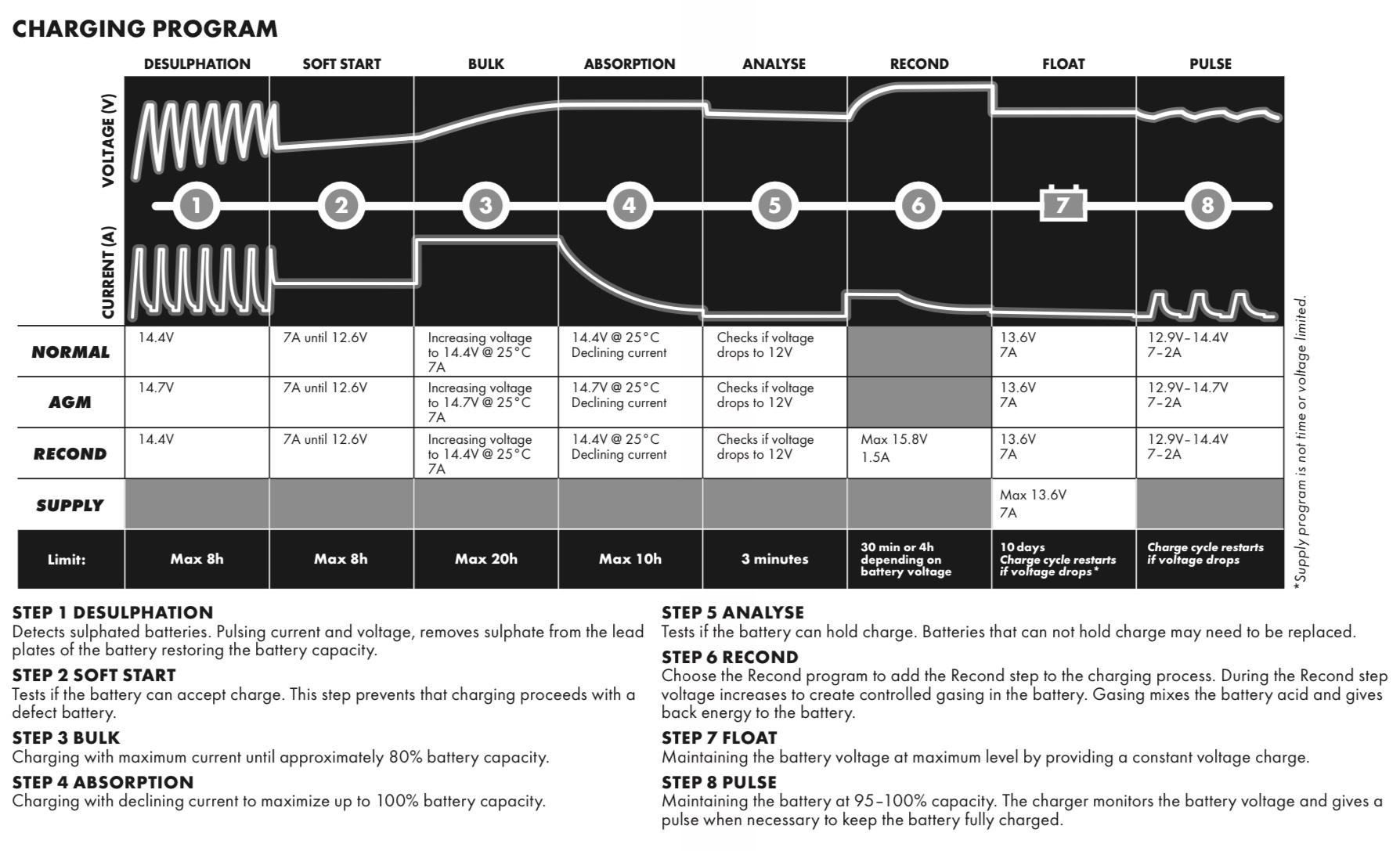

Once the cars are built, they are placed in a semi-sleep state, aka "transport mode". One reason is to limit what the driver (trucker, rail operator, thief) can do with the car. Another reason might be to limit these electrical losses.
Further, after about two weeks, Ford vehicles by default go into deep sleep mode, where many things are downed/disabled. The car knows it has been sitting and attempts to keep the battery at peak as much as possible.
Whatever the situation, Ford has it sorted. It would be very inefficient if Ford or any auto manufacturer had to jump multiple vehicles from one lot, rail car or truck alone.
Once Members receive their cars, battery tenders and storage will start at least one thread. If driving the car infrequently, setting up to attach to a tender (not a charger) is best. I've run a permanent connection from under-hood to an external plug. When the car is going to sit, I plug-in and walk away.
S650 Mustang Parasitic loss question battery tender stages

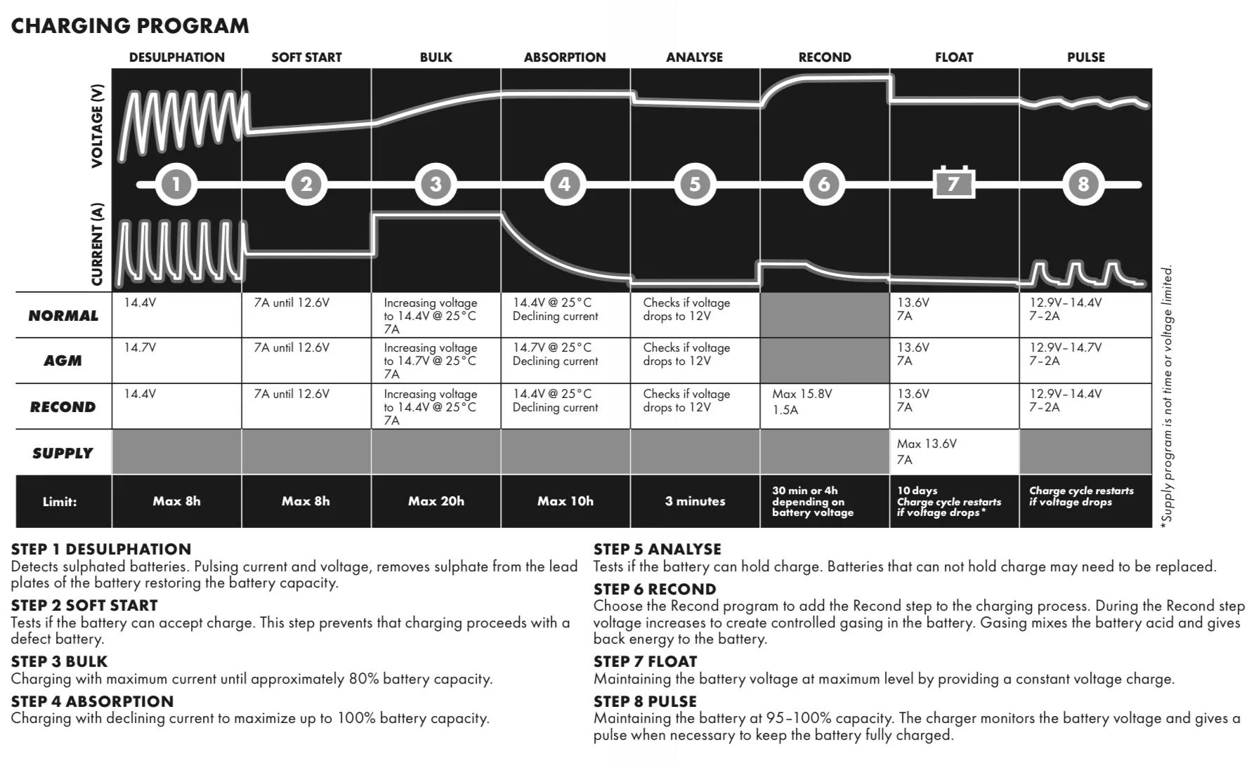

Be very careful with anything that has a desulphation cycle on it. It works by using higher voltage pulses to break up the sulphur and if I used that cycle on a battery, I always disconnect it. Older cars before they contained modern electronics would completely disconnect the battery when the ignition was turned off. Newer cars don't and I am nervous about the high voltage pulses damaging something in the electronics.
Charging and tending the battery normally limit the voltage and are safe to do with the battery connected as long as the unit is properly designed.
