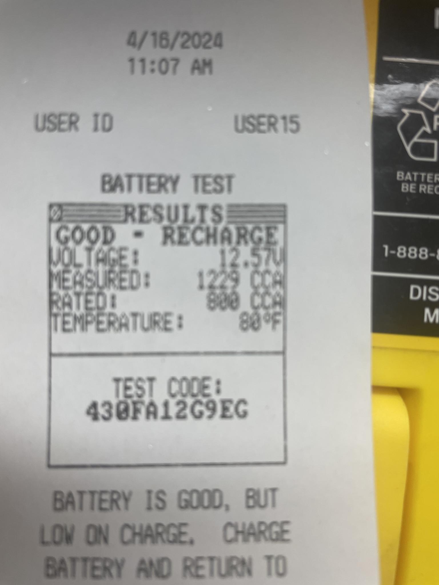

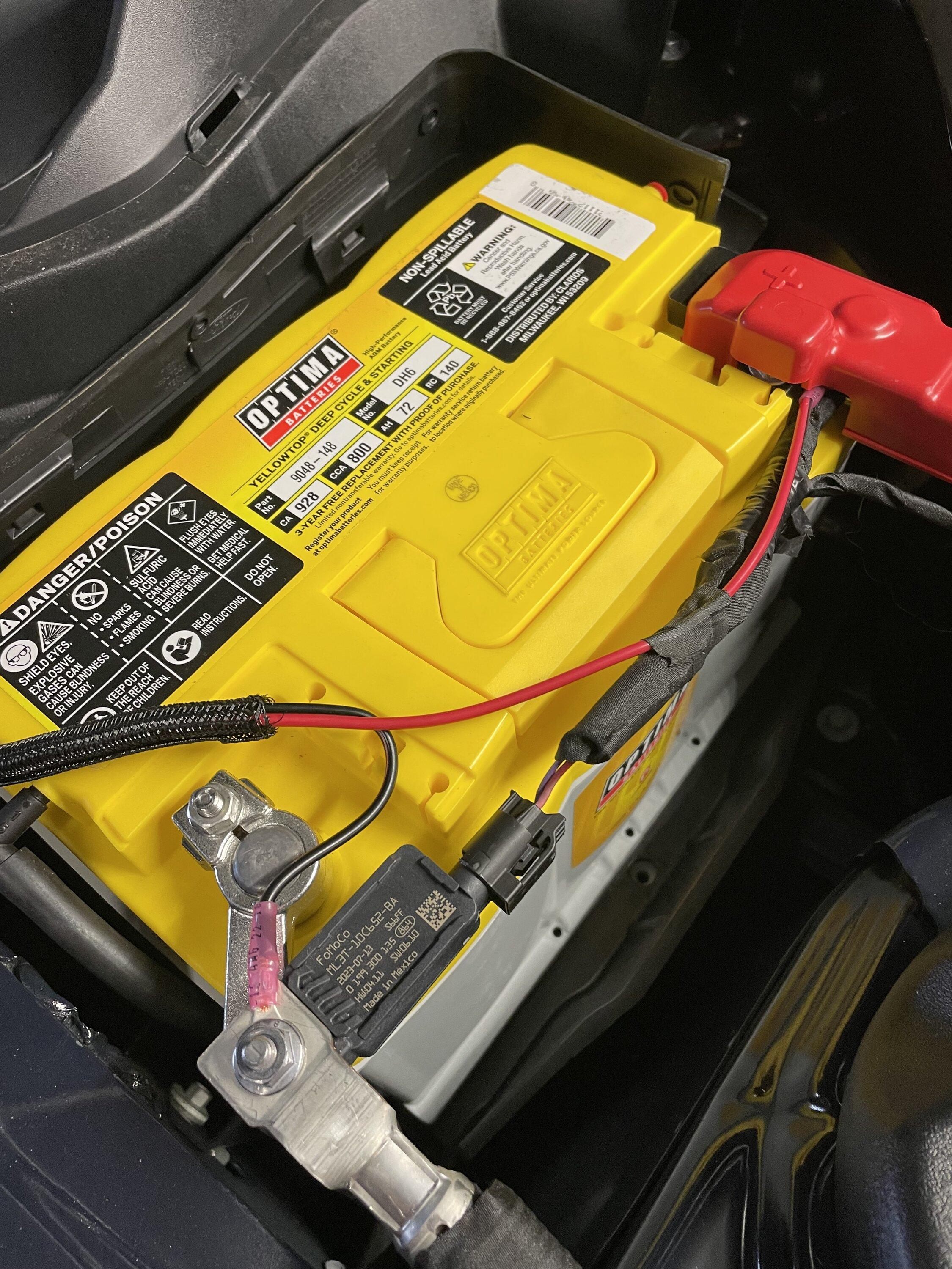

Put a new OPTIMA DH6 in my Dark Horse today. Rated at 800 CCA, tested at an unbelievable 1,229 CCA!

Be sure to reset the BMS (battery management system)
I have not tried this in the DH yet, but in my 2021 F150:
  • Ignition ON, Engine OFF
  • Headlights on
  • Note the solid battery icon in the speedo display
  • Flash the high beams five times in a row
  • Press and release the brake pedal 3 times
  • Wait approximately 10 seconds while watching the battery icon in the speedo display - it should flash three times, then go back solid.
  • Turn the ignition off.
If you see the battery icon flash 3 times as described above, you have reset your BMS.
You should do this after replacing a battery OR after a DEEP charge in the event you let your battery get low.
It's really nice, but I don't understand why you changed the battery now? Is it for weight savings?

I have a tool for doing that.
I retired from the company 10 years ago, so they asked me to do an install. I was the Sales Director when I retired.
