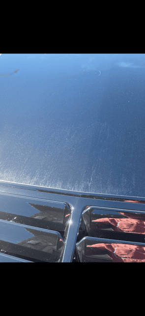

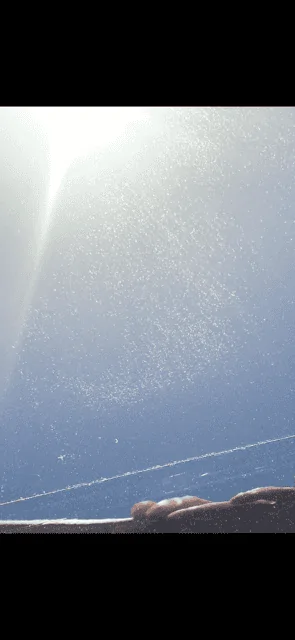

So I had the entire front end done in PPF and with ceramic pro. Dealer covered the ceramic pro and I negotiated the PPF. Well the PPF did not set well, mainly on the hood and some other crease flaws and bubbles. Some photos attached.
I am taking it back to get redone, of course covered. So here is my problem. When it was done first, I was told it needed 24 hours to cure and then I could take it home. It is an hour from my home. He also said driving in the rain after 24 hours is OK, which I don't think is correct.
So my understanding is that the PPF goes on first and the ceramic coating goes on after. He is telling me now he can fix this in 3 hours and I can drive it home as he will precoat the PPF with ceramic the day before. Does that make any sense? Doesn't ceramic harden and how would you stretch the PPF to get it on well?
SO the coating is ceramic pro but the PPF was Expel Ultimate. He told me that for me to not have to come back he'd use Kavaca PPF that ceramic pro uses. Apparently pre coated in Ceramic. He feels the Expel Ultimate is a better product though.
And when is it ok to drive in the rain after Ceramic or PPF. Weather looks bad all week.
Any information would be appreciated before I go back to the guy that did it wrong the first time.

How long has the PPF been on the car? From my research it can takes weeks for smalI bubbles to evaporate but that looks pretty bad. I'd want it redone as well. I just had my front end done with Suntek Reaction that has hydrophobic properties which the installer called "ceramic coating" but it's included in the PPF not applied before installation. I still plan on adding a ceramic coating.
It has been almost 4 weeks. I was questioning that it may heal itself because it has been somewhat cold in Ontario Canada. We've been at 35 - 50 degrees Fahrenheit lately but I'd leave it out in the sun when I could. Now I need to time it well to get it done and pickup the next day and pray it doesn't rain on it on the way home. My understanding it should not see rain until fully cured or close.
