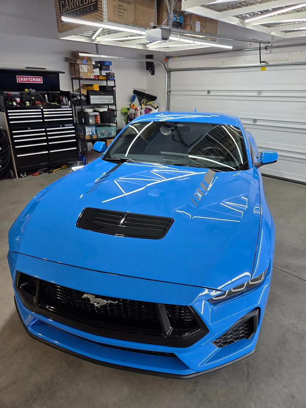

Debating between partial (front end and hood) or full PPF.
The cost difference between these options is bigger than I thought considering there’s no roof.
Does anyone with a few miles have feedback on what body panels are at risk from rock chips? Especially rear quarter panel.

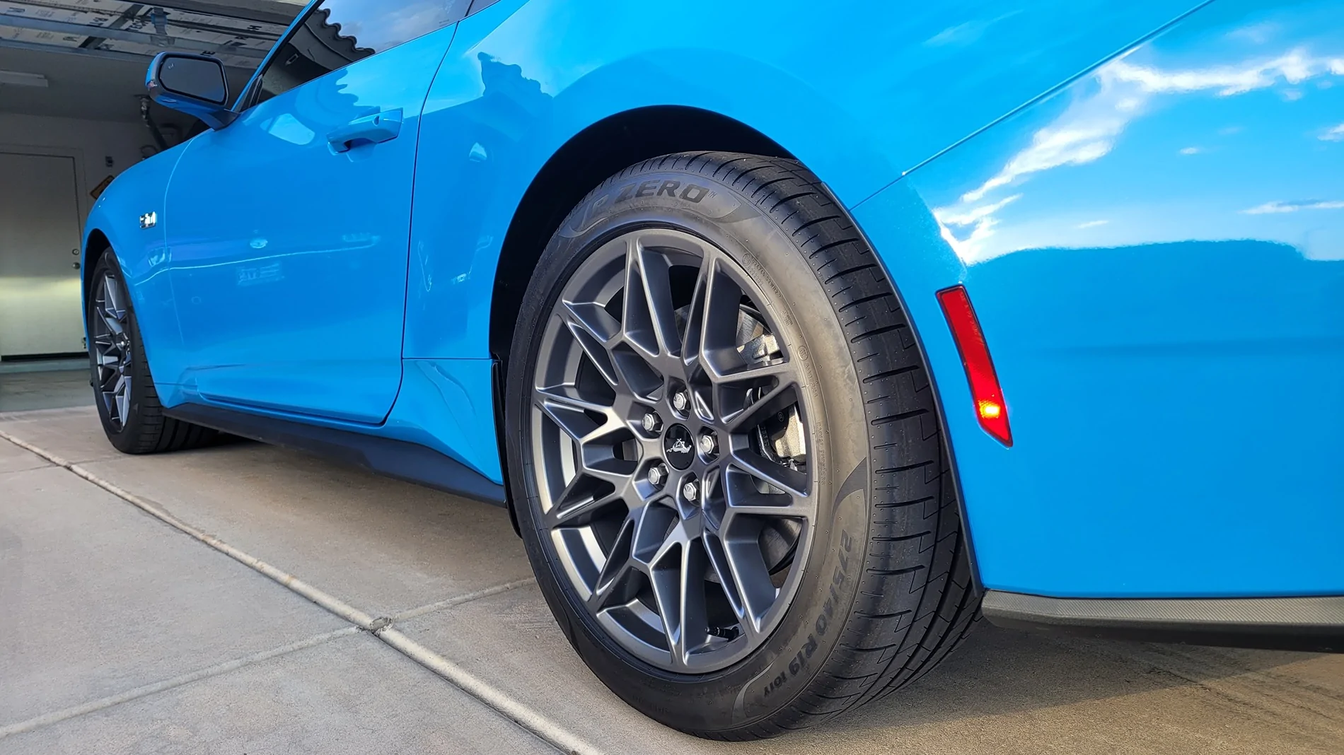

I used Anchor Room's PPF for the rear quarter panel, panel in front of the rear tire (huge rock strike area), and on the headlights. Will be wrapping the mirror caps, too, eventually. Now I live in a rural area and I keep a 5-6 second following distance from the car in front of me to mitigate rock chips on the front. I also do not daily this car. If you do and you live somewhere that had a lot of rocks I would wrap the entire front clip, leading edge of the roof, mirror caps, and rear quarter panels in front of and behind the tire. Also, get these: https://jaegerbrothersauto.com/2024-2026-mustang-splash-guards-full-set/
They mitigate a LOT of self inflicted wounds on the car. Hope this helps!

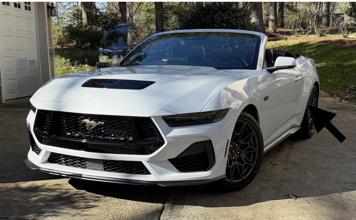

Skye has been fully-covered in PPF since 2022.
It'll be primarily the front, forward-facing areas at most risk. Those panels or surfaces that would encounter material initially, with the most force. The front grill area, hood, front fenders, A-pillars, headlights, mirror caps and the first few inches of the roof.
Afterwards, around the front and rear wheel arches, with materials picked up by the car's tires.
Finally, the rocker panel areas, the lower portion. Starting from the bottom of those panels and going up, the first 6 in/15 cm - 12 in/30cm is probably most at risk.
I'm attaching a link to a thread I posted to.
https://www.mustang6g.com/forums/threads/rock-guards-zl1-addons-vs-autofanatic.171611/
In 2025, I added front rock guards to the car. While I've been very happy with the PPF, there are a few select areas which were not covered. The addition of the flaps helped with that.
PPF gives one a lot of options, from packages to custom coverage. In what I described, you could have them PPF the front third of the vehicle, then have them lay in strips on the lower foot of the sides, front-to-back. The wheel flaps, you can shop around and install those themselves.
Edit,
When checking prices, options and what's available, ask for the brand of PPF, the thickness, how it will be installed and the warranty.
PPF is listed in "mils" (thousandths of an inch) of thickness. I'm using 10 mil, which is great for the street. Someone tracking more often or consistently would probably want something thicker.
The material can be cut on plotters or free-handed. Using a plotter and printing from a database will lead to more consistent results.
Most major brands of PPF are warrantied for 10 years against defects. If done at a shop, they should give you a warranty card or something like that, along with any receipts.
Finally, check out the shop, how and where they will install it. Before installation, they might want to polish the car, to bring out its best appearance. If the place looks like a dirt fest, all that is going to get trapped during application. They should have a clean facility, with a dedicated install area or booth, for both PPF and ceramic coatings. Stick with local shops and avoid national chains.

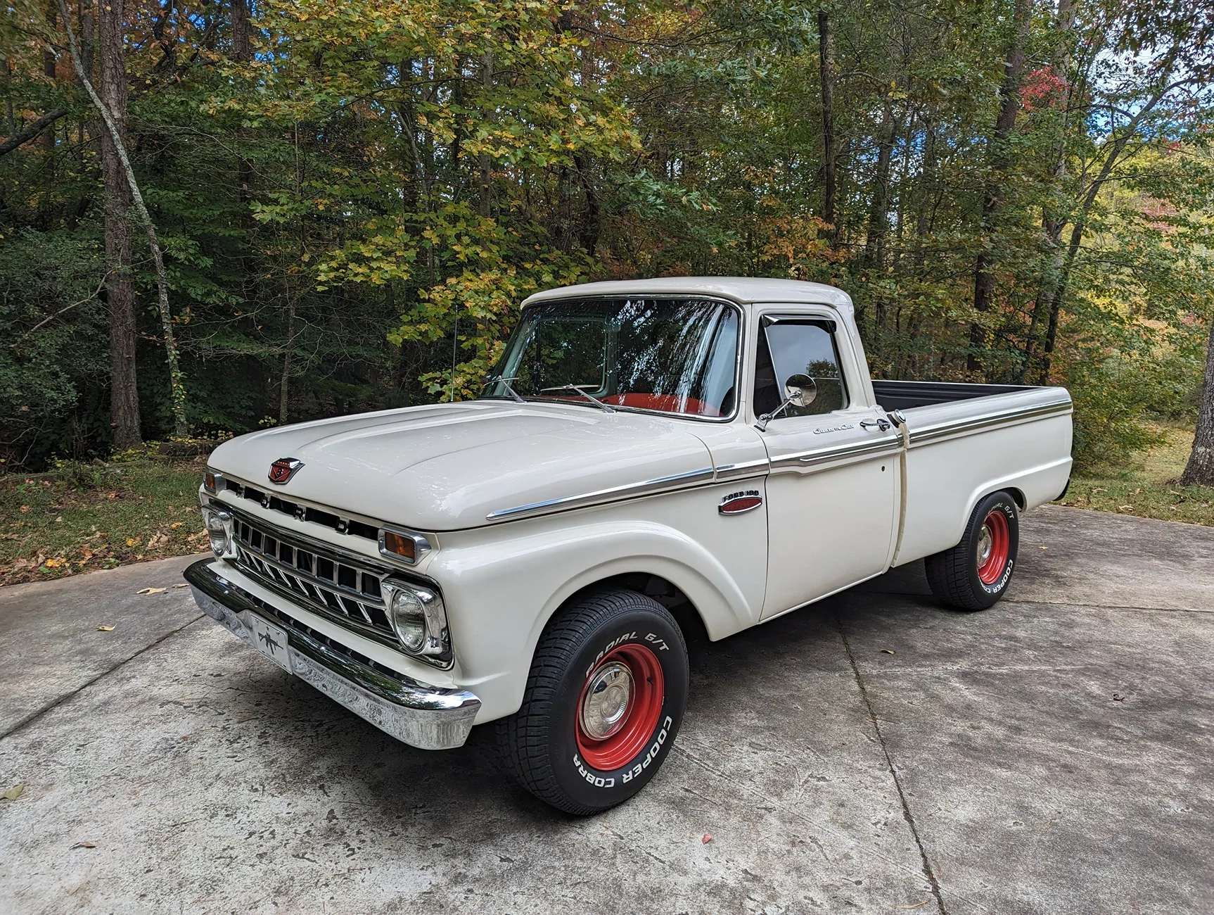

btw, love your 2nd car listed. I had a 66 F100 w/3 on the tree. Would love to have that one back.
Thank you! She gets a lot of attention and I have had more offers to buy her from me than I can count.

Gorgeous truck. Those lines just get better over time.
Mine was a stepside with a straight 6. Former SC DOT truck. Just an old truck in the early eighties...$700. Wrecked in front. My father and I pulled the front end back into shape with a come-along until I got straight parts from a junkyard and had it painted. Sold it for 4.5K in the end.
Glory days...unfortunately the only picks are polaroid's buried in the attic.
