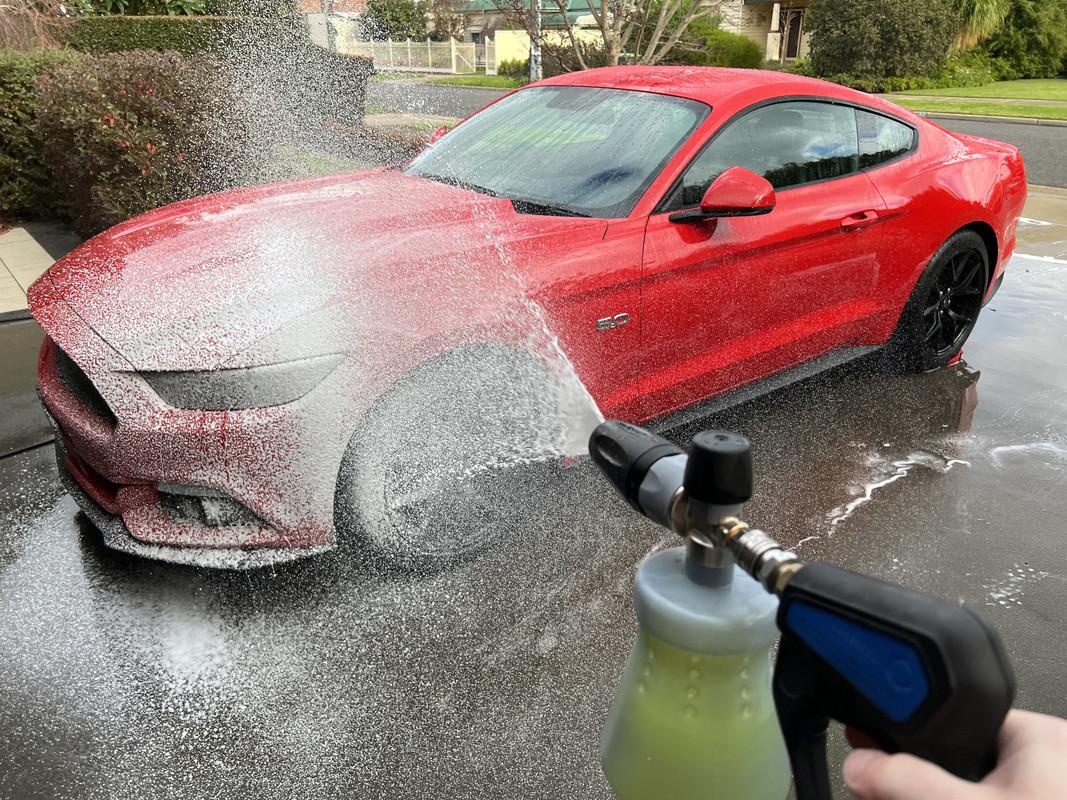

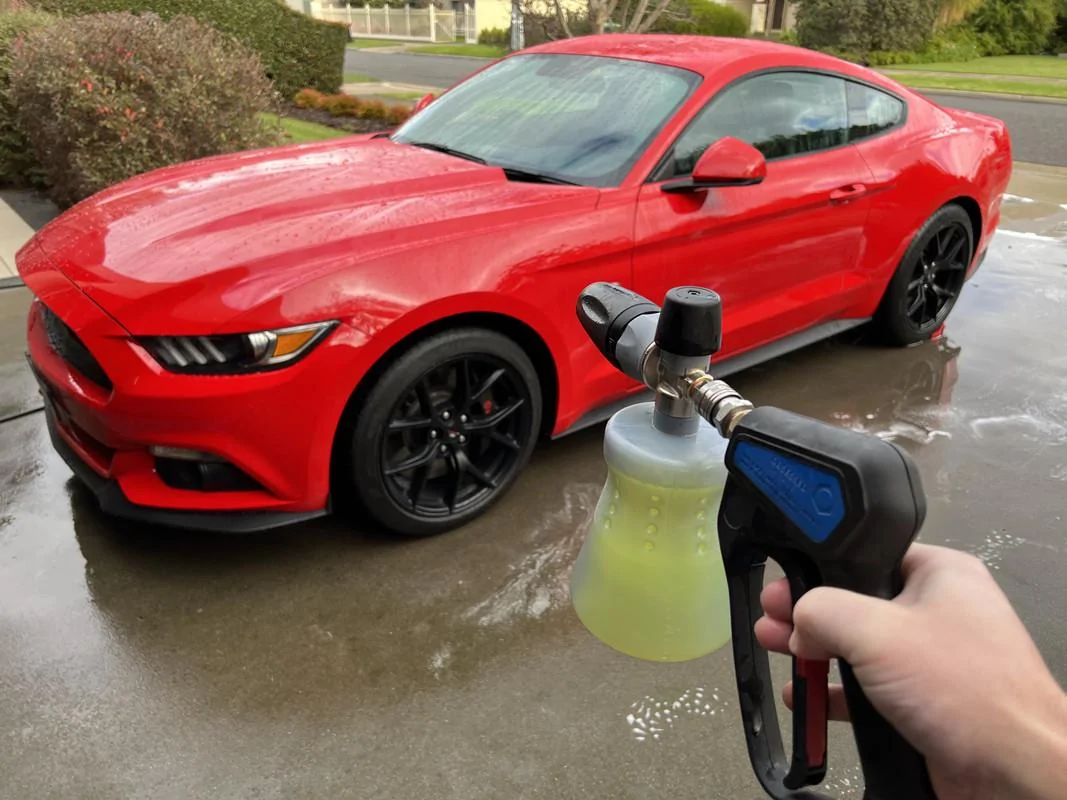

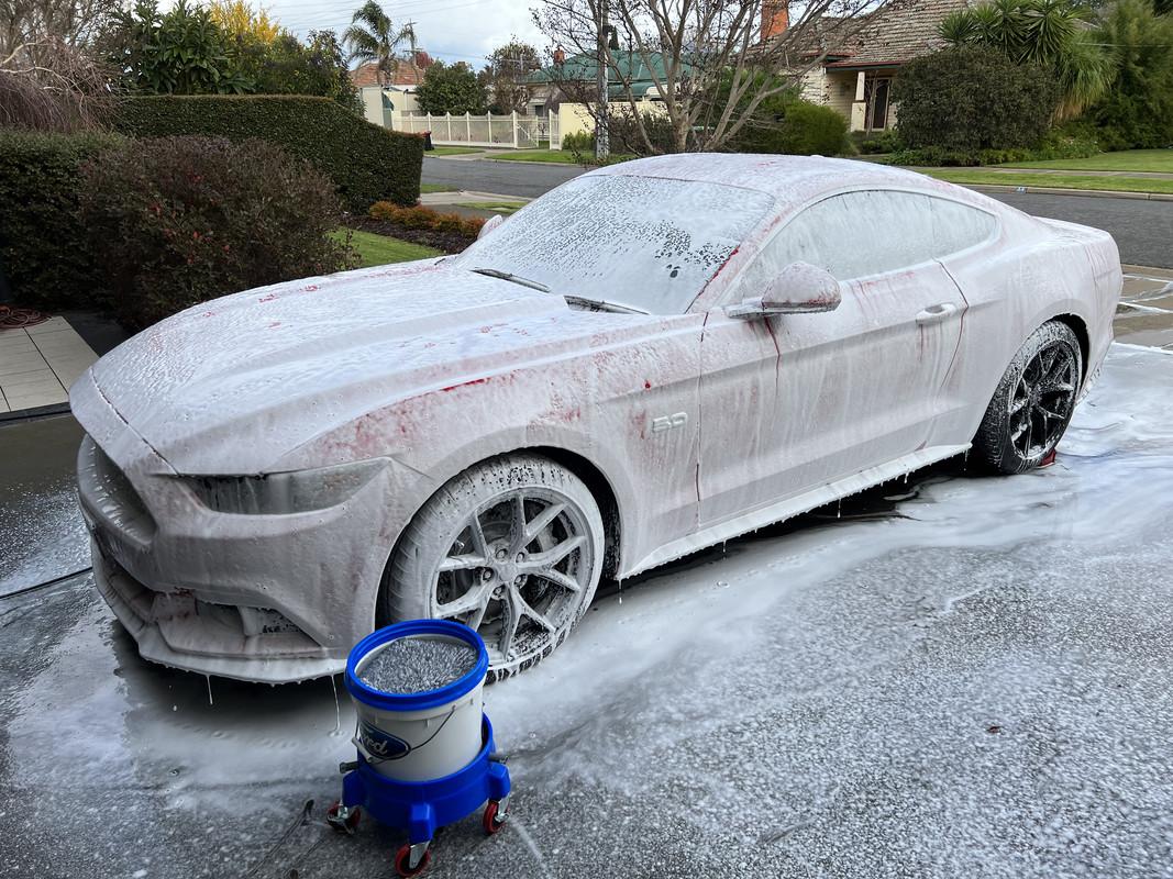

Ok, I've been procrastinating this for over a year. What is the consensus of the Foam Cannons? Do they do an OK job or pretty good. I'm not wanting to sink a lot of $$ into a Kit till I'm pretty confident it's going to do a good jog with little elbow grease. From what I've read and seen in video's, you foam the car, rinse and that's it?? Blow dry of course.
I think this is where people set themself up for disappointment with foam cannons. If the car is mealy dusty, the foam/rinse/dry method can work, but anything more and you will be left wanting.
There are very few products on the market that can perform a truly "touchless" foam and rinse washing experience, and from what I have discovered, they are best used with caution. Bilt Hamber Touchless is absolutely amazing in this regard, but you need to be very exact with your dilution ratio and account for your pressure washers' outputs. I wouldn't recommend this product if you are only new to foaming or detailing in general.
So, why use a foam cannon then? My main goal with foaming is to simply get the soap on the surface of the car rather than relying on your wash bucket solution. You won't be left wanting for lubrication this way.
Yes, in some cases, I will foam the car from dry to soak down a dirtier vehicle before the contact wash. However, I NEVER do this on my Mustang because it generally never gets that far to need this step.
For maintenance washing, I have two processes depending on how dirty the car is (keep in mind this after cleaning the wheels and exhaust tips, yes, you should be washing your exhaust tips, so many people forget this part of the car) -
Dusty to moderate -
1. Rinse the vehicle with water
2. Foam the vehicle using pH neutral soap
3. Contact wash
4. Rinse
5. Blow dry, towel dry with drying aid.
Moderate to Dirty -
1. Foam the vehicle with a alkaline leaning soap, allow to soak
2. After 5 - 10 min, rinse thoroughly
3. Foam the vehicle using pH neutral soap
4. Contact wash
5. Rinse
6. Blow dry, towel dry with drying aid.

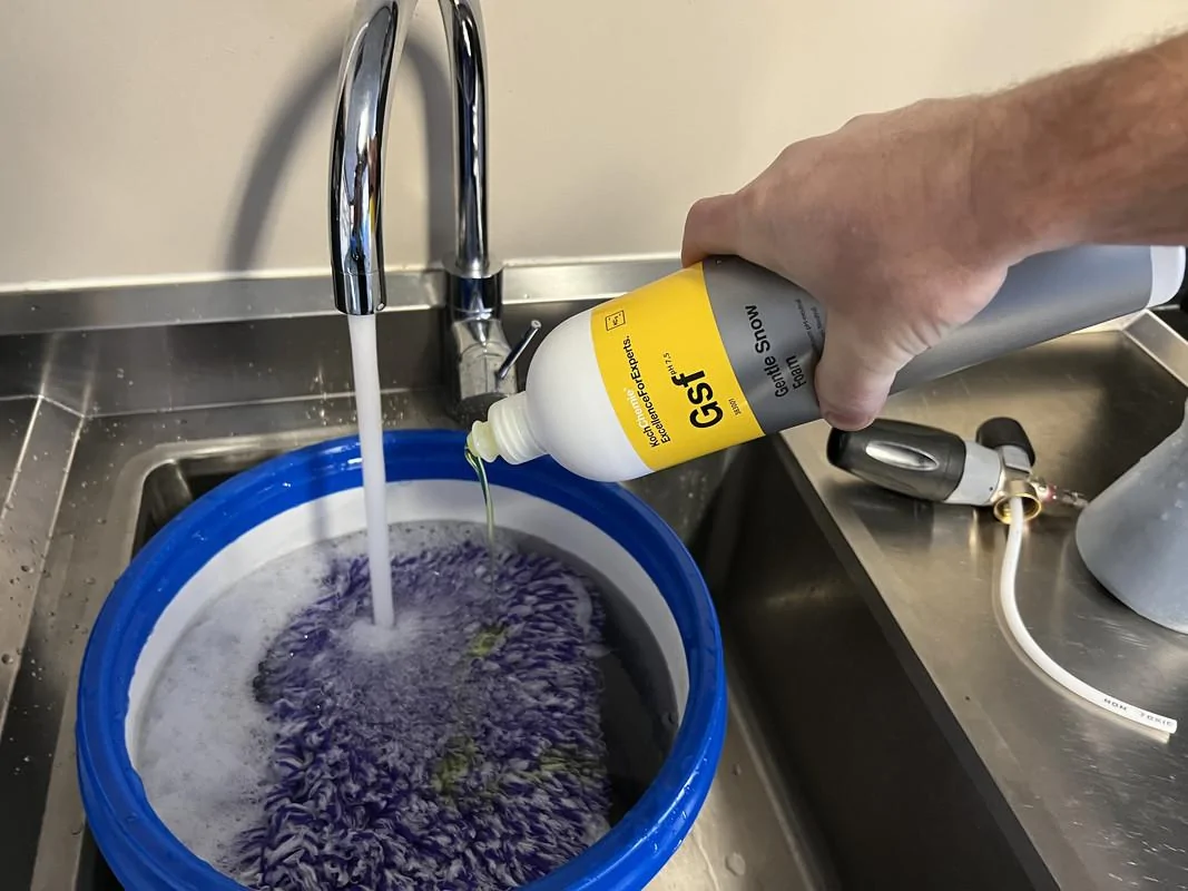

In both situations, I do not use the "two bucket wash method". Why? Because with the soap on the car via the foam cannon, you really don't need a bucket wash solution, just a rinse bucket. Having said that, I do add a slug of soap to the wash media just because I can.

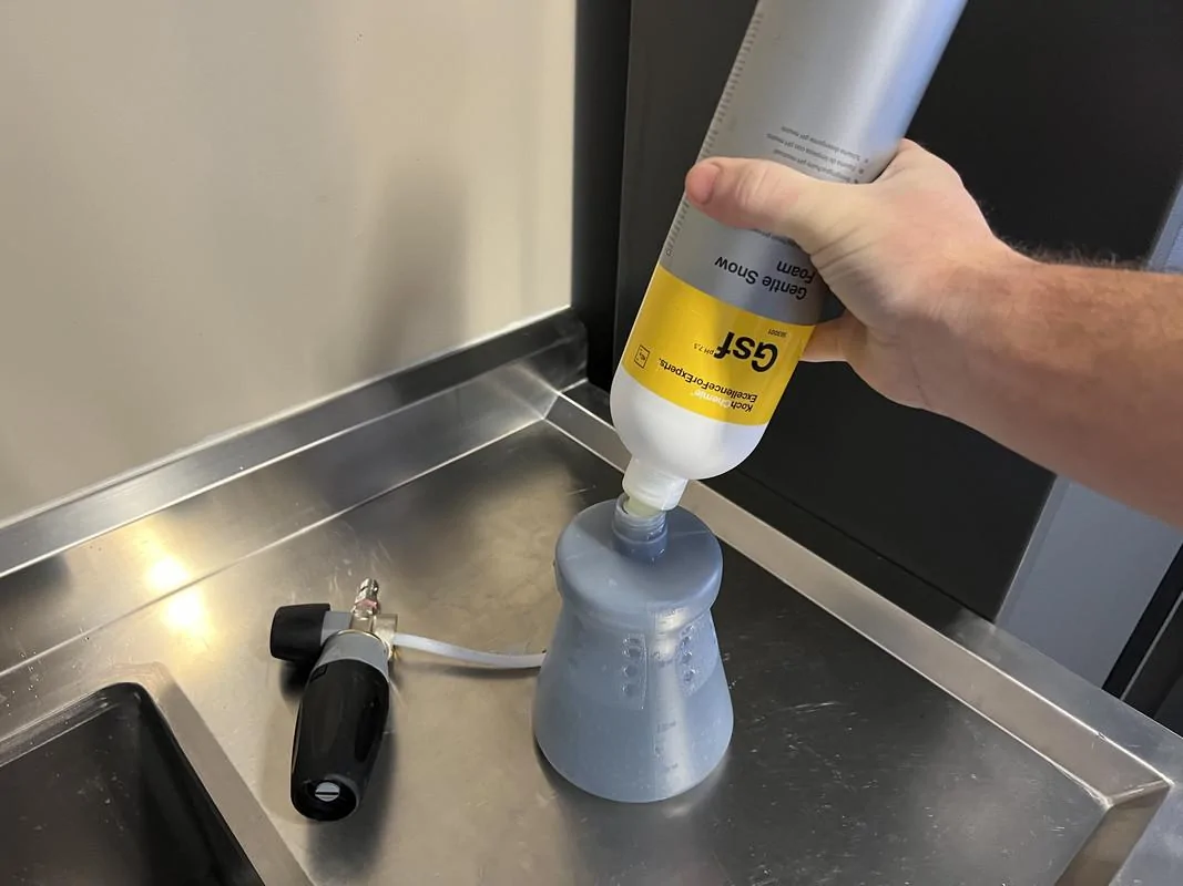

S650 Mustang Opinions or knowledge of PPF and Ceramic Coatings IMG-2810
It's always easier to fill your foam cannon with water before adding soap.
