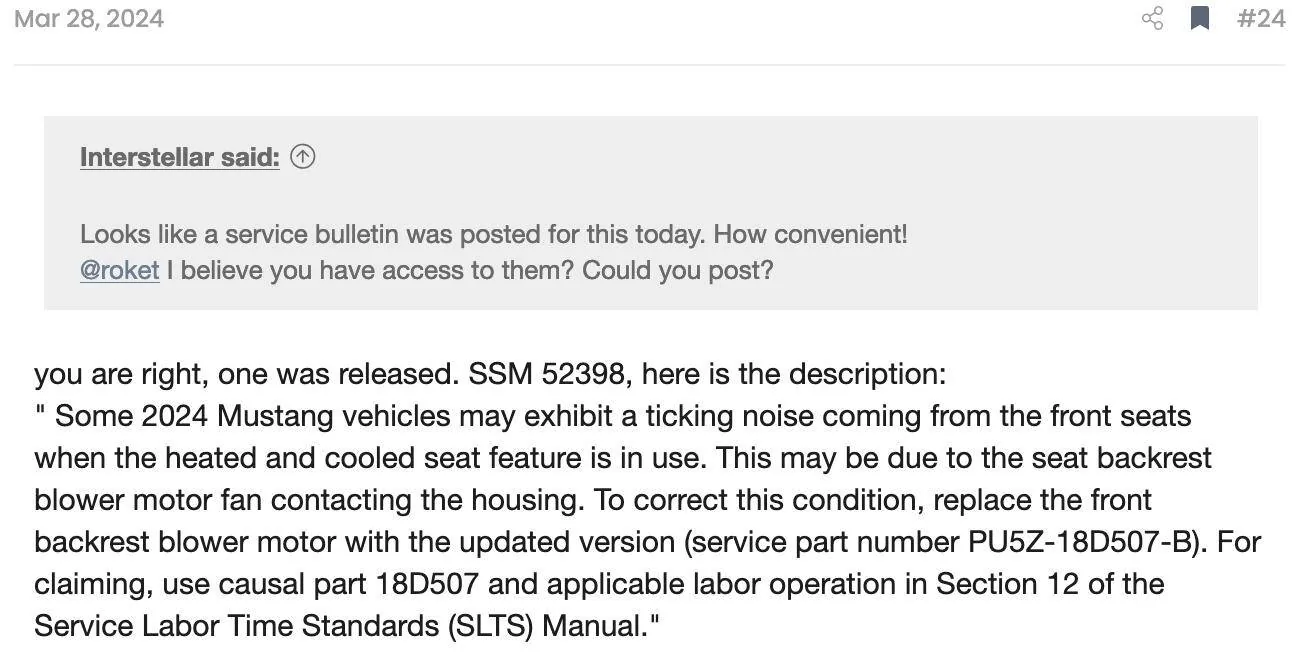

you are right, one was released. SSM 52398, here is the description:
" Some 2024 Mustang vehicles may exhibit a ticking noise coming from the front seats when the heated and cooled seat feature is in use. This may be due to the seat backrest blower motor fan contacting the housing. To correct this condition, replace the front backrest blower motor with the updated version (service part number PU5Z-18D507-B). For claiming, use causal part 18D507 and applicable labor operation in Section 12 of the Service Labor Time Standards (SLTS) Manual."
Thank you for posting this information!
I’m at the dealer, and although nothing comes up related to my VIN #, when I gave them the service bulletin number SSM 52398, they were able to look it up and order two replacements for my front seats.
They’ll call me to set up an appointment to install them when the parts come in.

My very responsive and nice service manager ordered the parts for both seats when I showed him the screenshot from this thread. The parts came in, but I've been out of town. I'm scheduled for December 8th to have the new parts installed.
Show this to your service manager jerk and demand that the parts be ordered.
