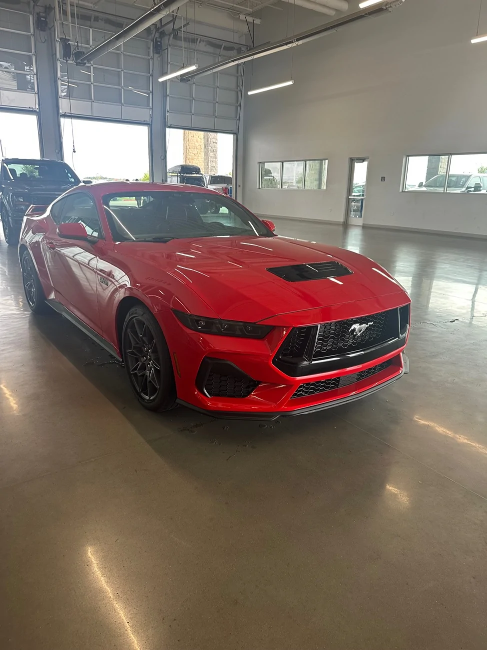

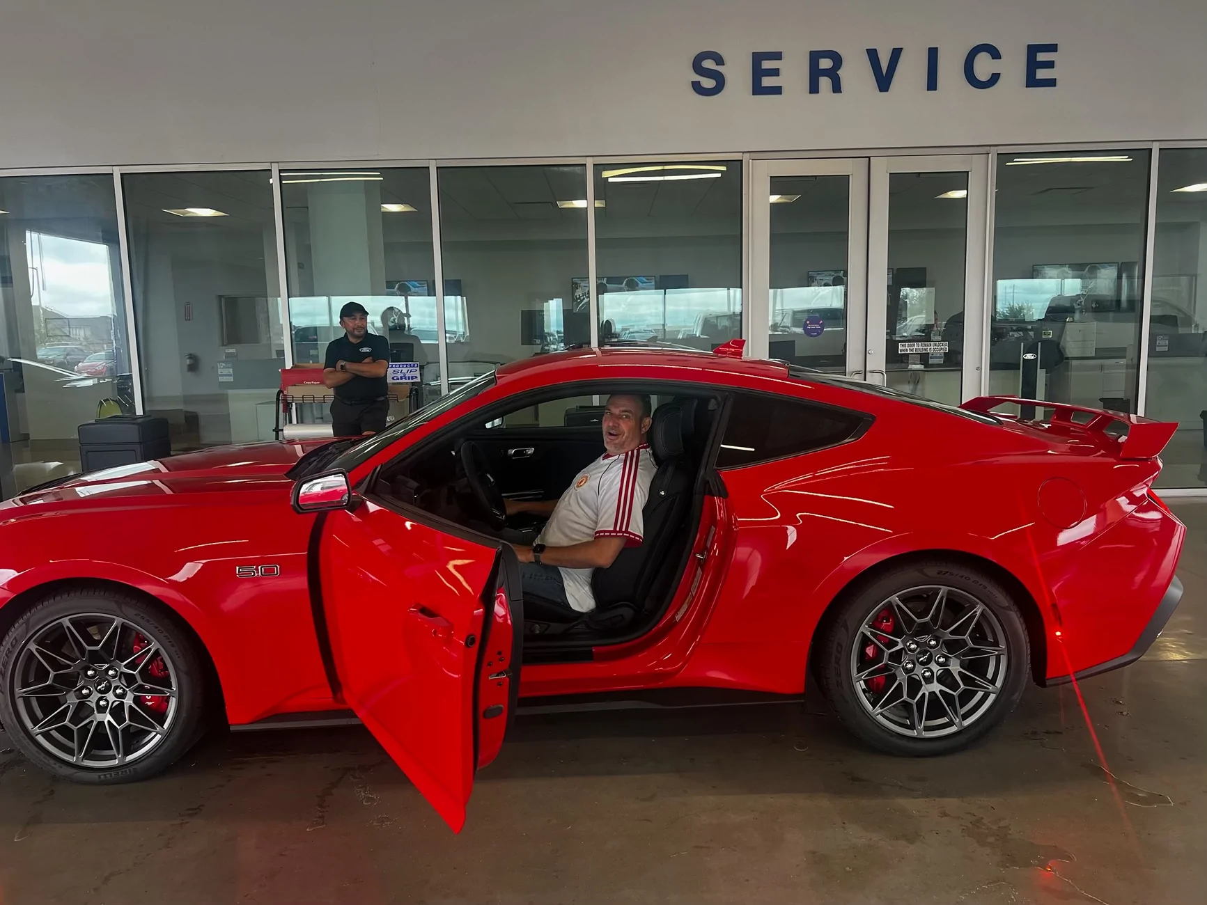

I went to visit her in jail today 🤦‍♂️🤣

@Stanzi ..... beautiful Mustang. The red Brembos look great with the body color. Why didn't you just pull a "gone in 60 seconds" - they wouldn't be able to catch you! :cool:
thanks man… I’m beyond excited to get it. 🤣 I drove around the parking lot: we know the GM of the store personally as well as several of the management there. They offered to let me drive it further - I just didn’t want to get them in trouble. That little devil on my shoulder? 😈 Bye Y’all!
To be honest, they had a Vapor Blue 300A Manual with zero options that hadn’t hit the recall list yet. I almost asked them to let me look at it.
I just couldn’t. After seeing her again- sexy as hell and I’m not a red car guy, but the Performance Pack with Active Exhaust and 301A is just the right package.
we are going to add the Katzkin leather and it’ll be perfect.
im hoping it will be fixed and there will be more rebate at that time.
luckily my son works for a ford dealership so we get D-Plan plus Rebate
