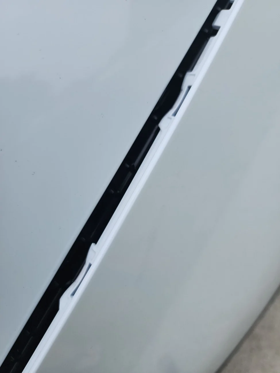

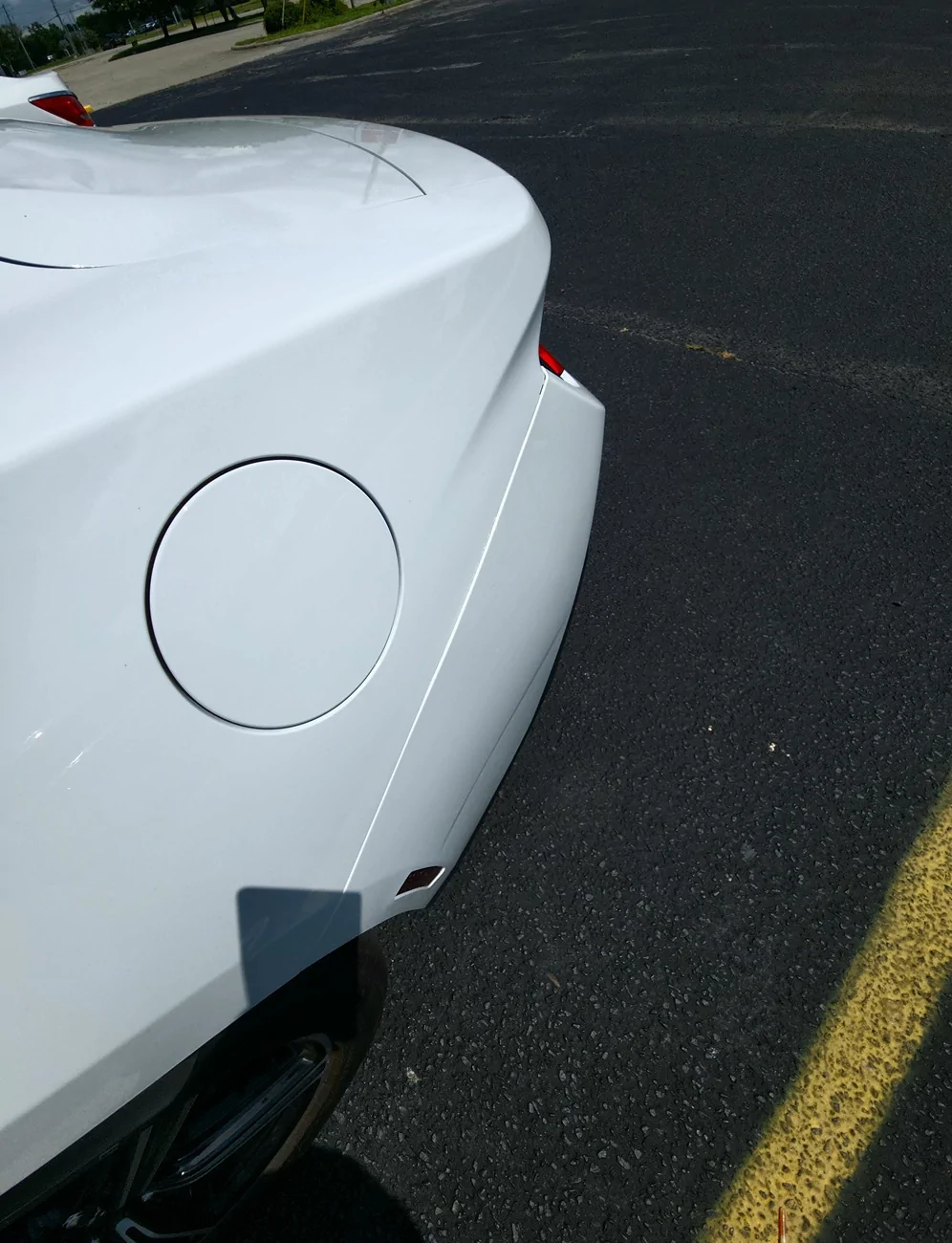

Can you elaborate on the bumper? I think I have the same issue.
I didn't catch it initially, but when I was looking at the body lines I eventually saw it. Second Pic shows how the tabs weren't installed properly. No damage to indicate this was post build. I just popped em all back out, straightened the tabs and reinstalled.

Thats exactly my problem. How did you losen the bumper to get the tabs in? I saw a video where basically you had to take the whole bumper off and re-hang it.
I just pulled it out by hand, it's only held on by those tabs. It's been almost a year though since I did it.... I can't remember the exact details but it took me 5 minutes in the parking lot.
I just googled it and found a TSB on it. Is yours an early 2024 car?

Nope, mines a 25. Built around the first of the year.

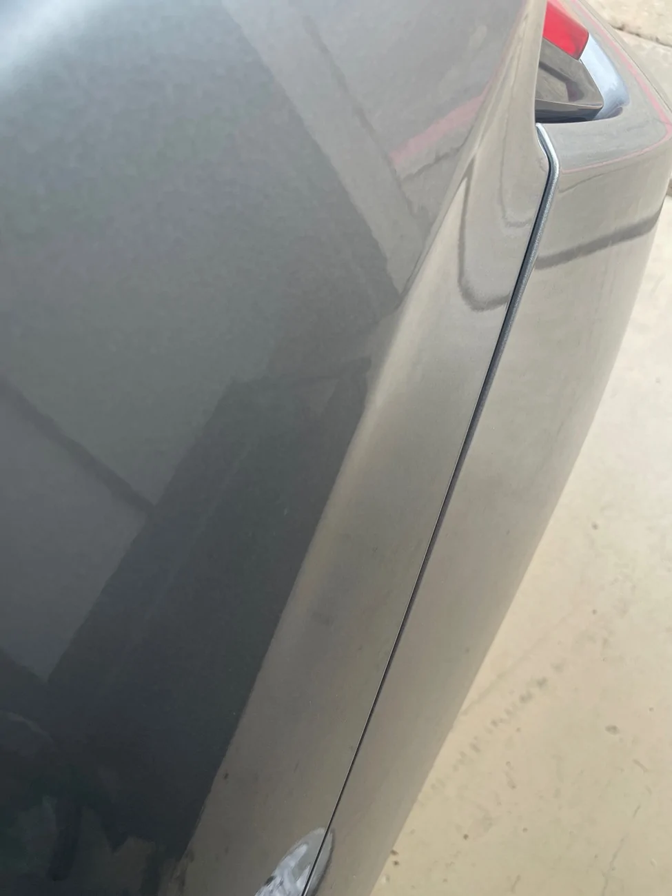

pinto
Oct 23, 2025
‘26 Mustang GT Premium - Iconic Silver
S650 Mustang My take on the initial build quality. IMG_5475
I think I may also have the rear bumper issue. I noticed after 2k miles it start to separate a few millimeters near the taillight.
I also started to hear excessive creaking near the trunk. I wrapped tape around the rear seat hooks as another post suggested but no luck.
