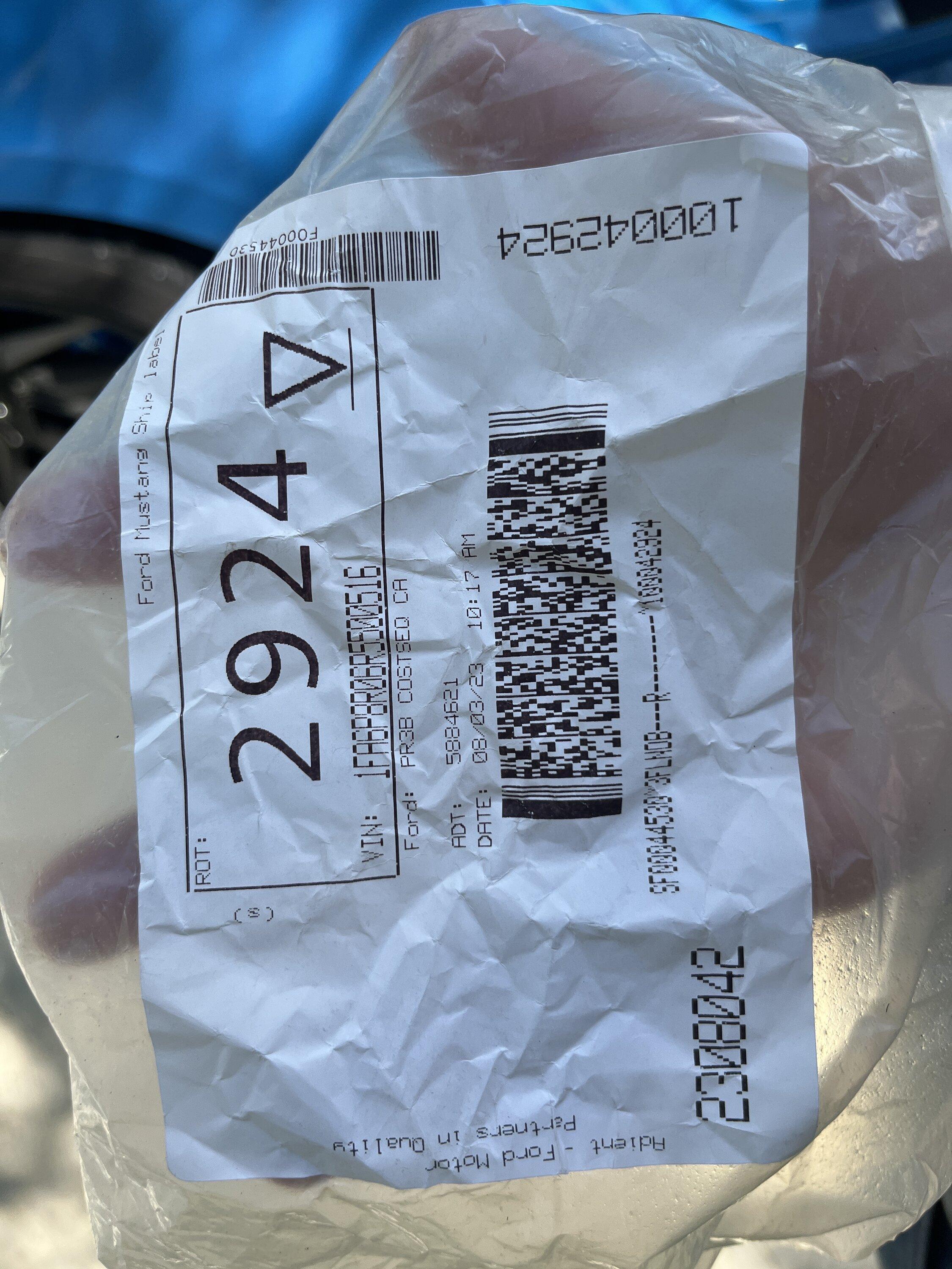

If they don’t look into the plastic bags they come in the only way to tell is a like 4ā€-6ā€ sticker to be fair.
Aight I got to PDI my own car and took a look at the bag and THERES A VIN ON IT. so maybe it was a fuck up by supply? That or whoever put the stickers on. Thinking Adient since it says on therešŸ˜‚

Seats are interesting… the passenger seat is put in 100 yards down the line from the rears and the driver seat.
So they got out of sequence, imagine a conveyer of hundreds of seats… multiple conveyors actually and they are sequenced to hit the car in the correct order hundreds of feet apart.
Now if for a second the line stopped or it somehow got out of sequence… but rarely if ever can that happen
But in a new launch… they may have actually been out of seats or waiting on recaros shipment… so the build the car to keep it moving and mark it to manually get the seats later on rework.
Just giving ideas of how this could happen … most likely it was offline repair work.
Don't forget that seat are wrapped with plastic, therefore, material handling operator cannot see the seat, they only see part number or just scan a bar code. In any case, I would blame the seat company supplier for placing the wrong bar code on that seat. No final assembly line.
