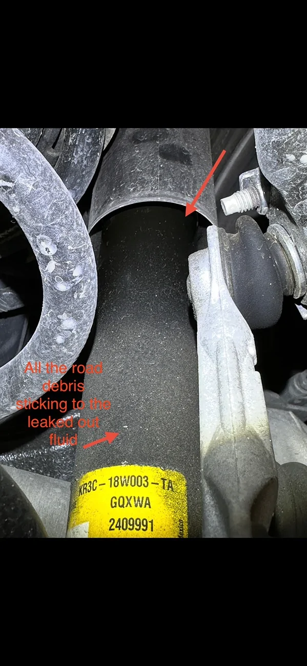

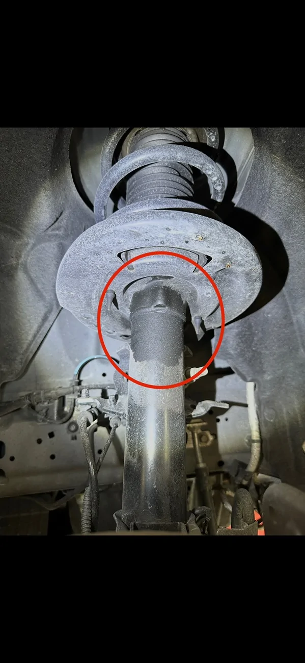

I noticed today that my 2024 Dark Horse driver front strut and passenger rear shock are leaking. The car only has 8,000 miles and they’re already leaking which just amazes me. Rear shock looks like it’s been leaking for a while and the front strut is just starting to leak. I don’t know if I should take it in for warranty or just replace them myself out of pocket. Is there any programming required after replacement? I did see a post regarding noise concerns with Magneride but nothing about leaky shocks.

The rear shocks are considered a wear item, so you might need to be within 1yr and 12000 miles (obviously you’re good on the second). I say that because they are one of the few things not covered under Ford ESP‘s PremiumCare plan. Hopefully I’m wrong they are covered under 3/36; dealer can tell you. But even if not covered, there could be something else going on under there that is covered. If so, then labor would be covered. At least having them looked at should cost you nothing.
The front struts are considered suspension, so you are good there.
Struts are not a simple swap. And you will need alignment checked after doing them.
Have you noticed any change in the ride, since new?
I have a new-to-me ‘19 GT350 and the rear shocks are leaking. I see no difference when changing the suspension choices, so thinking that is why.
