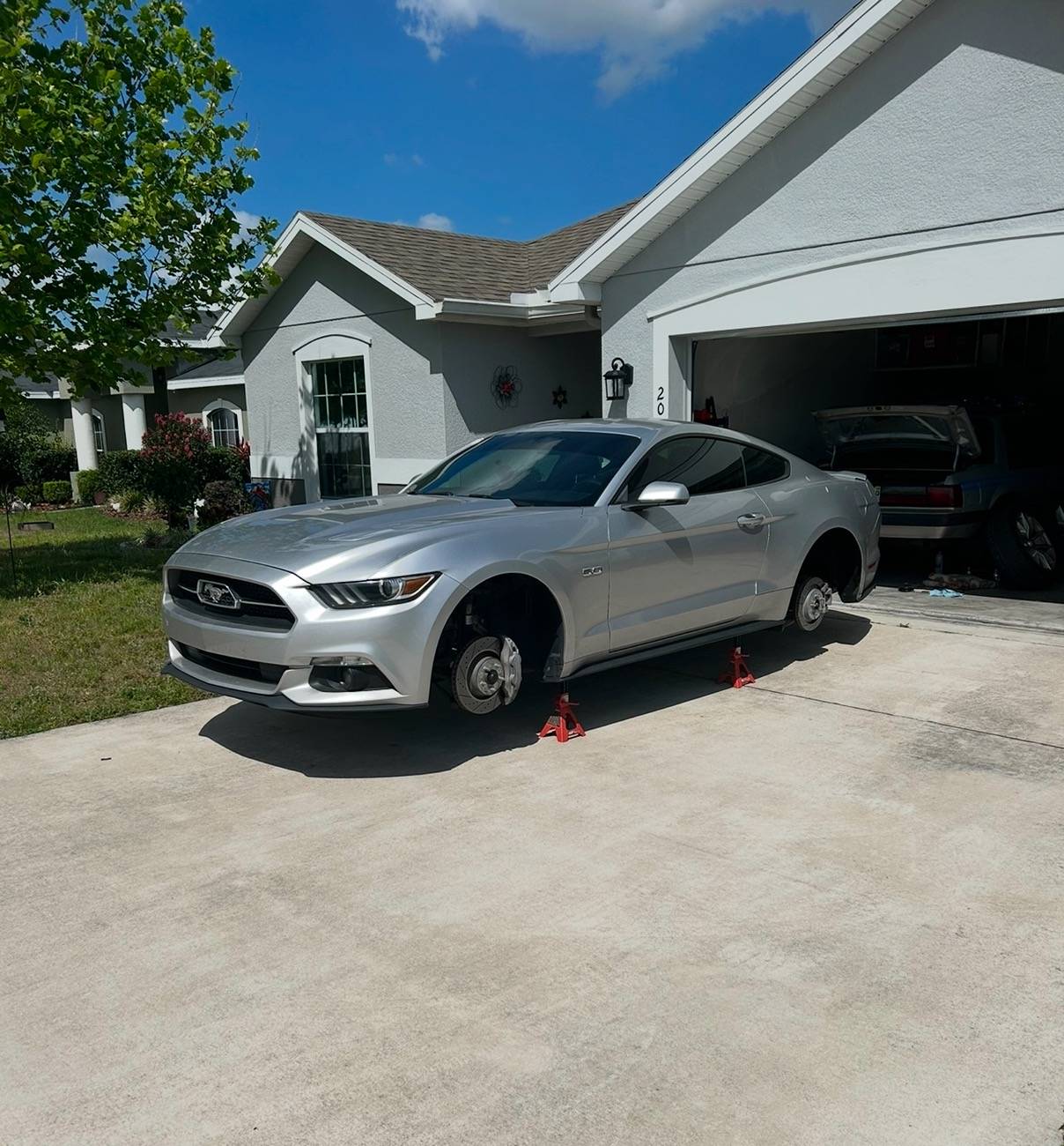

You use your jack rails for your jack stands as well? Didn't think that was recommended due to being too close together in the centre of the car?
89Trooper
Aug 19, 2014
1,242
266
Central Florida
I do it alllllll the time (with the non-full length ones). No issues at all.
I can’t find the pic of the new car, but here’s the old one sitting on four jack stands (same jacking rails):

Thanks for the demo lol I've got a driveway shared with a neighbor who parks his pop top camper trailer up by his side of the garage then his F150 behind it so side angle access is a little more restricted than I would like.
I can jack from the back under the diff no problem but the front is a little more challenging due to the belly pan covers.
