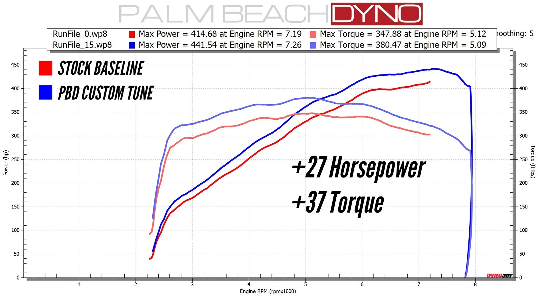

As far as I know stock. There is a you tube video out there with the actual test. This is about what I would have expected and that torque will be very noticeable on a daily driver.
