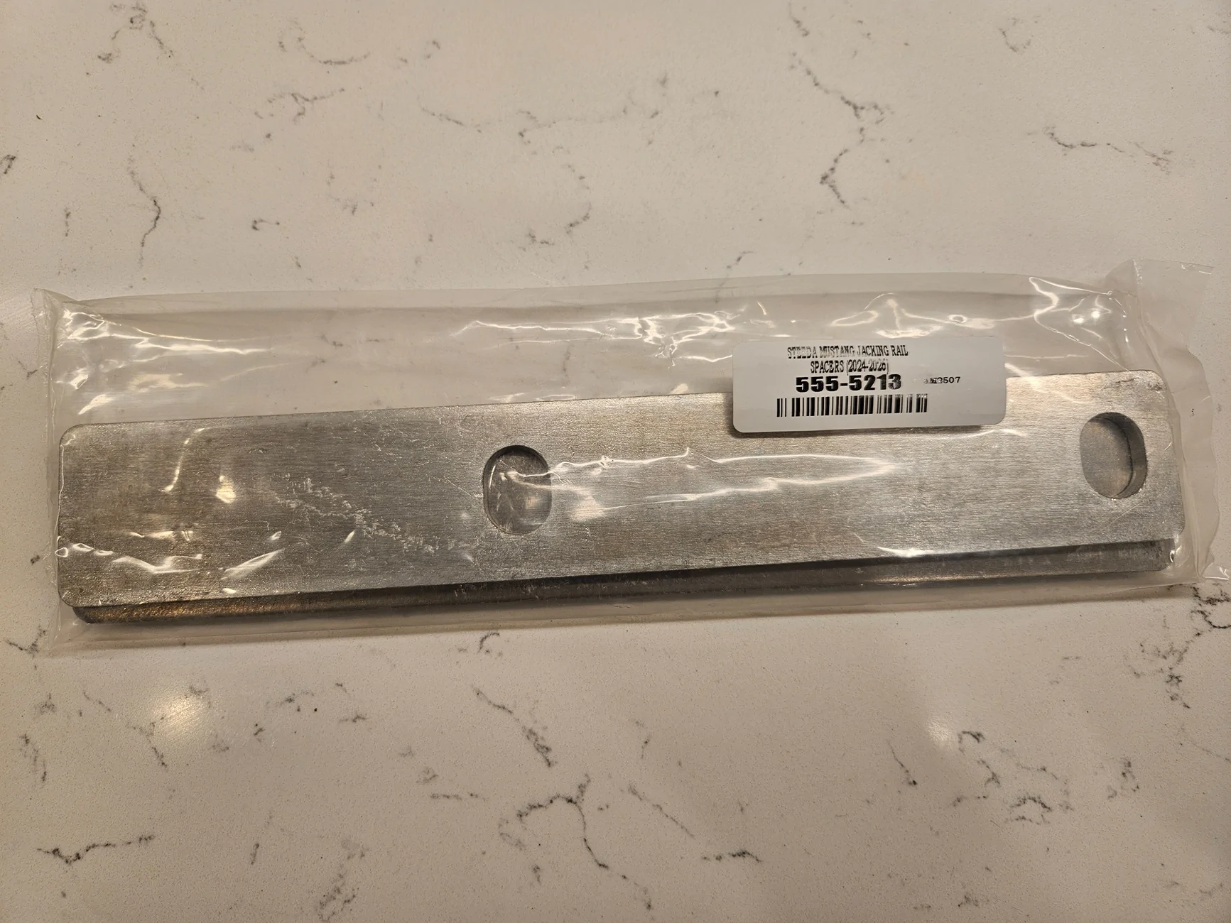

Steeda part #555-5213
It was $31 after shipping and tax, I'm not obsessed with trying to get stuff for free. Steeda is a good company and I'd rather them stay in business.
[email protected] should be able to order them for you

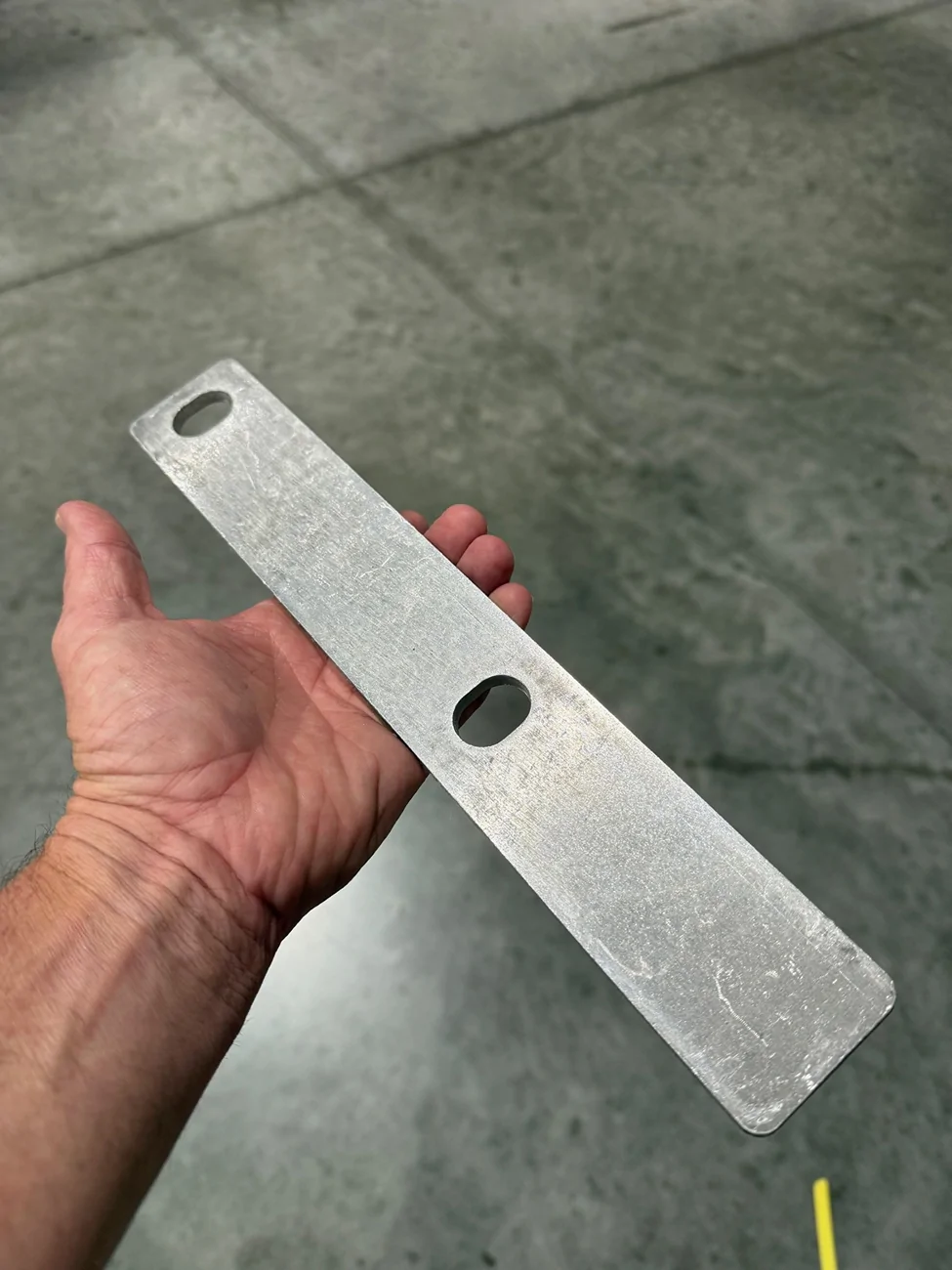

For those wanting a photo - here is the plate:

1/4" thick, 2" wide, 12-3/8" long aluminum. Slots are 3/4" by 1" and they are 4-7/8" and 11-5/8" on center from the end. Easy to make if you don't want to spend $30.
