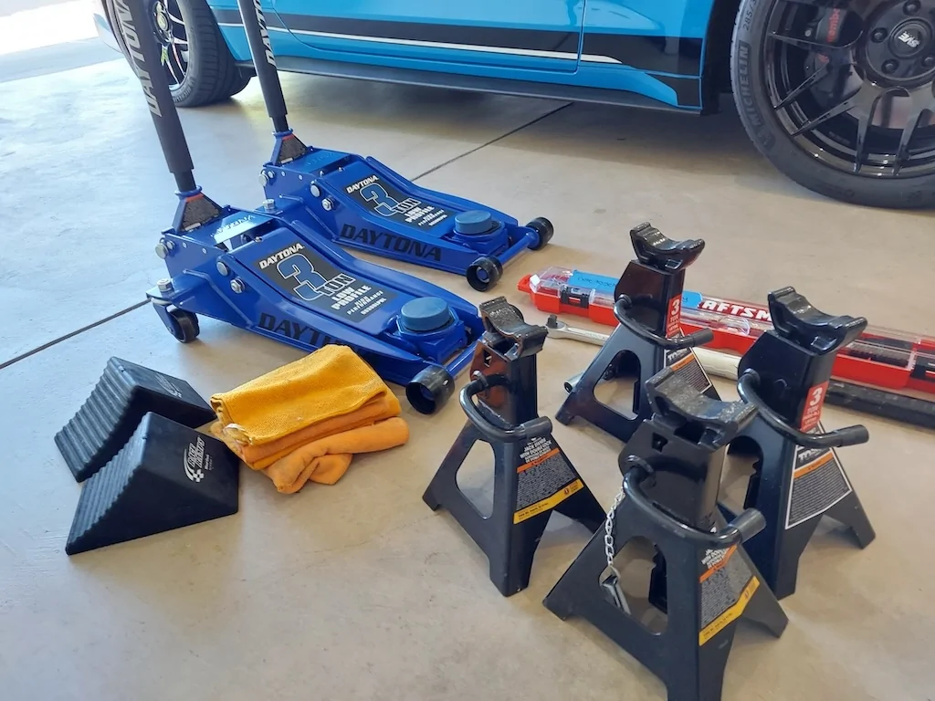

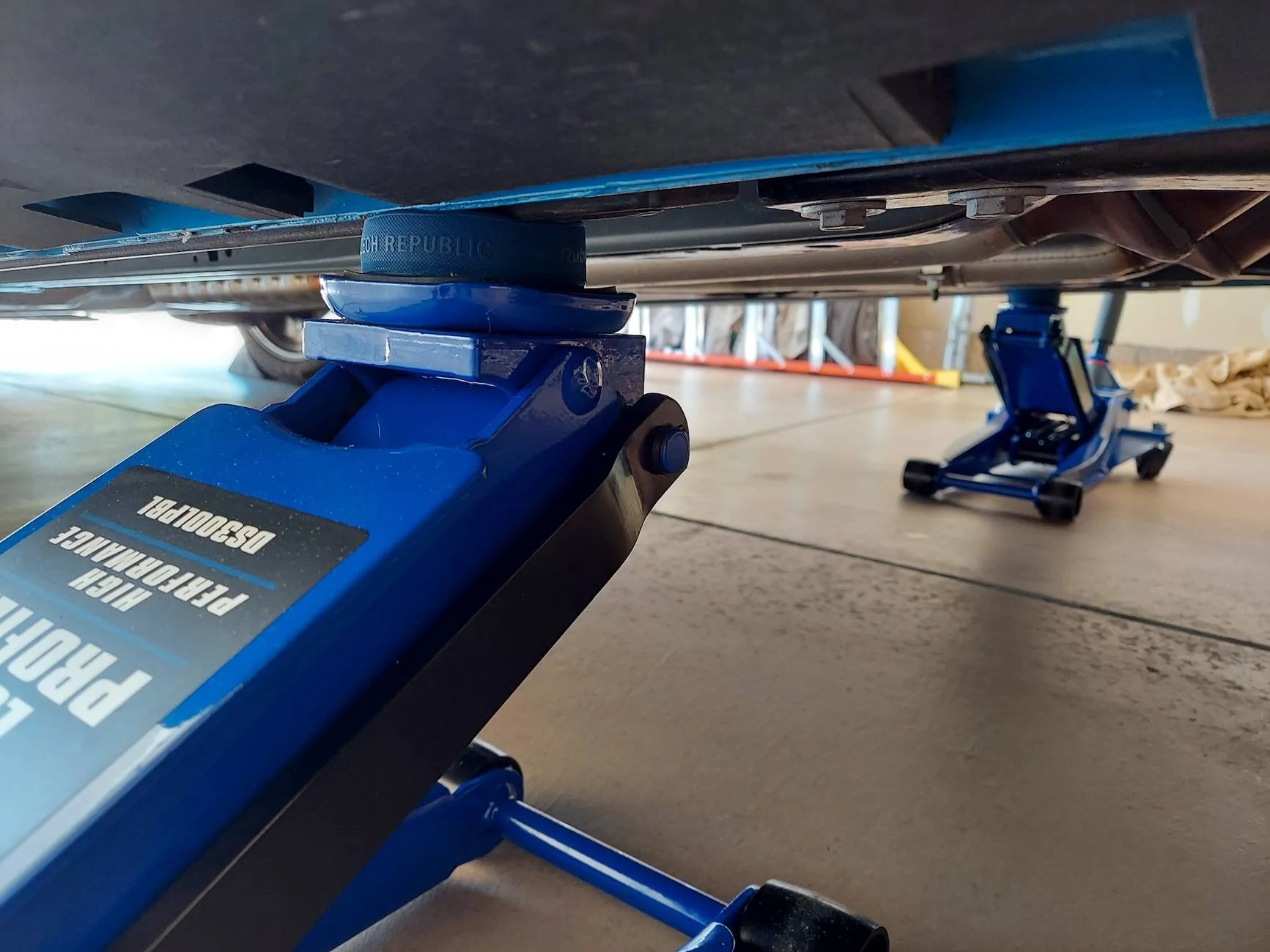

I use the Daytona low profile 3 ton jack with a urethane puck on top.
The puck goes up against the jacking rails and protects from scratching. Before I installed jacking rails, I used the slits in a smaller urethane puck to align under the pinch weld.
If you intend to use a floor jack for regular maintenance, jacking rails will make your life 100 times easier. And they are fairly inexpensive.

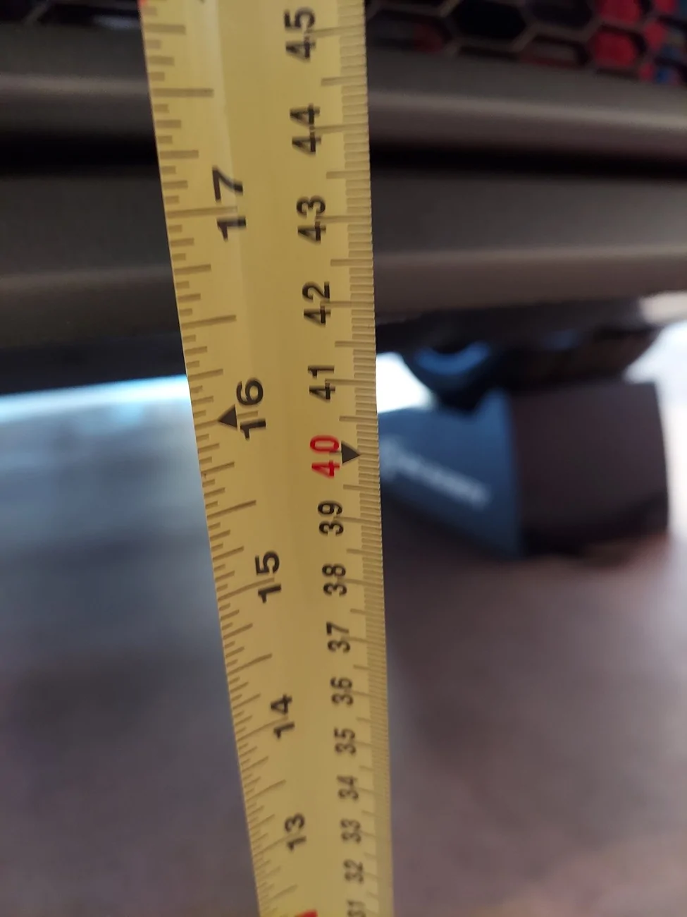

The basic conundrum is if you don't have rails and jack up the car via the pinch welds, where do you place the jack stands?
1,764
2,775
≈39N
I use the same. :thumbsup:
To the OP, the Daytona is an all-steel jack. It's built to last and comes highly rated. If needing a jack for the road or track, I'd select something else, like an aluminum or an aluminum/steel piece. These would not be as robust, but they'd be easier to move, around, in and out of the car.
Edit,

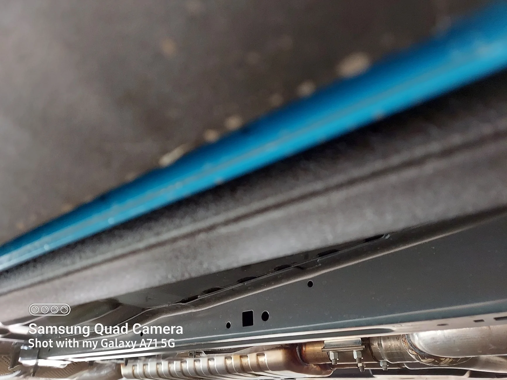

Regarding the pinch weld points, the best long-term solution is jacking rails. It's an easy mod.
Left screwed into the car are a series of bolts in the unibody. These bolts are used to hold the car in a carriage as it moves down the line. Being a one-time use, safety piece, they are left with the car.
To install the rails, the bolts are removed with simple hand tools, the rails bolted in their place. Now, you can jack up anywhere along the rail, versus one or two places designated underneath.
You can just make them out in the photo immediately below. Instead of jacking where the cutouts are in the rocker panel skirt, I'm underneath the rail. The unibody seam is level with the rail; there is no damage.
For tools in-general, I'd go slow at first and buy what you need. There are some great sets out there, from budget to expen$$$ive. Everyone is going to have a sweet spot for the amount of their expertise and level they're operating at.

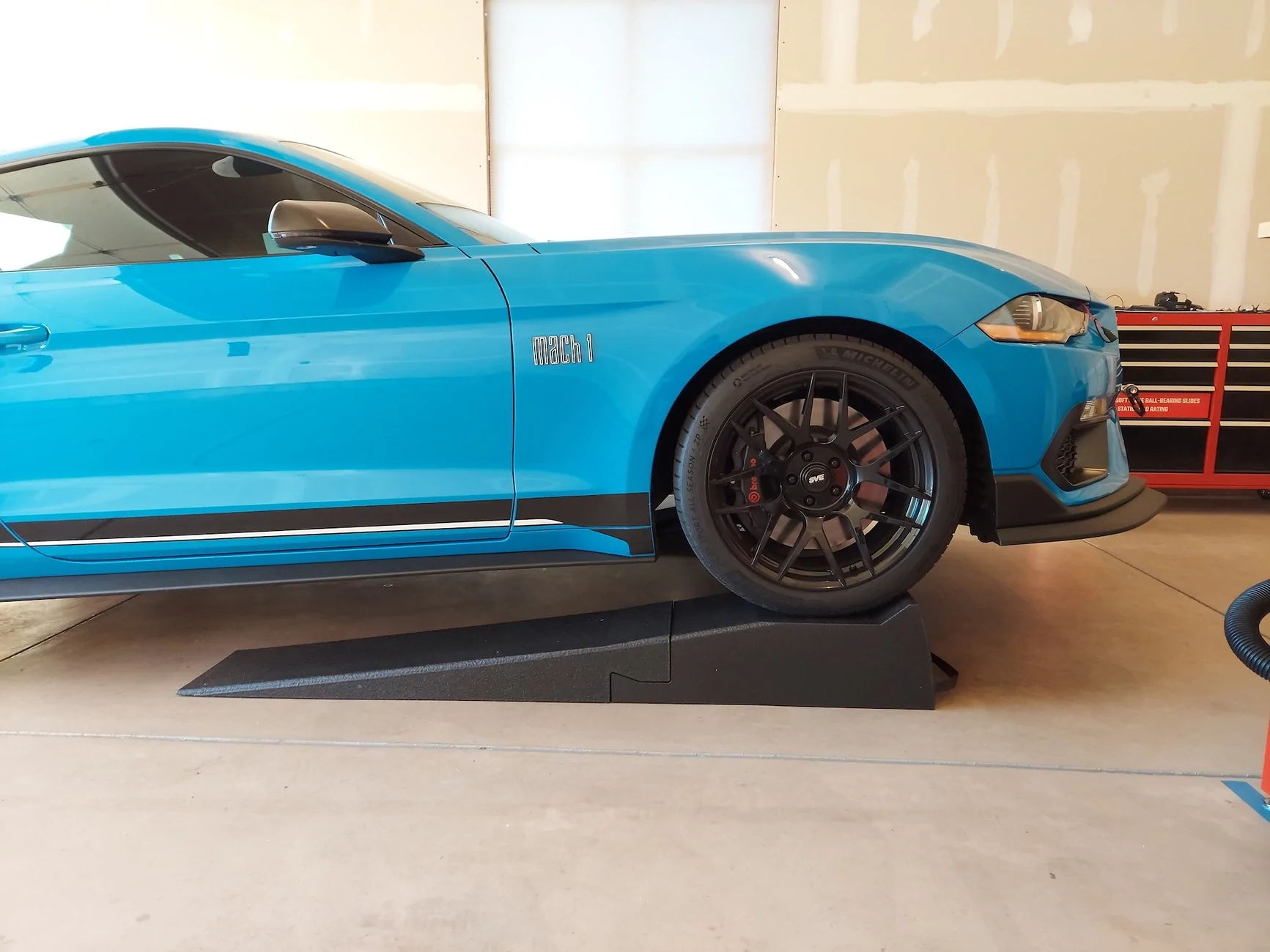

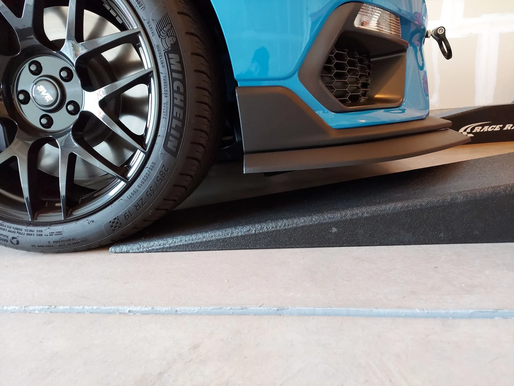

I've been using a set sold by Race Ramps for the last few years. Light. Easy to maneuver. Four years of use, they continue to look new. The set I'm referencing have a 7-degree up angle, safe for the Mach 1 HP. I'd think they'd clear the DH as well.
