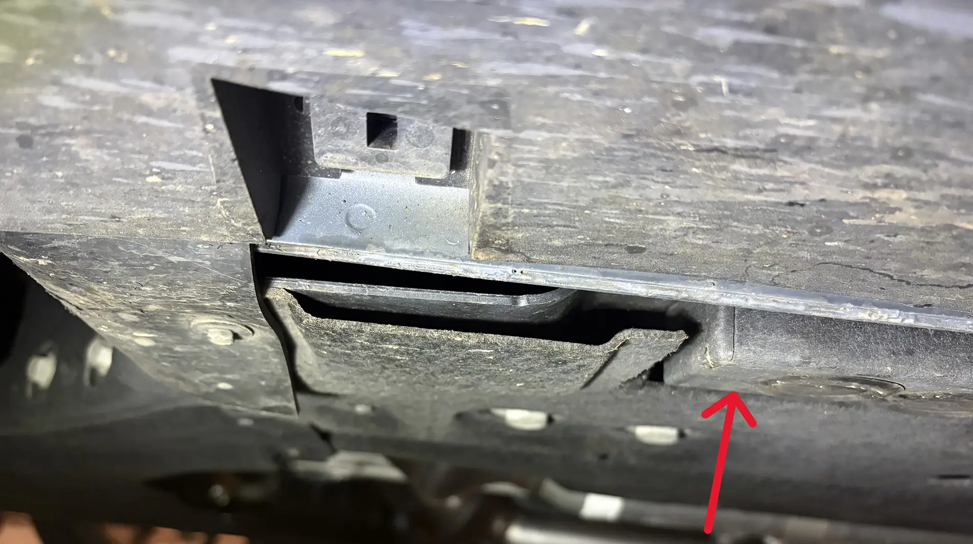

The front picture is here ... jacking rail is the the right.
This is the Steeda Ultra-Lite Jacking Rails / SDA-555-5212

There's plenty of room in the back near the pinch weld. Front too.
That doesn't appear to be the jacking location... it is wider than that. Thanks though.
rijndael
Oct 24, 2024
280
250
VA
2024 GT
The jack works there. I've used it. It fits right up against the rail.
