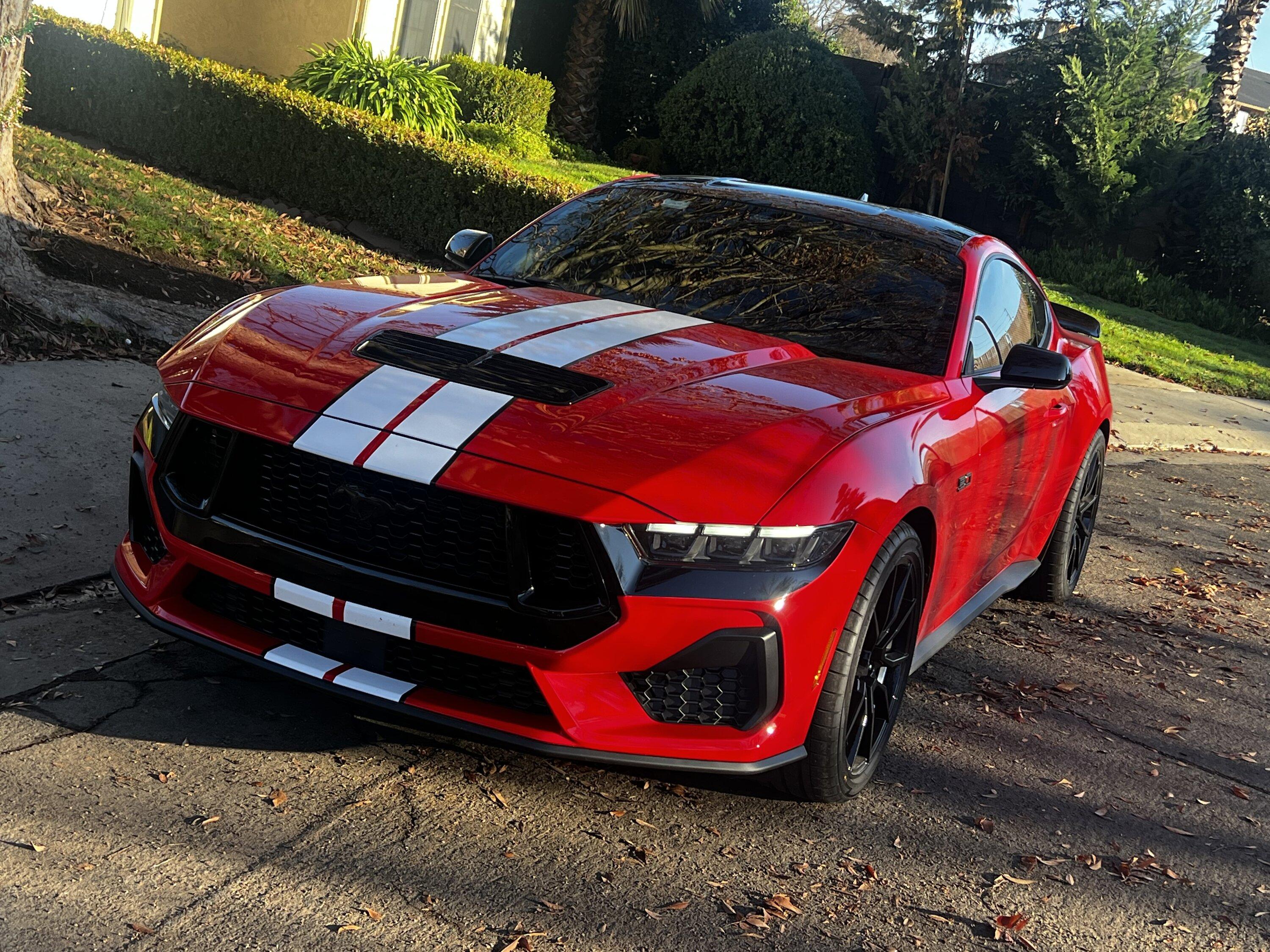

I have a 2024 mustang GT premium I was one of the first guys to get it delivered back on August 2023. My vehicle only has 5100 miles and I have major issues they’re very replaced the CarPlay module and the front and collision parts on the beginning of September 2023, because the Apple CarPlay used to disconnect or not playing any music now I’m having the same exact issue all over again.
The issue is the collection system it constantly shows orange when nothing is blocking it in the car is freshly washed
also, the brakes squeak and when I’m stopped, or I’m trying to turn, it, sounds like the suspension is squeaking or the steering wheel
Lastly, when I drive pretty fast, anything over 100 mph, the vehicle seems to go left and right left and right almost like it’s loosing control or when I’m doing a turn at over 60 mph, which a car like this should not be doing that not even my Honda does that

You have a nice looking Mustang.
The squeaky brakes may be due to brake dust?
Maybe power wash the brakes?

My car also has collision system problems but it only happens every single time I remote start the car

there is a TSB for this, make an appointment at your local ford dealership for a update to the computer. it will be fixed.

go get a correct alignment. And just disable that collision warning system. All you need is keep your eyes open and brain engaged.

Can you send over a message with your VIN and the name/location of your local Ford dealer? I would like to take a closer look at your concerns on my end.

I have seen pre-collision being disabled as well. So far when there is rain, or when it's very cold outside (below freezing). It usually clears up by itself within minutes. I suspect this is because the front camera is fogged up, or there's some kind of an obstruction (snow, water).

Sounds like wheels may need to be re-aligned. Also what kind of a steering mode do you use? If it's the "feather" one, the wheels are a lot easier to turn.

I have had similar issues, I would suggest making sure the wheels are properly balanced and the car is properly aligned. In regards to the collision system, ever since I got the car in October it doesn’t work when I remote start the car, I heard I could go to the dealer but it doesn’t bother me that much, eventually I’ll get it checked out. And the CarPlay completely sucks idk what to do about that, always disconnects and connects randomly, but I’ve learned to get used to it, hopefully theres an OTA update or something to fix bugs. Tip I learned here that I use whenever it freezes is hold the right button on the steering wheel and volume down and it should reset.

crappy-ass USB cables are a known problem. Also how old is your PhoneOS?
