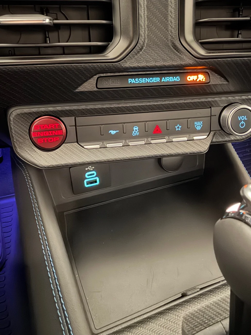

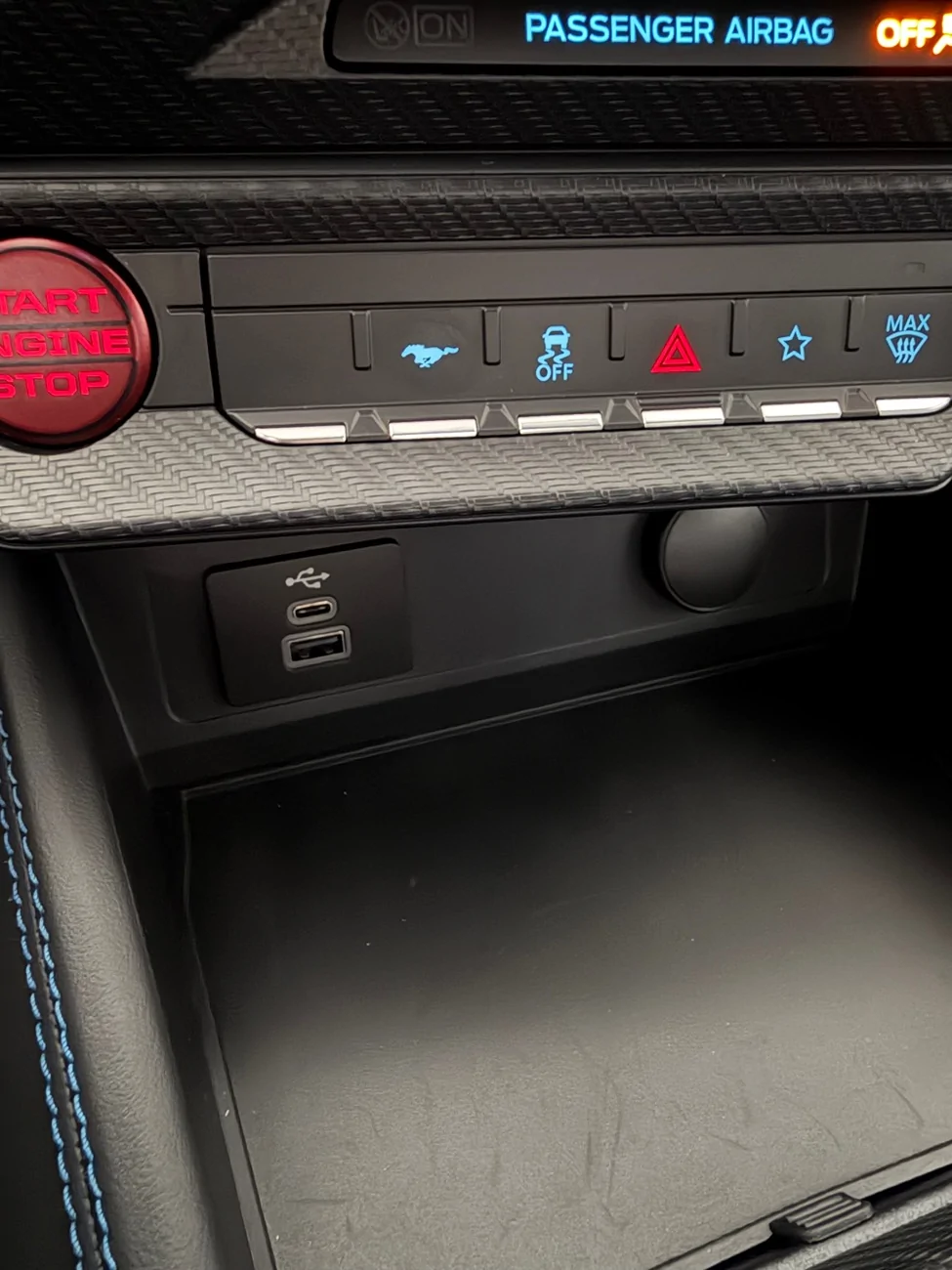

Like the message says, center screen refuses to turn on. Battery is showing 12.5v on accessory and 13.5v on the alternator. Seems normal for a 12v right? I’ve done the seek right + power for 10 sec and seek right + volume down for 10 sec. Both don’t work. The dark horse entry animation won’t play on the center and weirdly enough the USB-C and A ports are flickering. Anyone had this before? Any fixes before I take it in for Ford to look at?
Try disconnect to reboot ? As in disconnect the negative battery cable for 5+ mins.

Just gave it a shot, still won’t turn on. Maybe a display issue? Bc it seems as though the radio responds to input commands. It’s skipping, pausing, and playing audio right now, just no display.

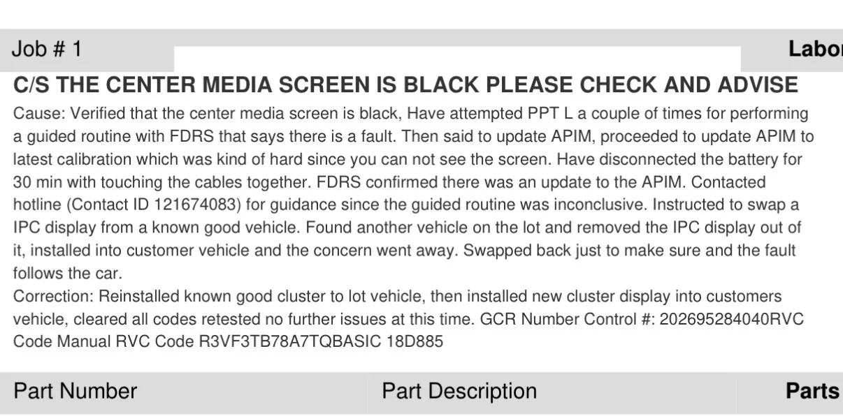

There was a recent over the air (OTA)update that was pretty large for an OTA on the APIM (which controls the center screen essentially). I’ve had a few customers have the same issue. You could manually download it onto a usb and download it yourself or if available Mobile Service. If you’d want to DM me your vin I can check and confirm if you’d like.

I took my 2024 Mustang GT to the dealership on 2 different occasions for that issue and they are currently replacing the APIM. Hopefully I'll get my car back this week. 😩

I took mine in yesterday, they’re still working on it. They did an update and it still didn’t work. They said they’d call the Ford hotline to see if there’s a fix. 150 miles on it too. My 24 GT never had problems like this.
