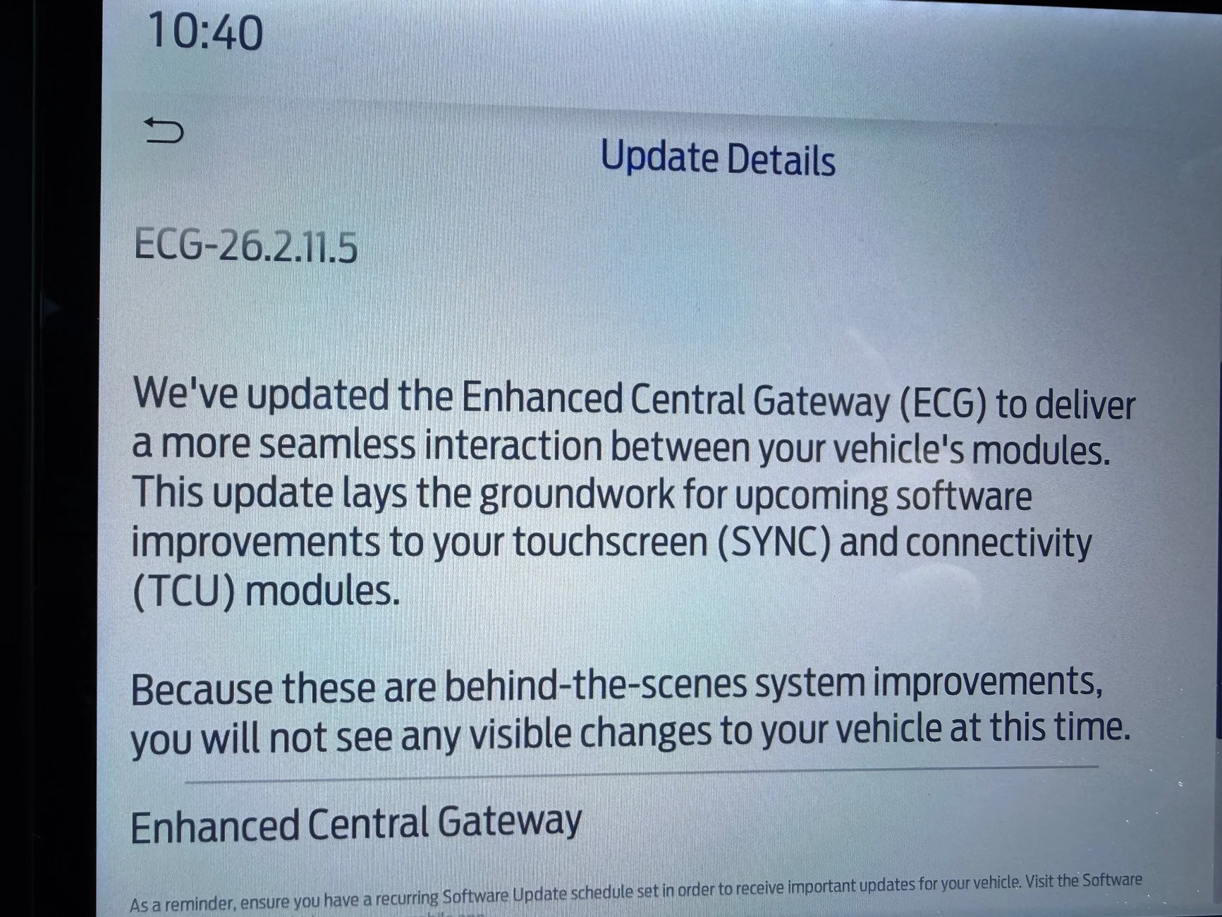

This just went though on my truck last night.
S650 Mustang 2025 Ecoboost electrical gremlins IMG_3805

it does that after an update.
