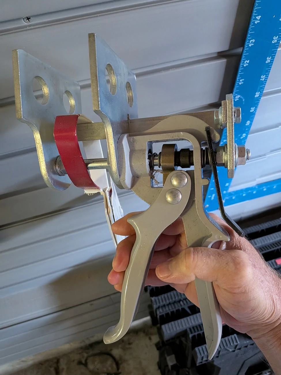

Can you post a picture of your pad spreading tool?
I am guilty of being in the screwdriver club. :facepalm:
Sorry for the late reply. Yes. The Lisle 29100. That's the one I have too.
That's pretty sweet! I used to have a pad spreader, but it appears that someone borrowed it and never returned it. That's why I hate loaning out tools.
I am a charter member of the long fat screwdriver club. 🪛
