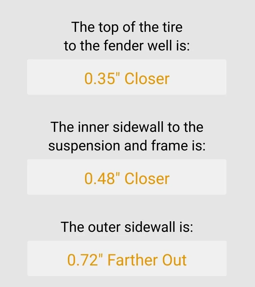

There's plenty of tools online to help you out when shopping, my go to is tiresize.com. there's no reason to not be informed these days before making a purchase. For example Nitto recommends an 11 width rim for their 305/30 or 305/35 for a 20" rim. While I don't know exact specs of the S650 pp wheels, I know the S550 pp1 wheels have an offset of 53mm. So our starting measure of tiresize.coms offset comparisons calculator would be 275/40/19 with a 53 offset. We also know the wheel from HRE has a 50mm offset so our new tire with the Nitto recommended 305/35/20 with offset of 50 will show us how much difference we can expect:
S650 Mustang Warning about HRE wheels and how they fit Screenshot_20240110_141531_Firefox

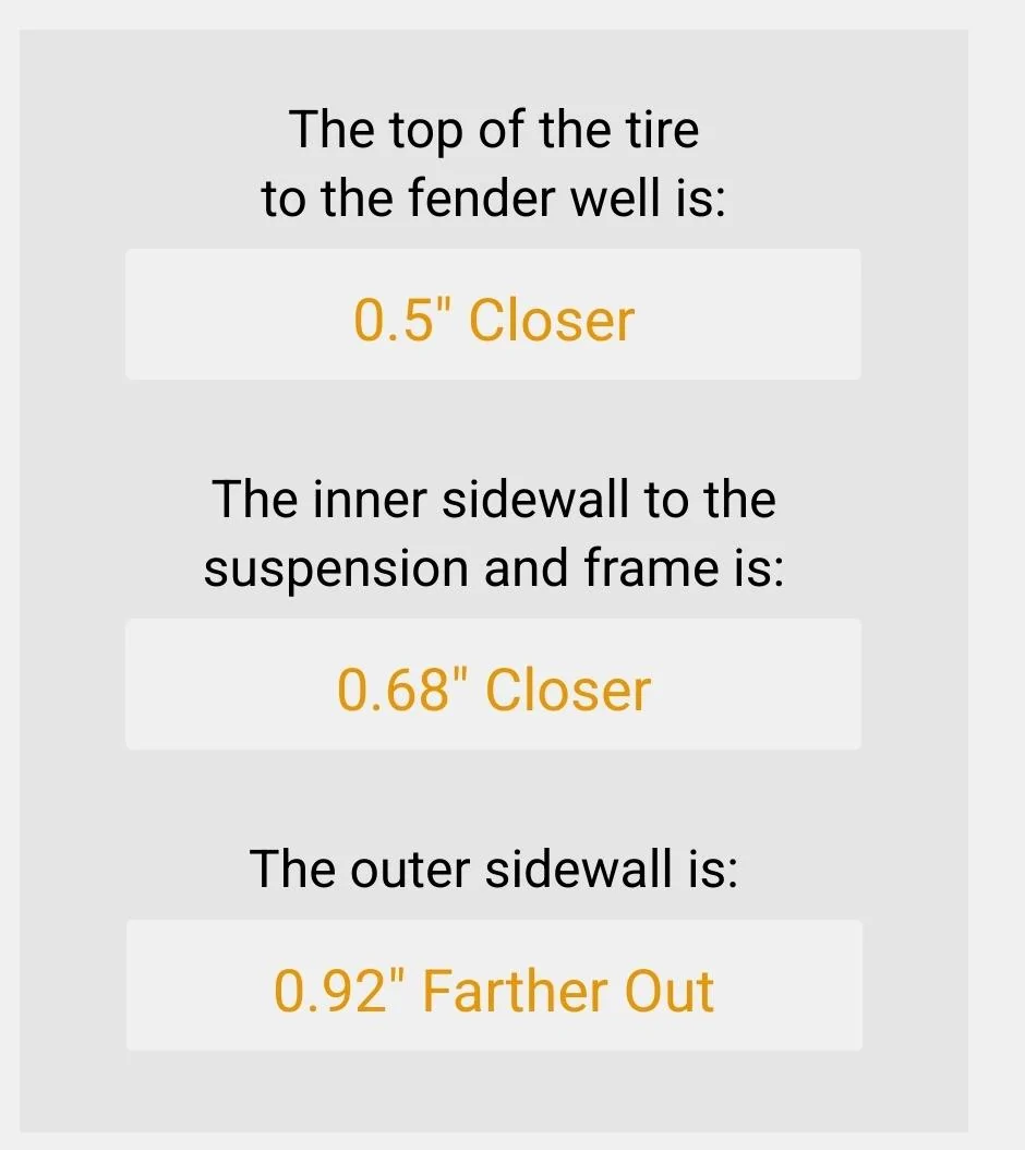

Now you know to expect your new setup to poke out .72" more than stock pp. OP went with 315/35/20 on 50mm offset which comes out to this:
S650 Mustang Warning about HRE wheels and how they fit Screenshot_20240110_141508_Firefox
A full 2/10s of an inch more than the 305. With this information you can plan out a lot of things before you even look at wheel designs.
