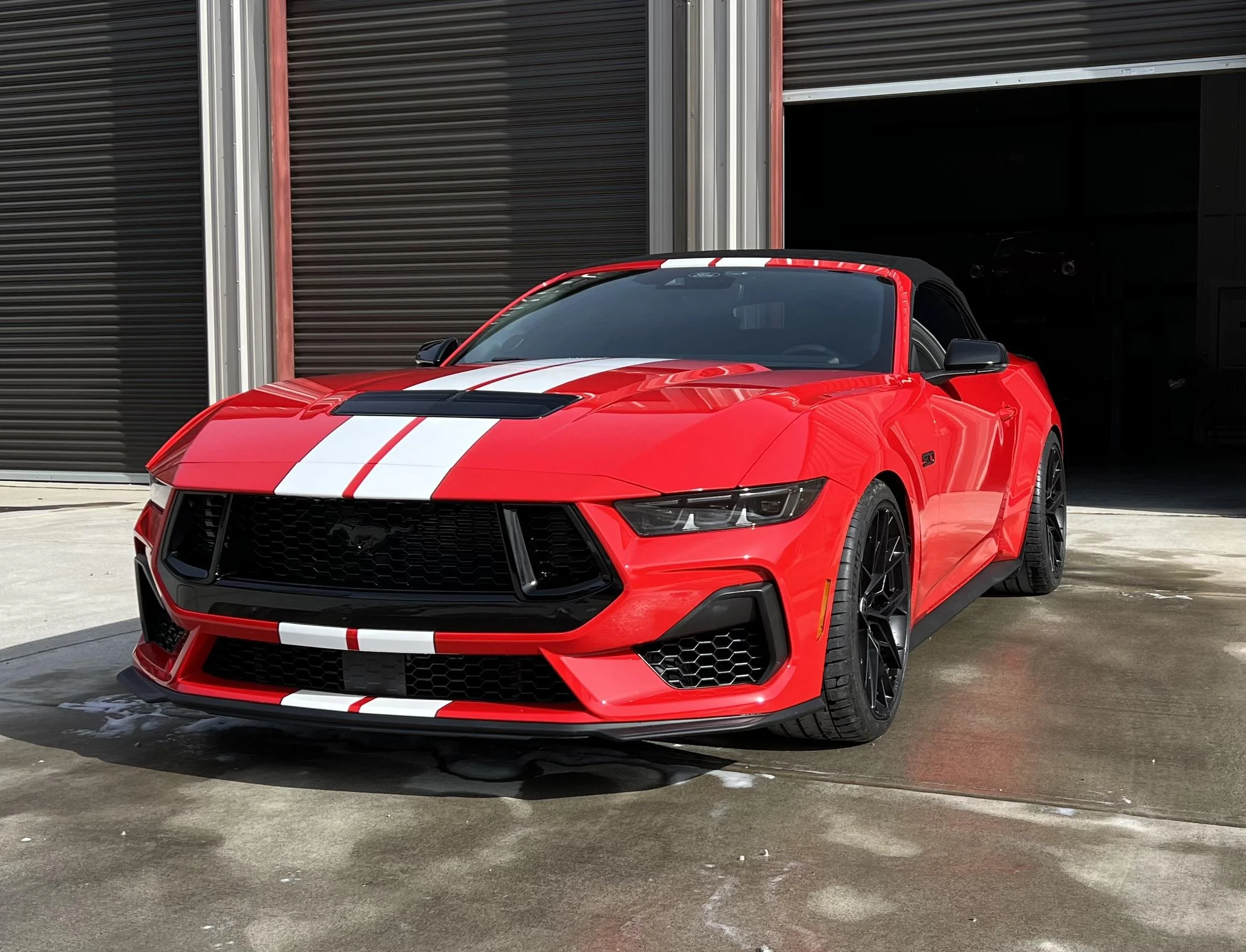

I want to let S650 owners about buying HRE wheels. I purchased a set of FF10’s from Vibe Motorsports. They offer a 20x10 ET35 and 20x11 ET50 setup for the new Mustang’s.
The offset for the front is fine with the factory alignment specs. The rear however are a problem for me. With the factory alignment, the wheels/tires stuck out beyond the fenders. With an alignment the wheels can be flush with the fender so they don’t rub, but the negative camber is pretty agreesive. I’m running -2.7 degrees.
I want to say that I realize many owners are fine with “poke”, but I’m not one of them. I also realize that there may be owners who don’t mind the leaned-in negative camber look. Again, I’m not one of those people. I like my wheels/tires to sit flush or a little tucked in and normal looking camber. If you’re an owner who is fit with the wheels sticking out or running a lot of negative camber, you’ll be happy with the way the HRE’s look. They are very well made. But if you’re like me and want a flush, factory look, you should do some deep thinking before pulling the trigger.
My car is a GT with the performance pack. The HRE 11” 50ET rear wheels stick out an extra 21mm from the stock PP 9.5” wide 52.5ET wheel. This seemed like it would be fine since many owners are running 20mm or even 25mm spacers, so I placed my order not really worrying about the fit. But on my car, the extra width stuck out of the fender by about an .65 inches with the stock alignment.
I’m running 315’s in the back. Vibe is telling me to run 305’s. That would be just .2” less on each side, so I don’t think that would matter.
By the way, Ford uses 11” wide wheels on the Dark Horse pp and the offset is 52.5ET. I believe that HRE should be making wheels in 52.5 to 53ET to make these wheel fit better. But HRE’s a big company and they don’t agree. They are using the S550 setup, but I think the S650 is just a tiny different.
Anyway, if you’re buying wheels, do your research. You might be happy with the poke or the tilted in alignment specs. I’m not a happy customer. But HRE and Vibe won’t do anything.

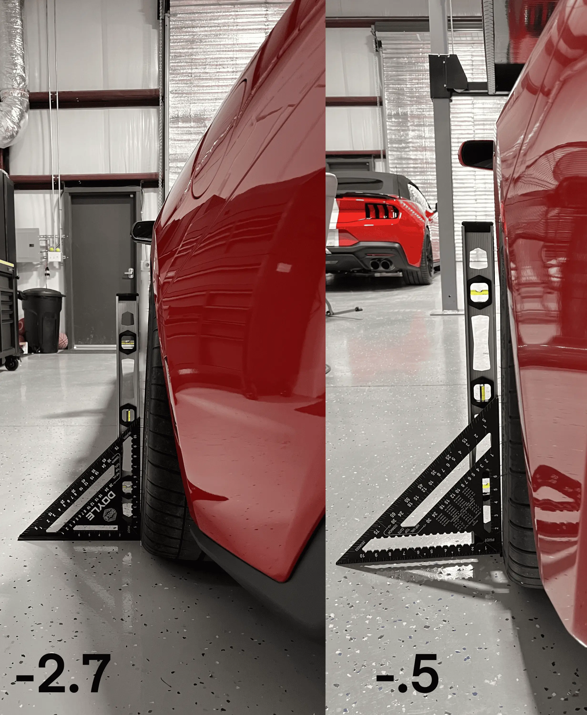

Here’s some pics for reference. The first picture is of my S650 with a straight edge to see the -2.7 camber. The car in the right is a corvette C7 with factory camber.

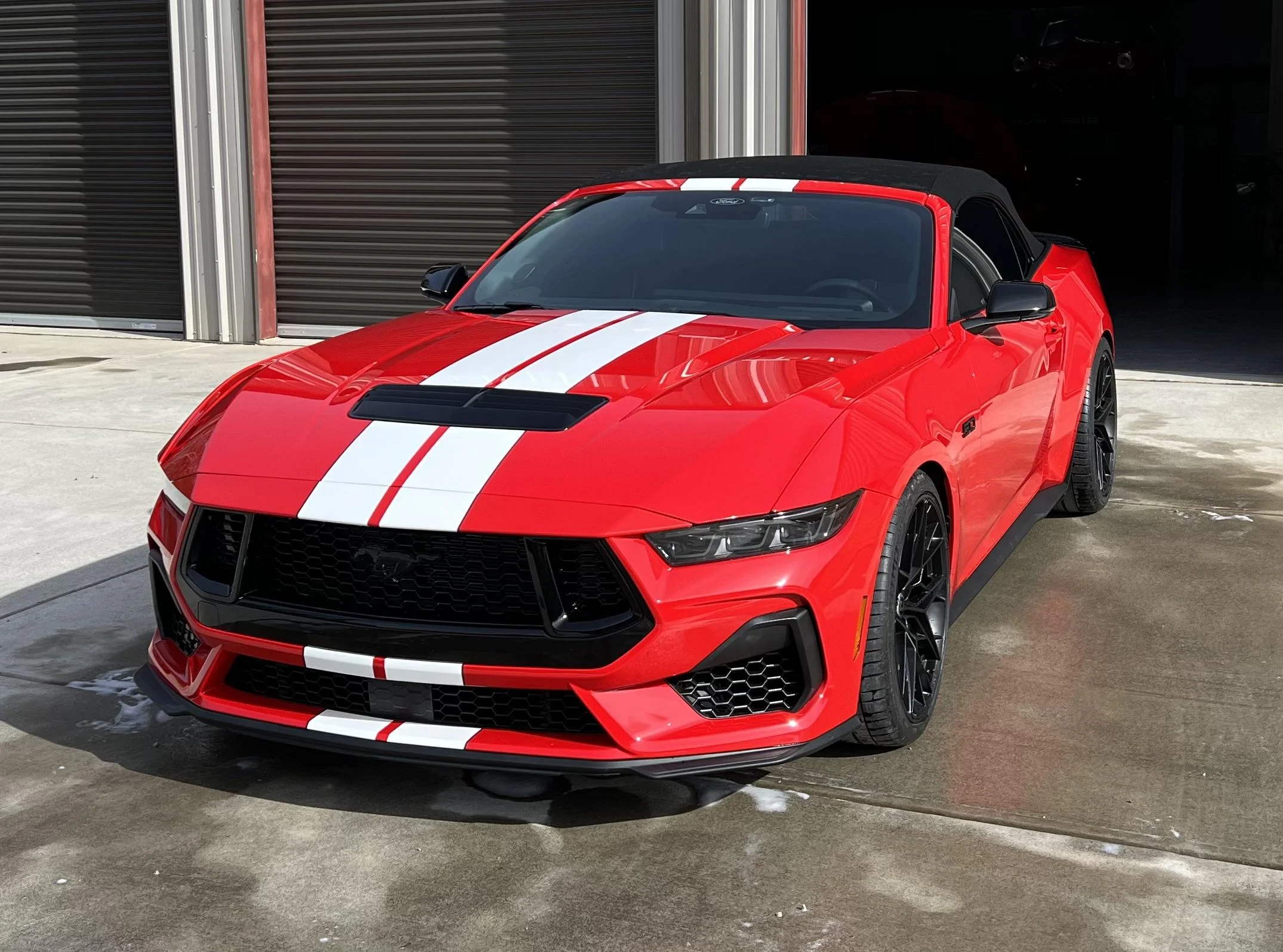

Here’s the side by side with my car and my corvette.

I’m running Steeda springs for the magnitude. It’s lowered about 0.8 inches. The front has camber plates, and the alignment in front is within factor specs. It’s -1.1 and in front, no rubbing.
The rear can be adjusted anywhere from positive 1 to negative 4.5. It should be set at about -1.2 to look right FOR ME. I had to go to -2.7 rear camber and I just hate the tilted in look.
There is no poke in the pictures I posted because I did the alignment. I’ve seen plenty of cars on this site with poke and I hate that look. But if you like that look, that’s all that matters. It’s just not for me.
I just wanted to warn those buying wheels to do your own research and use my experience with the HRE’s as a reference. It’s a big investment to end up with a look you hate.
