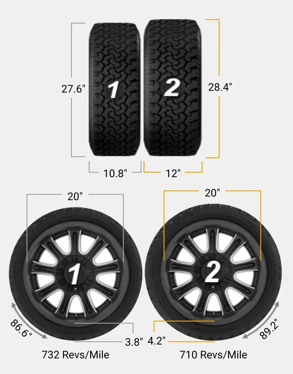

There's many reasons why people would run a smaller aspect ratio in the rear. One reason people will run a smaller aspect ratio is to keep the rear tire roughly the same size as the front tire. For example here is what your 275/35 305/35 will look like side by side
S650 Mustang Warning about HRE wheels and how they fit Screenshot_20240110_120757_Firefox
You'll be fine to run similar ratios. The only tradeoff between the two is same size tires at the sacrifice of rear ride comfort due to a smaller, and by consequence, stiffer sidewall.

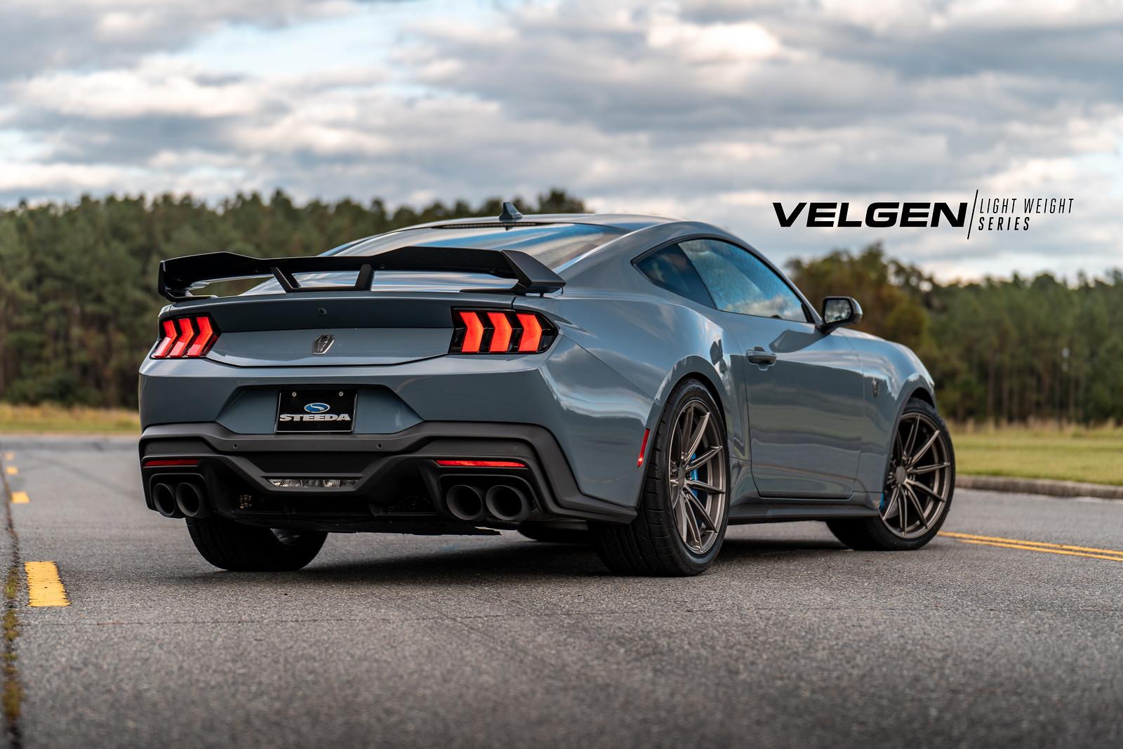

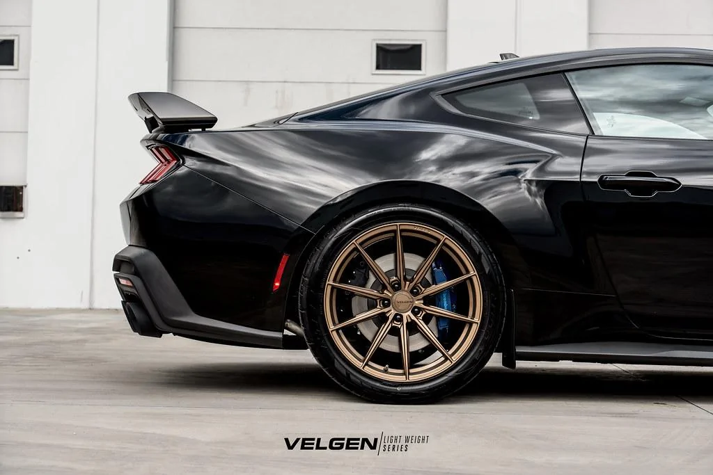

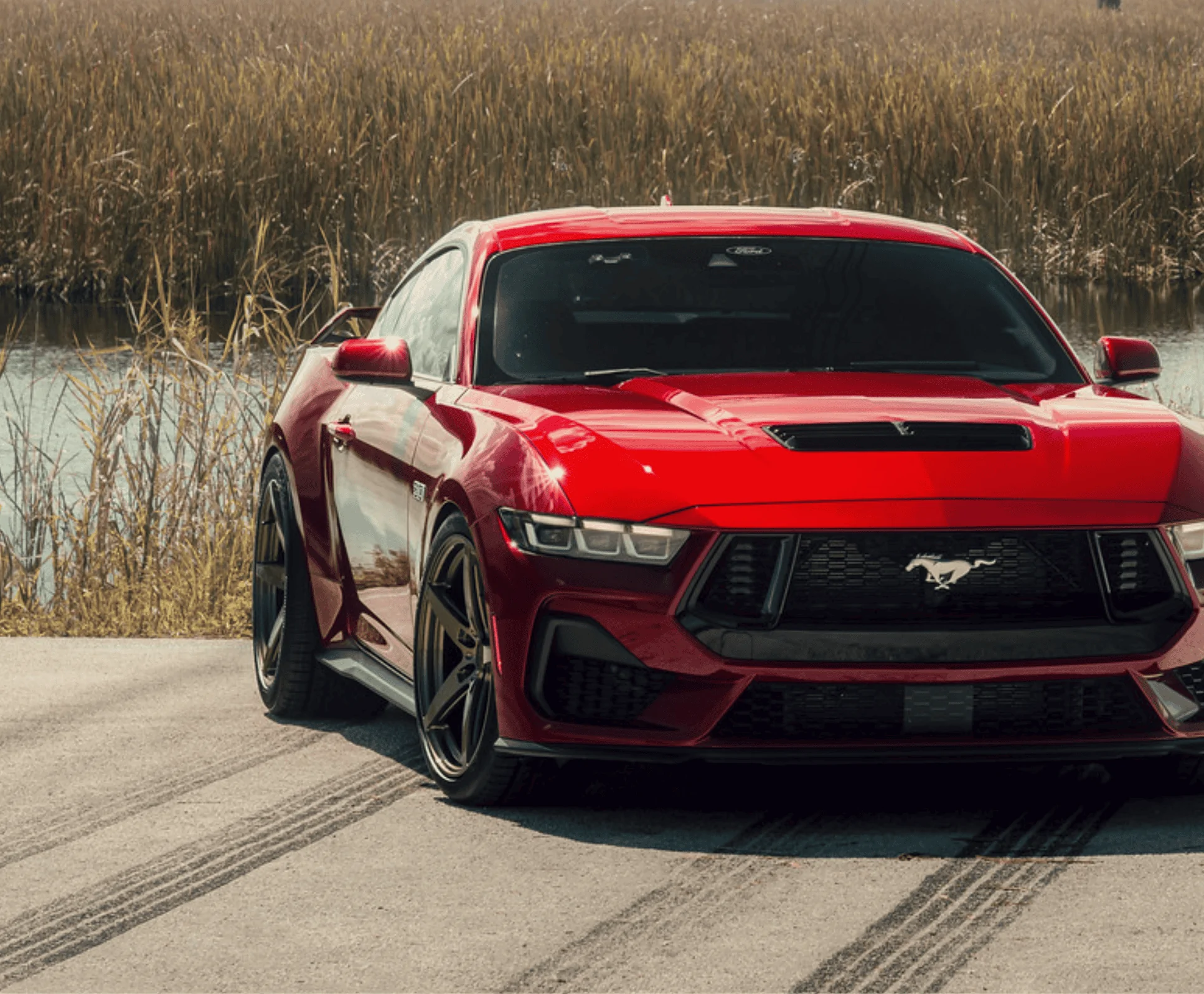

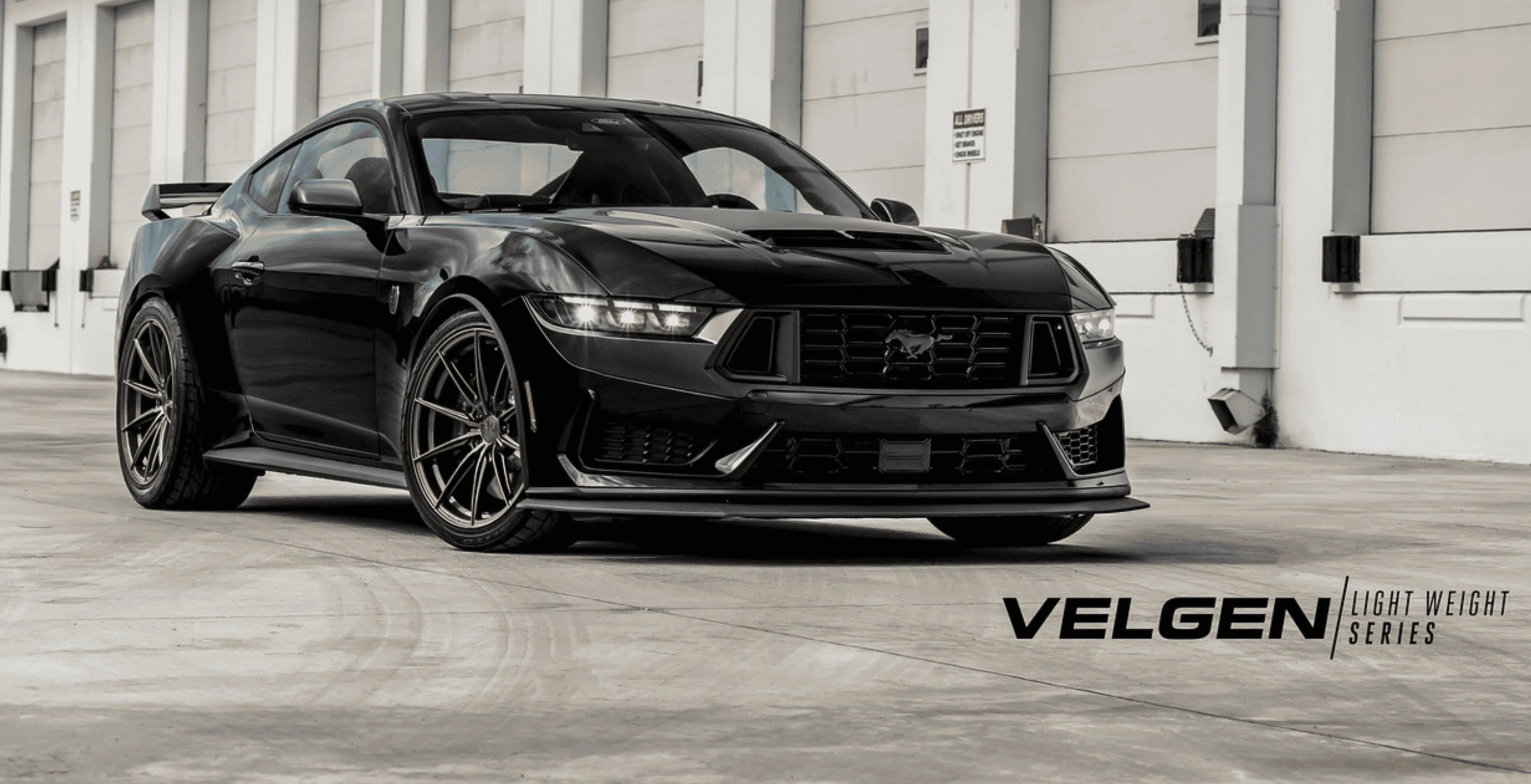

To the OP..... A 20x11 with a ET50 and running a 315-35-20 its tad aggressive for us. I would have told you to run a 305-35-20 to help with the tire fender fitment. Running a 20x11 et 50 with a 305 would have been perfect fitment I see in your post you stated that the Vendor suggested a 305 but you ran the 315, you really cant blame the vendor if they told you the right suggested tire. Iam also guessing you are adding the camber to push the wheel inside the fender to give you the fitment you want, but remember its the tow whats key on these cars. Sometime's it's good to contact the manufacture just to confirm fitment and tire questions, if not 100 % sure on tires. I have attached some images below on our fitment running 20x11 with 315-35-20 & 305-35-20

Running a 11" wheel has nothing to do with needing to run an excessive amount of camber. That IMO is a lot of camber even for a street set-up.
It is the Offset that is making him run that much camber.
I didn't really see him blaming anyone just give others a heads up!
Velgens fit perfect. They have lots of pictures showing this.
lol -2.5 isn’t excessive and he is blaming. Read his posts! He says 2mm of more offset would help which is laughable. His Offset has nothing to do with it. 50-52mm he wouldn’t even notice.
Great info, thank you! I think im going to go with 305/30r20's for the rears as i do want the tires to be relatively the same size. Plus giving the extra room should yield for a flush fit & alignment.

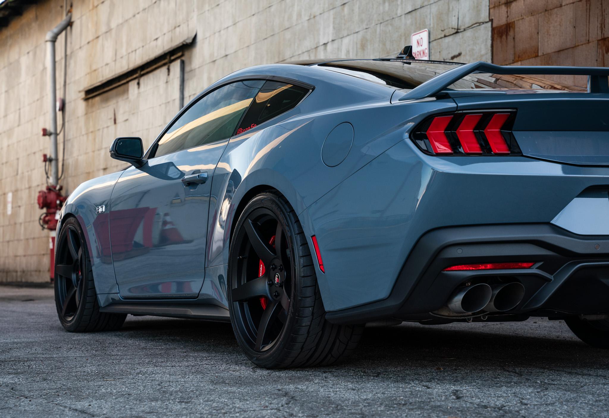

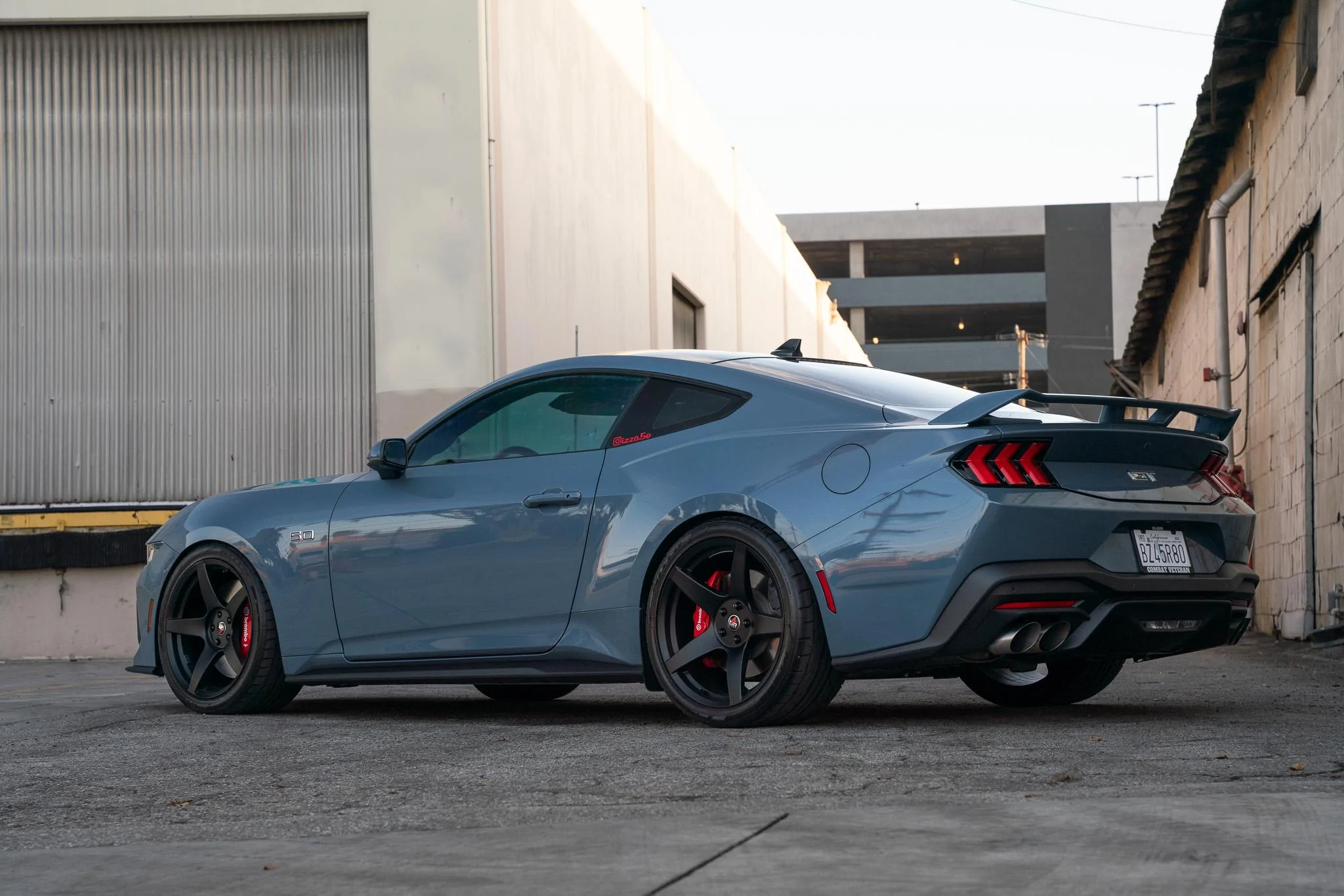

Here is our 20x11 with a 315/30/20 Let us know if you see any poke also lowered on steeda springs. Doesnt seem aggressive to us fitment looks perfect
