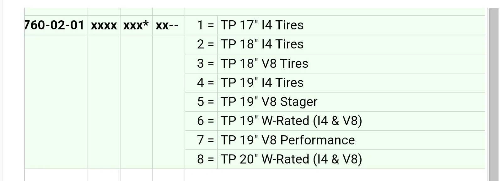

If you want to do it yourself you need Forscan, and know the setting to change for tire size. Unfortunately, I'm not 100% which line it is, so I can't help you there.
3,260
3,709
While I have done plenty of Forscan updates to my F150, I haven't attempted any on the Mustang yet. Therefore, I can only pass this along while saying I have not personally confirmed these with my vehicle:
Module: ABS
Address: 760-02-01
Second segment, fourth digit
S650 Mustang Changed tires and how to recalibrate speedo? Screenshot_20240413_080914_DuckDuckGo
Here's a link to the post with the spreadsheet:
https://www.mustang7g.com/forums/th...ist-database-spreadsheet-by-livinitup.159997/
