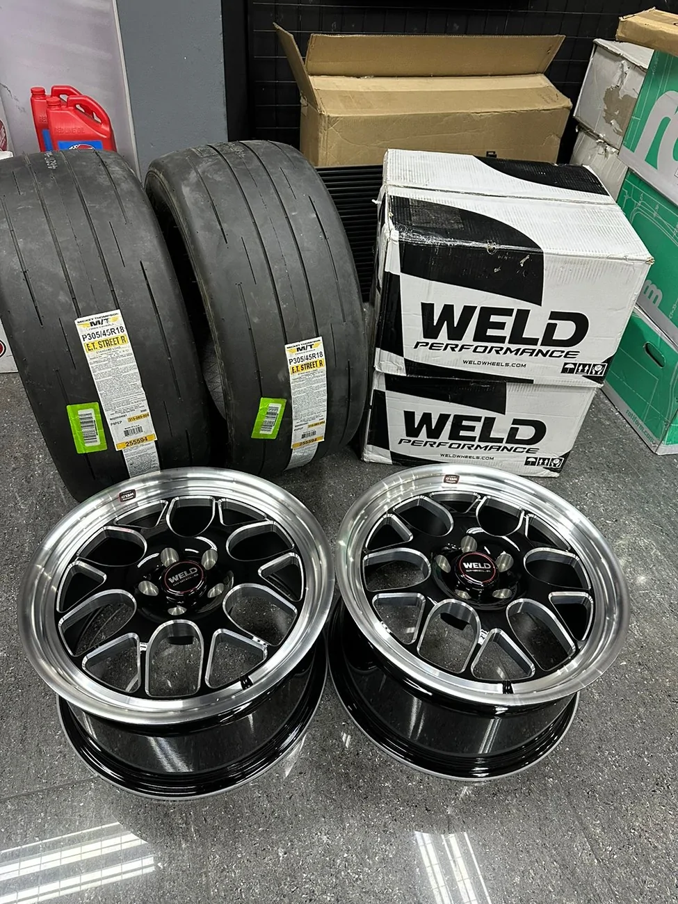

Here's the update: zero issues with this setup, everything works perfect. Even the speedo and shift points are fine after the Lund Tune!!!...
I’m about to get some solanas and 305/45’s myself just making sure, you’re on the progressive springs and tire only. There was no spring spacer or anything to make the tire fit right?

S650 Mustang Speedo and shift points adjustment 1000262967
18x10 ET45 Welds
305/45 R18 M/T Streer R
Steeda Progressive Springs
Steeda Stop the Hop
Perfect Fit... even under load
That's it... no spring spacers

Just the info I was looking for so they should fit perfect on mine too, thanks again
