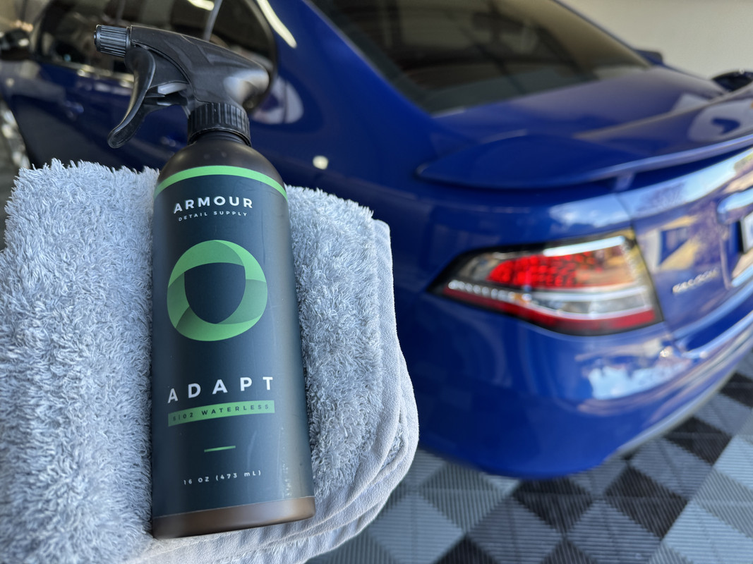

That's what I initially thought. Then one day my car detailer (who works for Ferrari) was doing my 488GTB and this is what he was using. The stuff is amazing. There is something in it that coats the dirt particles in a way they don't scratch the paint... at all. zero. And it puts a light coat of wax on the car at the same time. You can feel it. Just spray on, wipe off. Dirt goes to the rag (I use costco white terry cloth rags...). Will not scratch the paint even on a filthy car. I use it also on the headlights/tail lights, and even the black trim (splitter/diffuser/side skirts). No white residue either. Use it on the wheels (rims) too. I ran out and tried a couple of other brands that claim to do the same thing but they don't. This stuff is like magic. I rarely go to car washes any more because of this. You will love it
Thanks for getting back to me, I'll give it a shot. Take Care.
