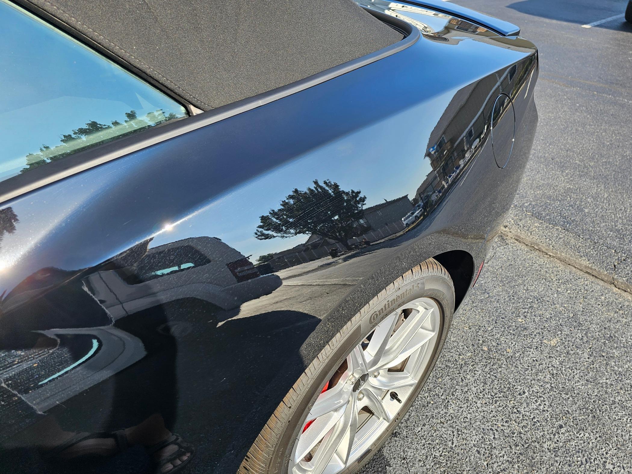

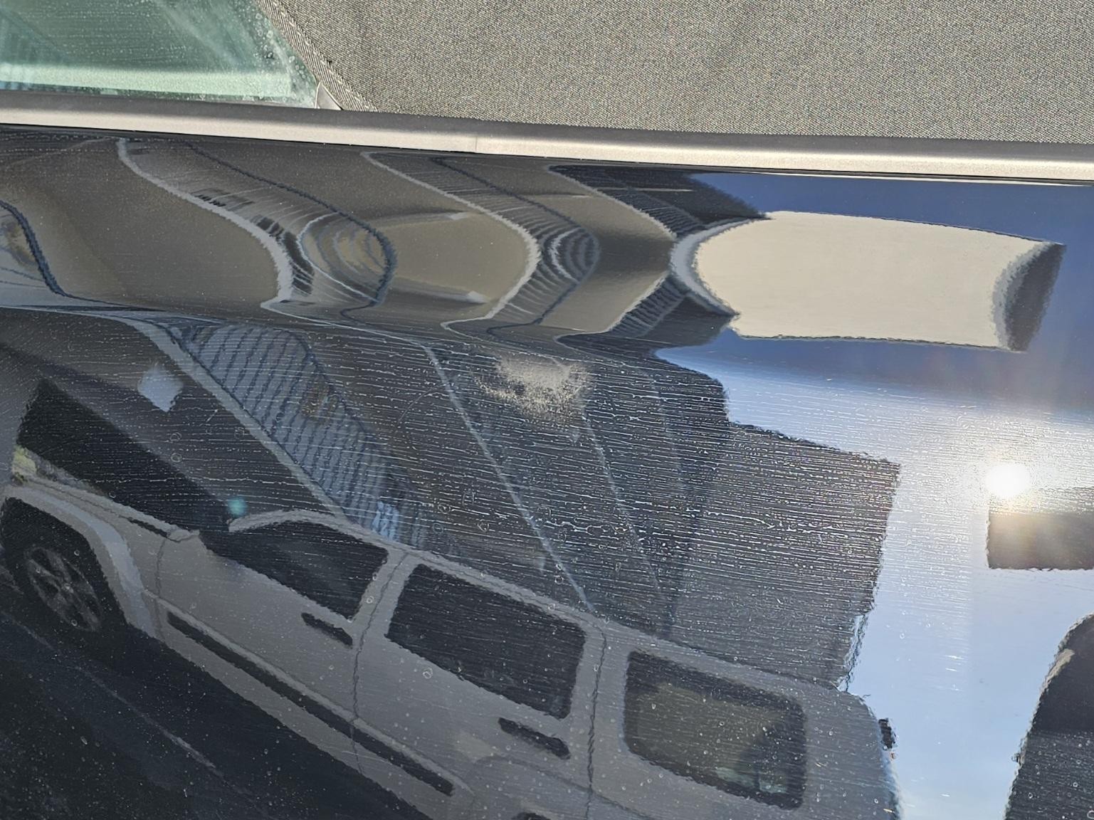

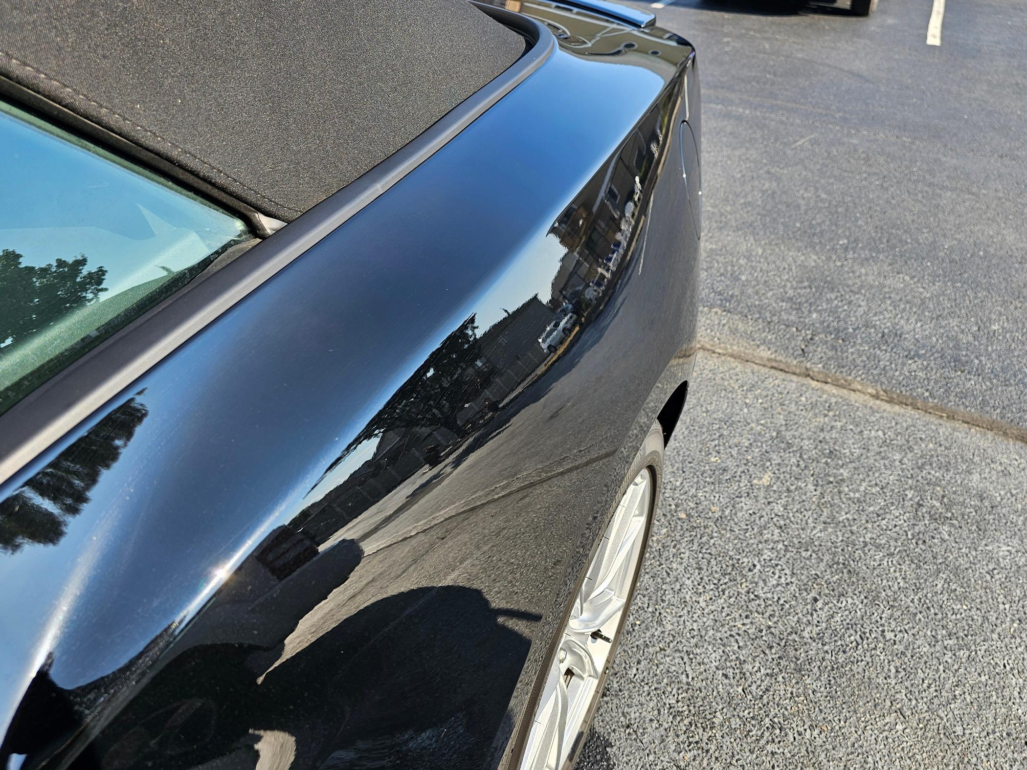

Well step 1 in my process produced zero results. I washed the car and really scrubbed the spot with soapy water repeatedly in the hopes if would gradually get clean. Didn't come off at all. I guess I will try the Dawn approach next. Some photos.
You can see how it stands out in certain angles, but is hardly visible at all in others. In the shade you really can't see it. But now that I know it's there it's going to drive me crazy until I get it off. Ughhh.
I swear I hesitate to take this car to the dealer for any reason due to this sort of thing. Keep in mind, the repair was to the trim piece on the OTHER side of the car.

T-Cut may be required. Suncream can leave a horrible dull patch like that and that can be seriously difficult to shift.
Definitely feels like something that's going to be a PITA to get off. My son, who details cars on the side, said a two step polish will get it off.
Another incredibly stupid question. Do I take it in and tell the dealer to make it right or am I just asking for more problems by doing that?
