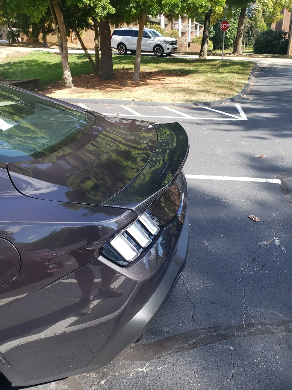

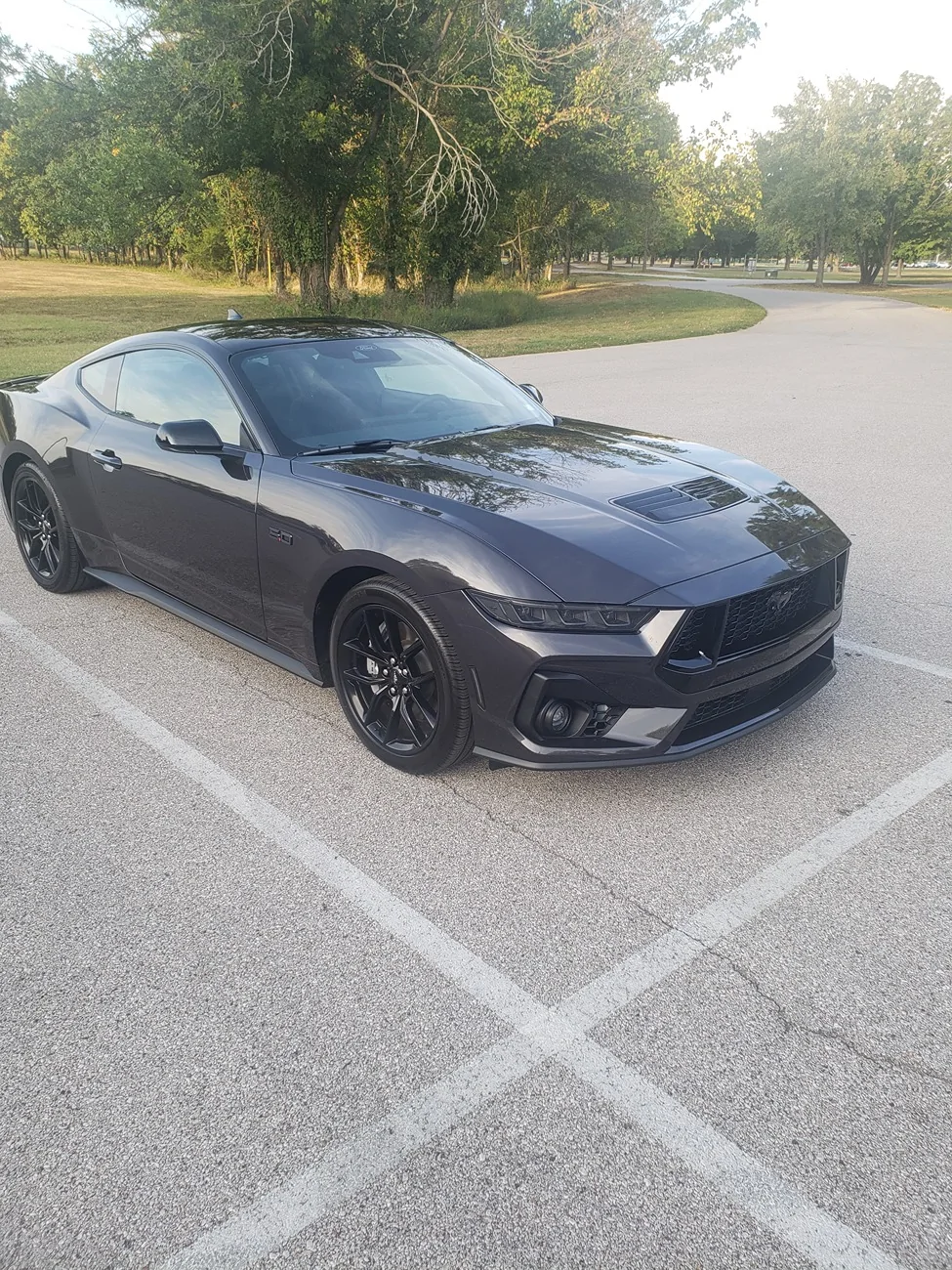

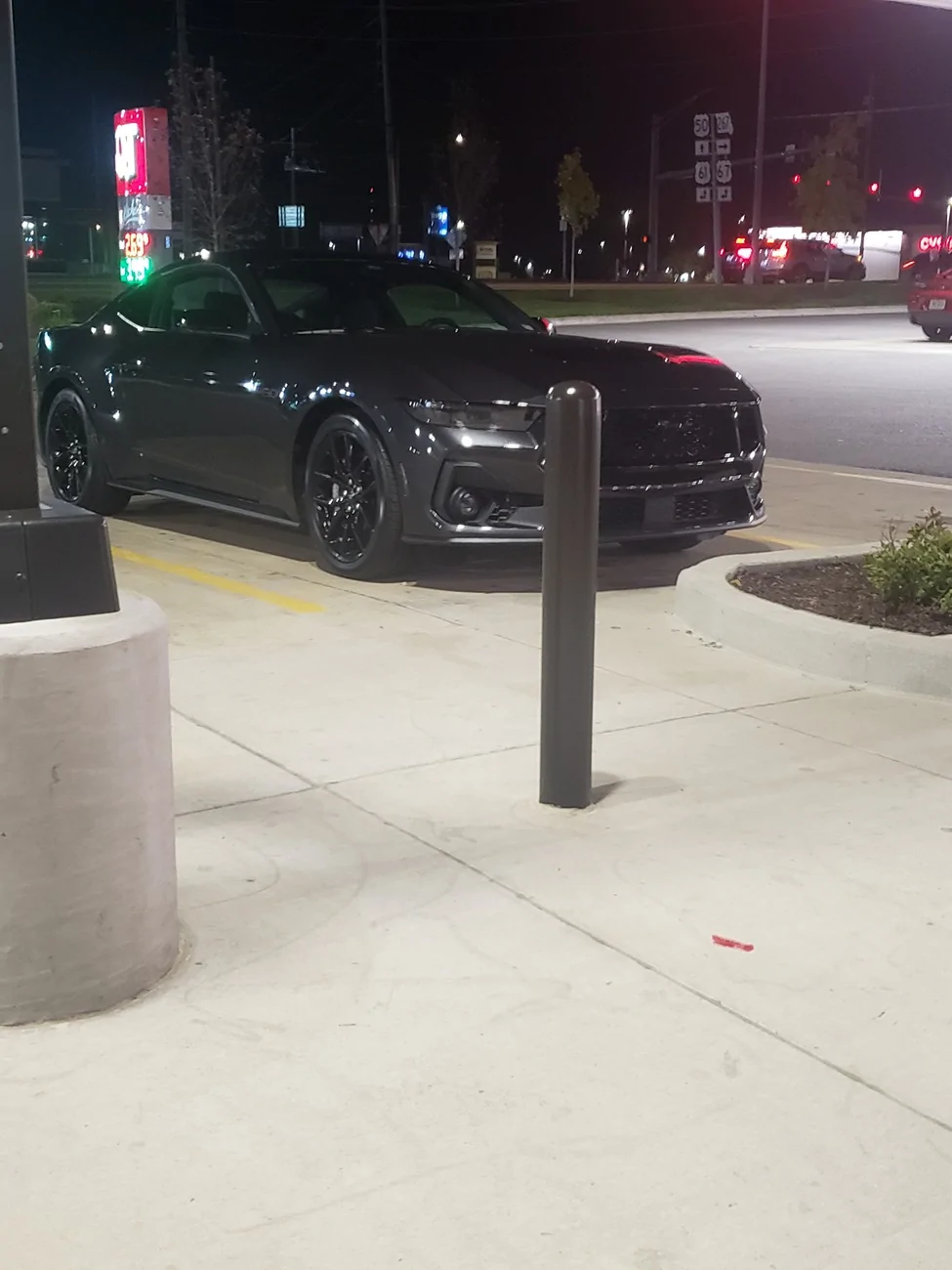

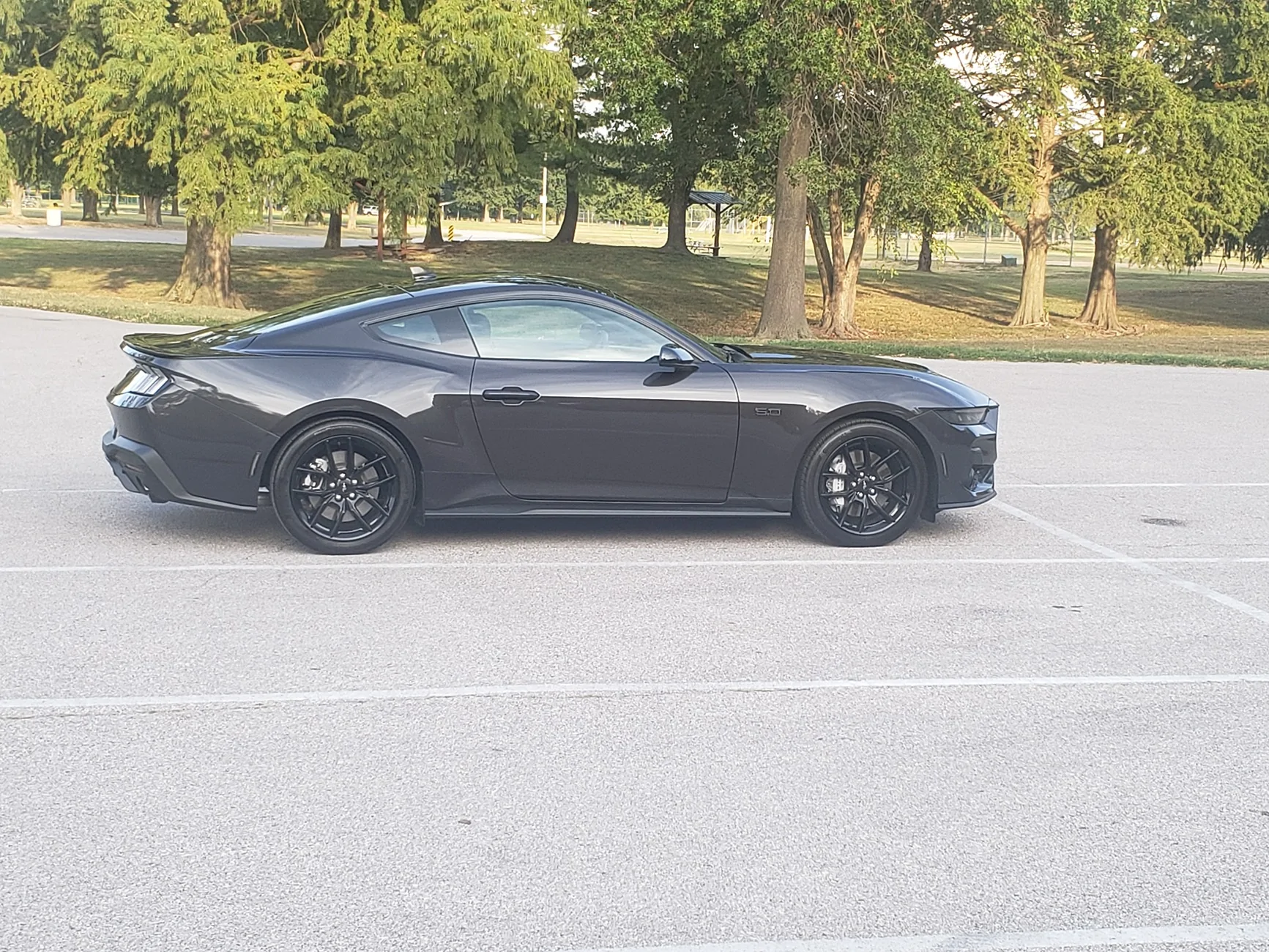

Hey community looking for some advice. I bought a used mustang back in April and it was a showroom car so kept very well and clean. For me, it's my daily driver and not kept in a garage. I noticed I've been getting swirls, I'm assuming from the automatic car wash I take it too (yea I know didn't research before hand) and recently got a quote from a detailing company that recommended a 2 step paint correction for around $1,100. I'm wondering how this will hold up with a car kept as a daily driver, I won't take it to the automatic car wash any more either wash it by hand at a station or go to the touchless car wash. Any tips or advice would be greatly appreciated. Here are some pictures of the car, you cant see the swirls unless its sunny out excluding the nite pony black top of the car but it drives me nuts.
Thank you
MM

Shop around. I had a very good shop detail mine and put a ceramic coating with a 5+ year warranty for under $1000. The hardest thing is to find a shop that deserves a good reputation. I would check who is recommended by your area Mustang clubs, especially MCA associated ones. If the best shop has a lot of detailers, see if you can find who is the best. Often, a recommendation for those shops, will come with “and make sure X or Y does your car”. And check the results in various different lights. You would be amazed at how things will look different in daylight ar different times.

Unfortunately, its just part of the deal with black or dark coloured cars. However, no matter the colour, even with careful washing technique you do risk causing swirls each and every time the car is touched (washed). The key is to minimise it where possible -
- Use high quality soaps
- Use the two-bucket method, or as I do, the one bucket and foam cannon method
- Use a blower to remove the bulk of water after the wash
- Use high quality towels
- Have the car waxed/coated to help reject dirt/dust/bugs/road film
As for the $1100 price, I would assume that includes a ceramic coating as well? Just remember it takes many, many hours to do a two-step paint correction. Frankly, if you are going to use drive-through car washes, you are wasting your money in my opinion. Also be mindful that "touchless" car washes use heavy duty chemicals to do the job, which will speed up the decline of the rubber and black plastic trims.
