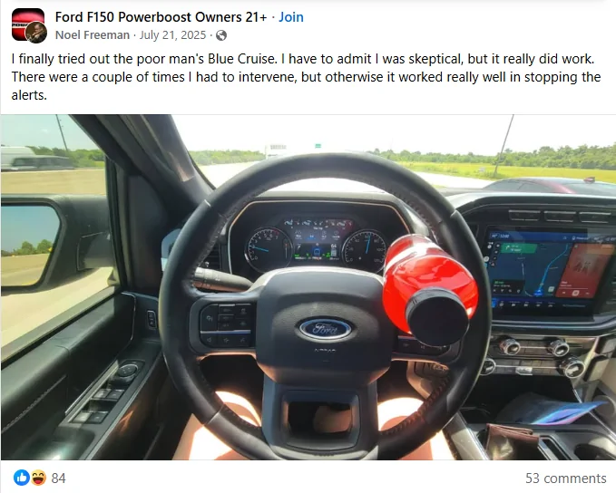

Ford's version is Bluecruise. From what I hear, GM's Supercruise is better. The F150, Lightning, Mach E, newer Explorers, certain trims of the Expo and certain Lincoln products have it available as an option.
On vehicles with full lane centering, lane keep assist and adaptive cruise, people put a weight on the steering wheel to simulate having your hands on the wheel to get it to work on non-BC equipped vehicles.
S650 Mustang How in the heck do you turn on steering assist on 2024 GT Premium? 1780007397766-1v
Apparently, a full bottle of Gatorade works. 🤣
