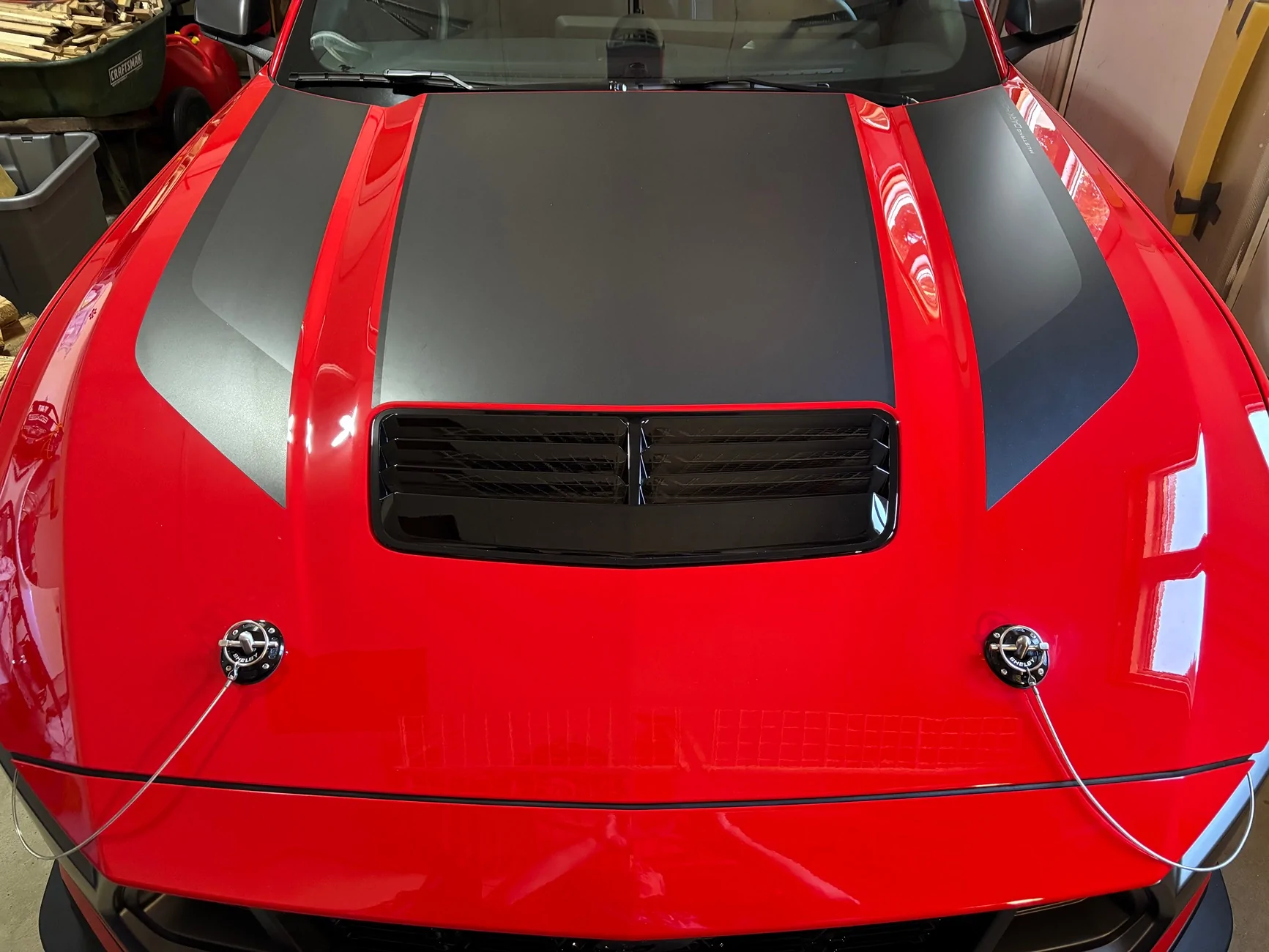

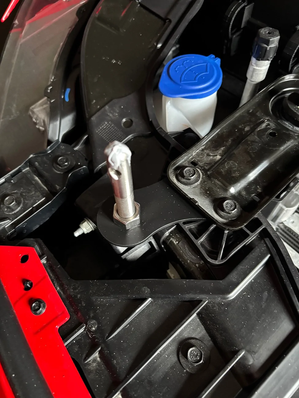

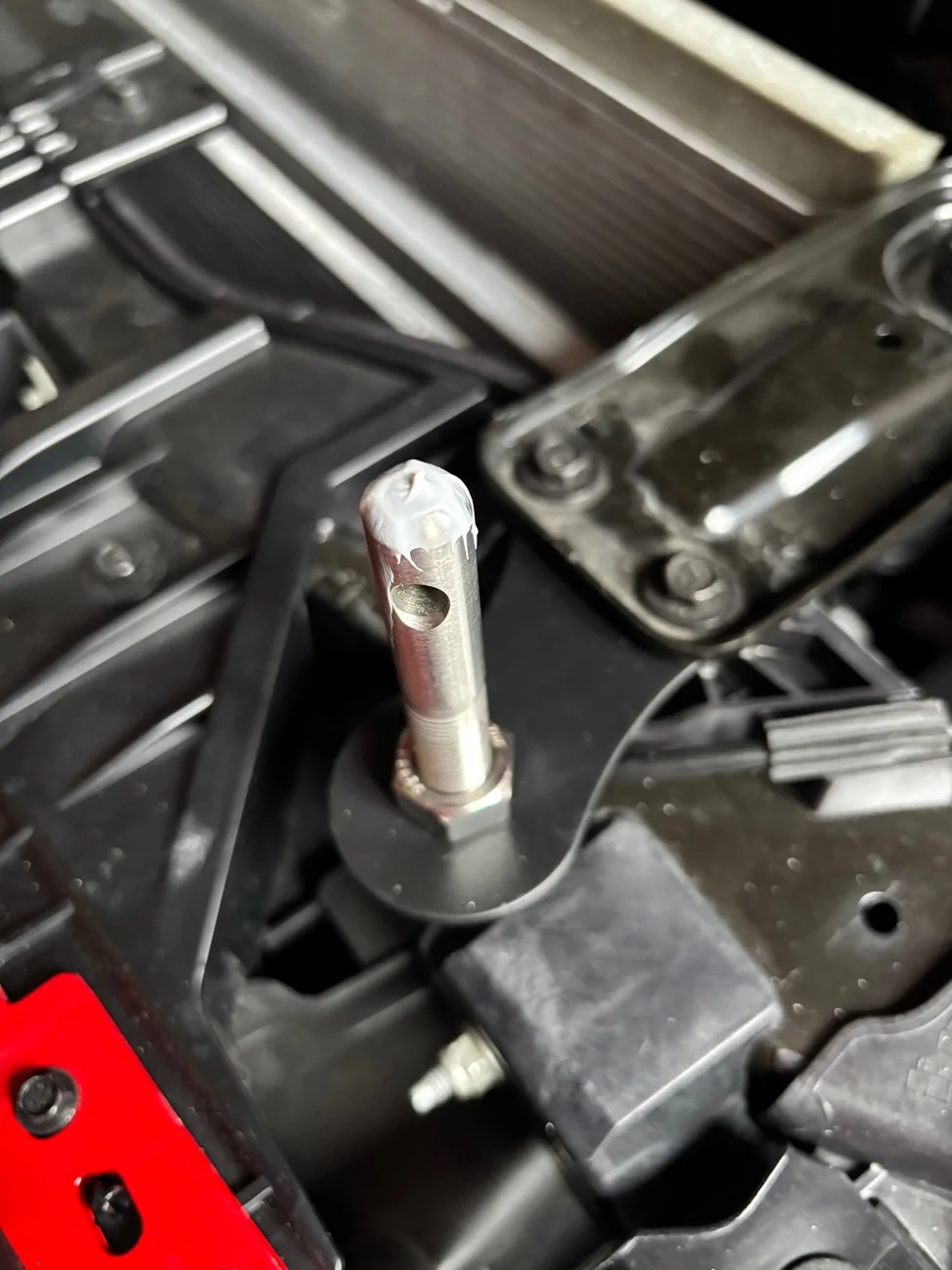

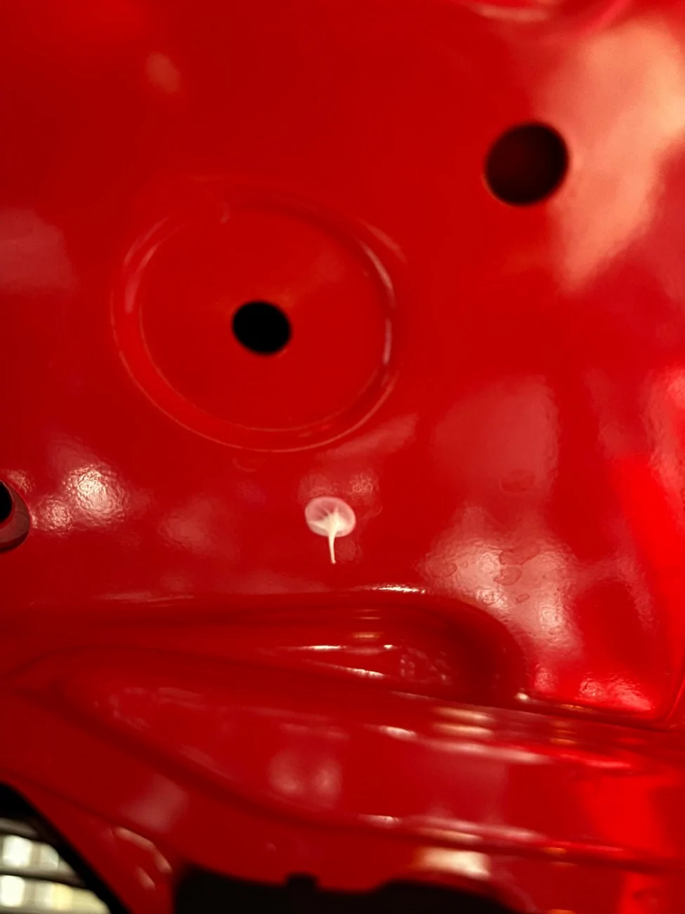

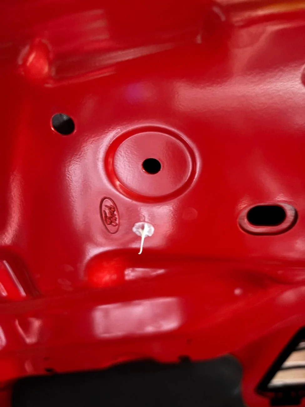

I bought these, https://www.cjponyparts.com/shelby-black-billet-hood-pin-kit-2005-2009/p/HDPK7/
The installation was pretty straightforward, however I'm a licensed autobody repairman and I've done this before. Even though it technically isn't for a 2024 S650 the install was the same, you just need to pick a location for the brackets and use a marker like toothpaste on the top of the installed pins to mark the drill holes at the bottom of the aluminum hood.
Pictures in a bit...
Aren't those cables going to slap around and scratch the paint?

Nope, so far nothing hurting the paint.. I don't know why everyone asks this... I had them stock on a 73 Road Runner and never an issue with paint in the 8 years I had it...
I had them on my 89 IROC for years with zero paint issues, too.

Very nice. I like it. Thanks.
I had the same question about the wires flapping in the wind & scratching the paint. But, it sounds like you have the experience to show that they don’t. Still, it just looks like that would be a possibility. What do you think about using the pins with the wires removed? Or, do you have any thoughts on the wireless, “screw down” type?
