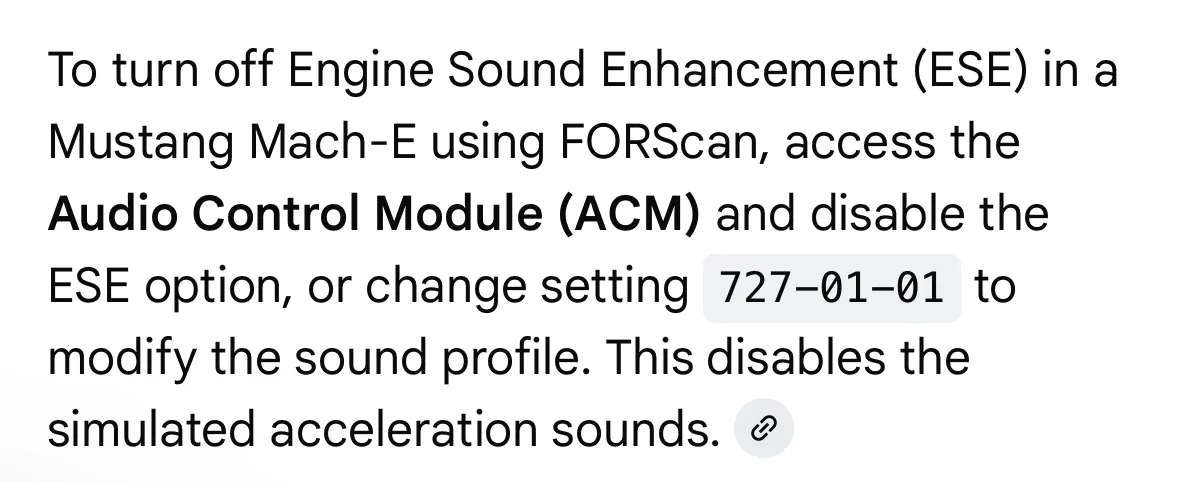

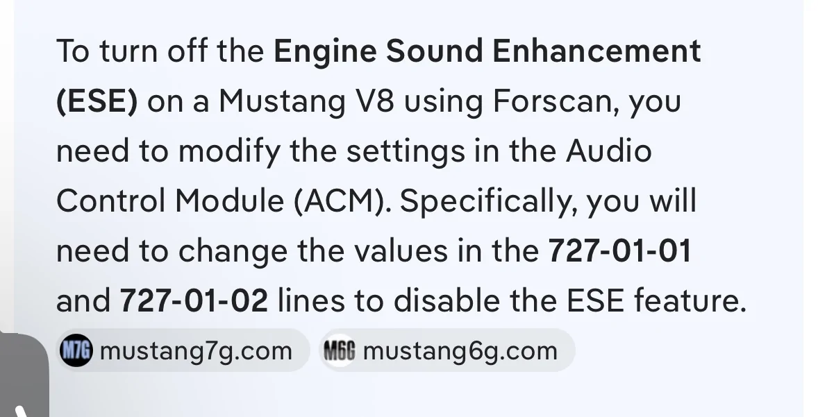

Does this indicate it’s the same as the mach-e?

Hmmmm, appears I need to look in to this a little more. Wasn't aware of the 727-01-02 line. Thanks for posting.
My build currently shows:
727-01-01 xxxx xxxx 1xxx
727-01-02 xxxx xxxx 0xxx

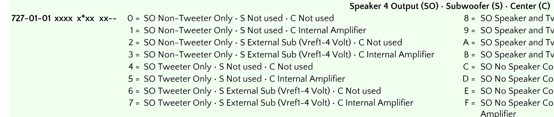

Interested in knowing why @exm changed the other value, too.
That digit he changed controls the speaker setup as follows:
S650 Mustang Has the GT also fake exhaust sound? Screenshot_2026-05-13-21-26-32-12_e5d3893ac03954c6bb675ef2555b879
So I would recommend: leave it as is.
